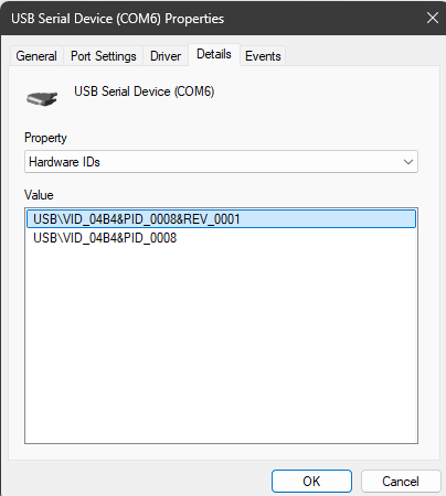

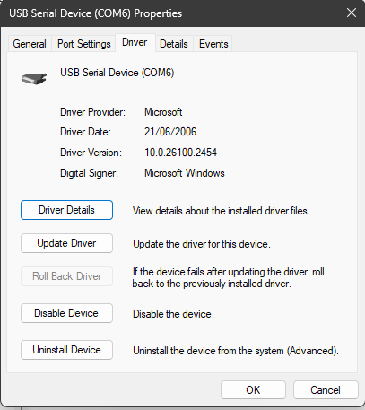

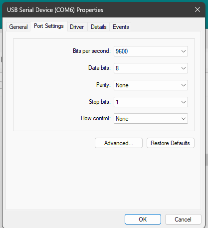

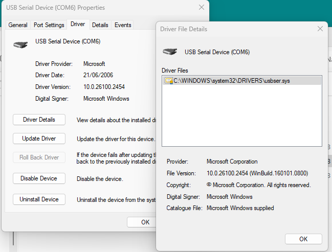

My Win 11 24H2 Build 26100:3476. is an upgrade from Win 10 that had
NanoVNA4 V2 Plus4 working with both Windows applications.
IIRC I did not (need to) install any specific `driver` for the NanoVNA on
first deployment (a year or 3 ago).
Following your posting, this is the first time I've attached the VNA to
this box since the U/G to Win 11 (I tend to use a Linux L/Top for this sort
of work.)
The VNA comes up on COM6 in Device Manager
HTH - if you need any more details of Properties (as above) just PM me.
