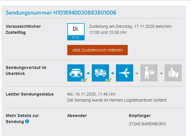

Siegfried Jackstien 2020/11/16 18:12
i converted my saa2n to plus ... happy with that but tomorrow i will get
a brand new v2plus4 :-)
18 more hours to wait ... ... ... ... ... and wait ... ... ... and
greetz sigi sg9bfc

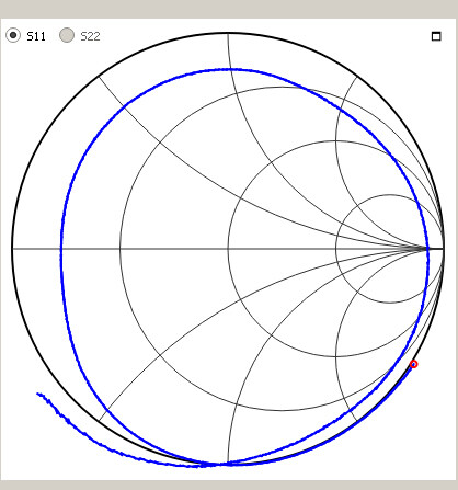

Siegfried Jackstien 2020/11/17 00:43

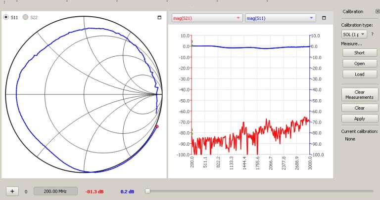

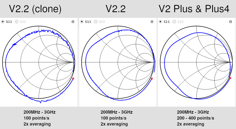

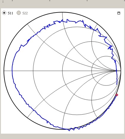

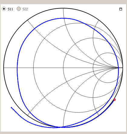

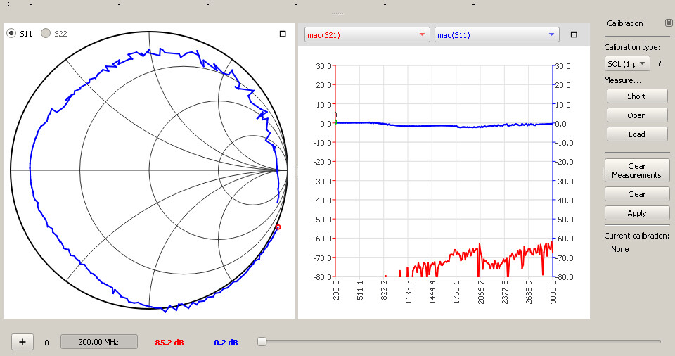

on my unit i now added 470 on 3v3 rail and 1470 on the 5v rail ... not
the smith is cristal clear :-)
the clones (especially with a big lcd) draw a bit high current on the
3v3 rail (that rail also powers other units that are used for measure)
see v2 without screen and compare it with screen (second and third picture)
if you do not buy a "geniune" v2 (now sold out) and do not get the new
v2plus or v2plus4 ... then definitely you will get a clone
not all of them are noisy ... my v2went noisy after upgrading to a
bigger lcd (see above the current issue)
with a few caps added it is much cleaner ... as next stage i try to add
a resistor in the 3v3 rail towards lcd (and a cap ... forming an rc filter
now i only added a cap in parallel on the 3v3 rail ... but will make a
"cut" with a sharpie and solder a small resistor over it
then i will see if that further lowers the noise a bit :-)
so .. how do you know?? (you get what you pay for ... buyers beware ...
get a genuine unit to be safe) ... best one now is v2plus4 for sure
does it matter?? see above pictures ... IT DOES MATTER!! (but if you
have no fear of modding your unit a bit it can be made much cleaner!!)
i think that should answer your questions (and maybe adds some new)
ps finally see how clean my modded saa2nplus (with extra caps on 3v3 and
5v) looks withoiut avg used ;-)
Am 16.11.2020 um 23:26 schrieb Allasso:
Siegfried Jackstien 2020/11/17 00:57

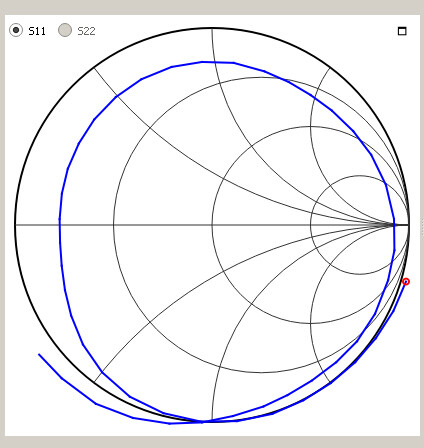

with 1000 pt it gets a bit scratchy but that is totally gone with 5 pt avg
and that tiny bit that i see on a 1000pt scan and no avg is what i want
to get away with next modding stage (series resitor on 3v3 rail towards
lcd and a bigger cap forming an rc filter) ... i keep you informed
ps is that splitting hairs?? maybe :-)

Allasso 2020/11/17 06:45
Thanks Sigi, yes that helps a lot. In the last attachment, the filename
says, "with_caps", are you referring to the 470 on 3v3 rail and 1470 on the
5v rail?

"with 1000 pt it gets a bit scratchy but that is totally gone with 5 pt avg"
Would that not produce similar results to using 200 pt with no averaging?
Or am I just naive?

Siegfried Jackstien 2020/11/17 18:19
Am 17.11.2020 um 13:45 schrieb Allasso:
> 5v rail?
yes ... but i am not finished in fiddling with moddings :-)
(try an additional rc filter)

no
it is then 5000 points when i use 5 pt avg and 1000 pts
each fifth point it steps one frequency step further means each point is
measured 5 times
200pt and no avg show coarser steps (yes that also then looks clean like
above but you have not the granularity)
ps wait till i get it noise free with 10 k points hi hi
Am 17.11.2020 um 14:44 schrieb Allasso:
Allasso 2020/11/17 14:57
"it is then 5000 points...each fifth point it steps one frequency step
further means each point is measured 5 times"
I think it is misleading to state it that way. Each point is only measured
once, however, it is correct to state that each point is used in
calculating the average 5 times, ie, for 5 different frequency steps
(including its own) as the 5 step window slides from one step to the next.
The reason I was comparing it to 200 steps/no averaging is that it seems to
me that when you're averaging over 5 steps you are also "smoothing things
out" over a pretty wide range, so the unique values at these "higher
resolution" steps have become less distinctive (as they are blended in with
4 other measurements), resulting in less effectual resolution. Thus I was
thinking that the end result might be similar to 200 steps/no averaging
(1000 / 5), **with interpolation between each step**. I do see however
that the advantage to higher resolution + averaging is that it would tend
to compensate better for noise, as the effect of random anomalous values
will be diminished when averaging with other hopefully more indicative
values, whereas with 200 steps/no averaging any random anomalous value due
to noise **is** the data.
