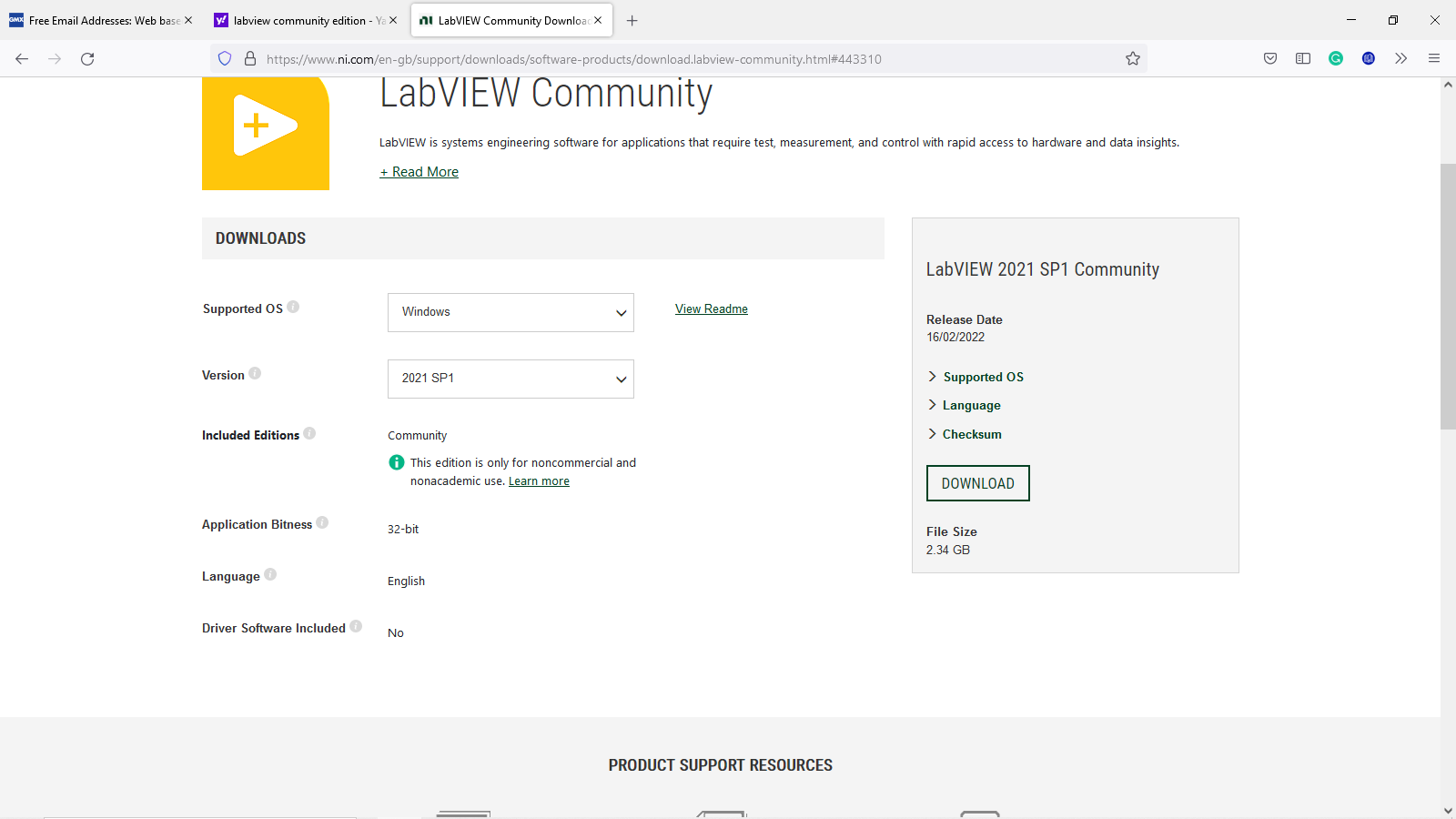

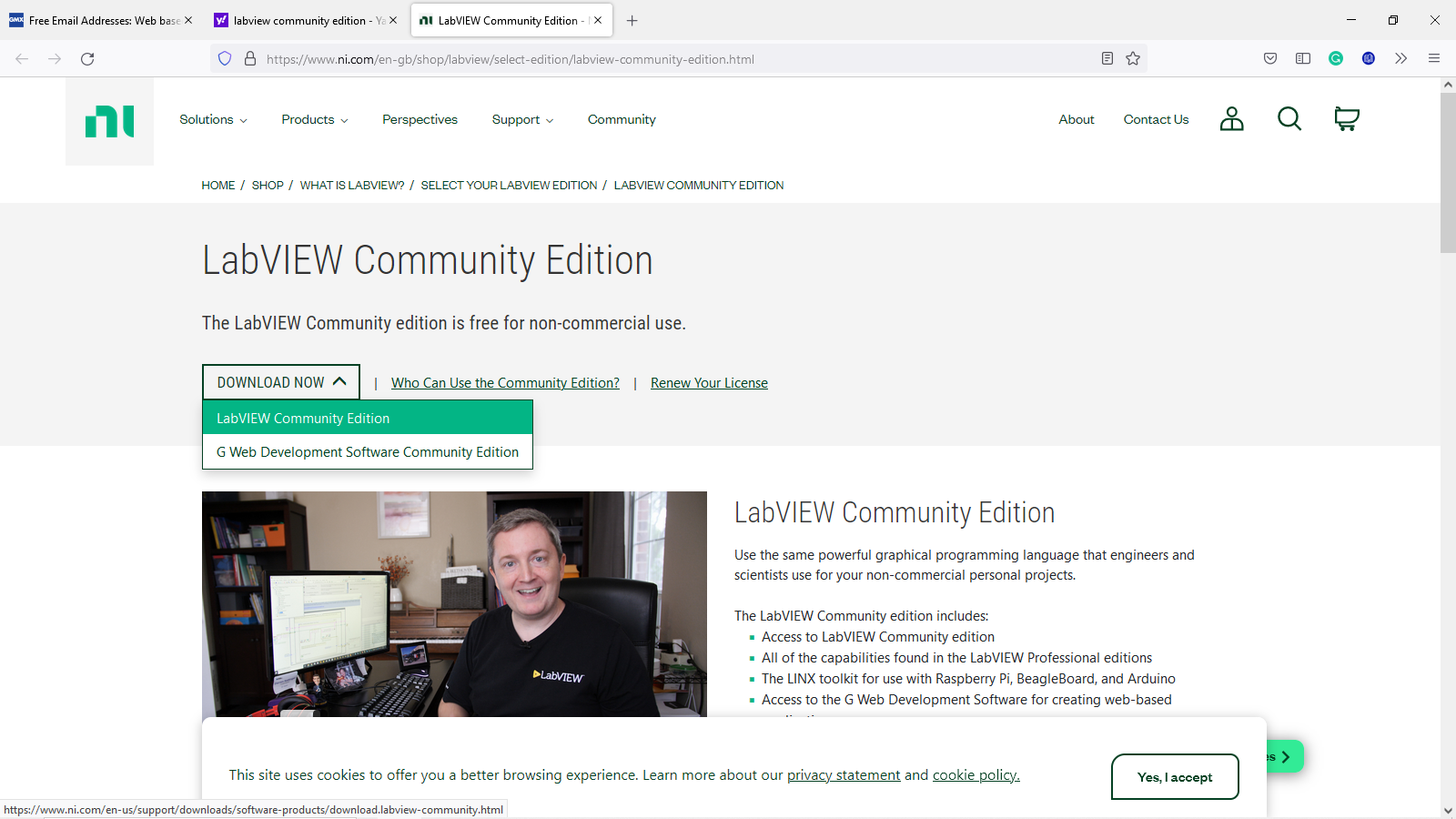

Hello. this software installation is  I litle complicate (I'm software illiterate)
1.On my installation I daunloaded LabView comunity edition "FREE" make one accaunt daunload and installed.
https://www.ni.com/en-gb/shop/labview/select-edition/labview-community-edition.html
Step 1-a, step 1-b (attached screen shots)

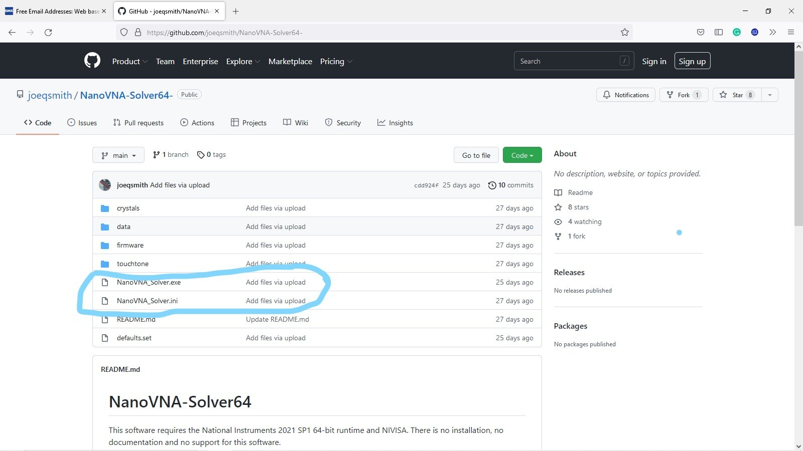

2.Go to GThb  https://github.com/joeqsmith/NanoVNA-Solver64-
daunload the files: NanoVNA_Solver.exe ( https://github.com/joeqsmith/NanoVNA-Solver64-/blob/main/NanoVNA_Solver.exe ) and the NanoVNA_Solver.ini ( https://github.com/joeqsmith/NanoVNA-Solver64-/blob/main/NanoVNA_Solver.ini ) install on one folder *Step 2*

Francesco 2022/04/16 22:24
download the file on the attached screen shot "Step2"

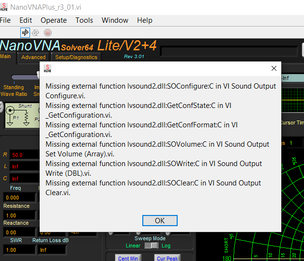

Bob W0EG 2022/04/17 05:41
Francesco,
Thank you. I do have those files downloaded and have the LabView 2021
64bit runtime installed.
I can start the program but the VI is broken because it cannot find
lvsound2.vi and I cannot locate that NI runtime path. Pointing it to
another copy of the VI from the community addition (32bit) I get this error:
On Sun, Apr 17, 2022 at 1:00 AM Francesco <realfran@gmx.co.uk> wrote:

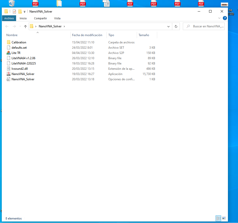

I add the lvsound2.dll put on the Nano-Saver file folder

Francesco 2022/04/17 12:15
Putt the (lvsound2.dll) on the file folder like the screen shot

Bob W0EG 2022/04/17 11:20
OK, ,I need to backtrack a bit.  I had LabView 2022 run time installed so I used package manager to uninstall it and then re-installed from NI and now have the lvsound2.dll file.in it's directory.
I place the installer exe in the same directory as the 2022 runtime and got the attached error.  I the installed the older LabView runtime 2011, ran the installer exe from its directory and got the same error.  Looks like the dll is nor ok but missing the sound lib
I'll keep trying.
Bob W0EG 2022/04/18 01:28
OK, I finally got it installed and the VI is working.  Used 7-zip and installed old version from here;
https://github.com/joeqsmith/NanoVNA_Software/releases/tag/0.10
Thanks for the help.

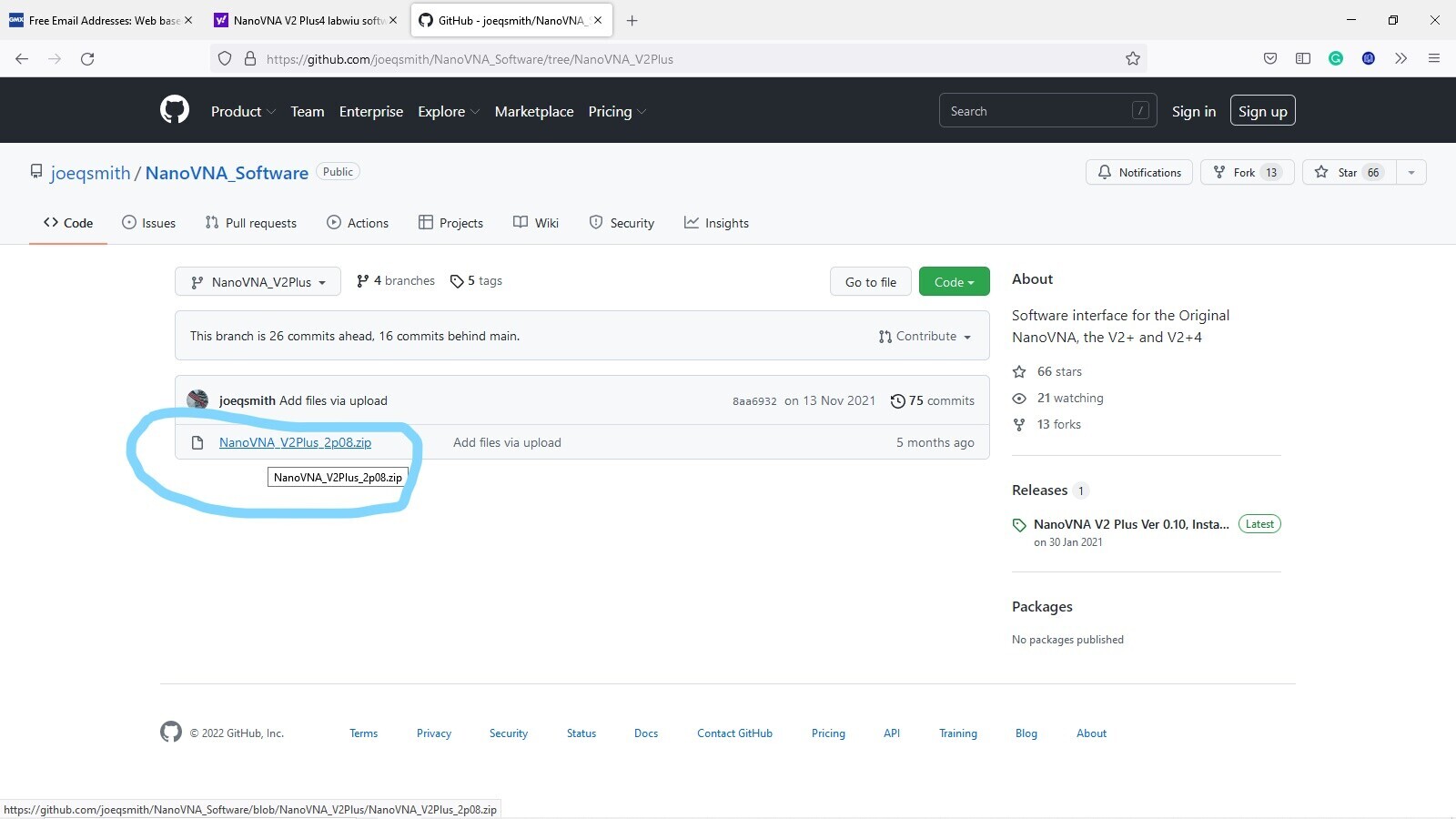

One more question.  I now have NanoVNA V2+4  rev 0.1 installed and working.  To get the current version, I downloaded NanoVNA_V2Plus_2p08.zip from Joe's Gethub and extracted NanoVNA_V2Plus.exe.  That exe runs and open an installer dialog, the installer completer and  NanoVNA V2+4  rev 2.08 loads and runs.  However, it seems that an app exe is not installed I must run the installer each time to start V2.08.  What am I missing?

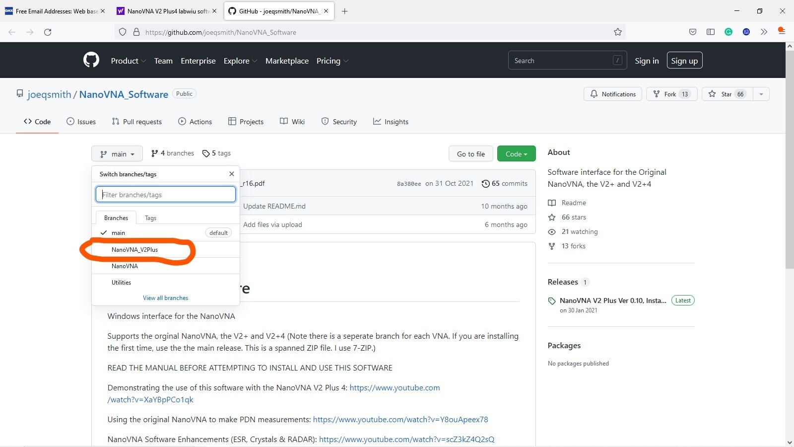

Francesco 2022/04/18 14:24
1-b https://github.com/joeqsmith/NanoVNA_Software
2-b https://github.com/joeqsmith/NanoVNA_Software/tree/NanoVNA_V2Plus
Daunload the NanoVNA_V2Plus go to Window program files (84) unzip the file on
this file **NanoVNA_V2Plus** file.
