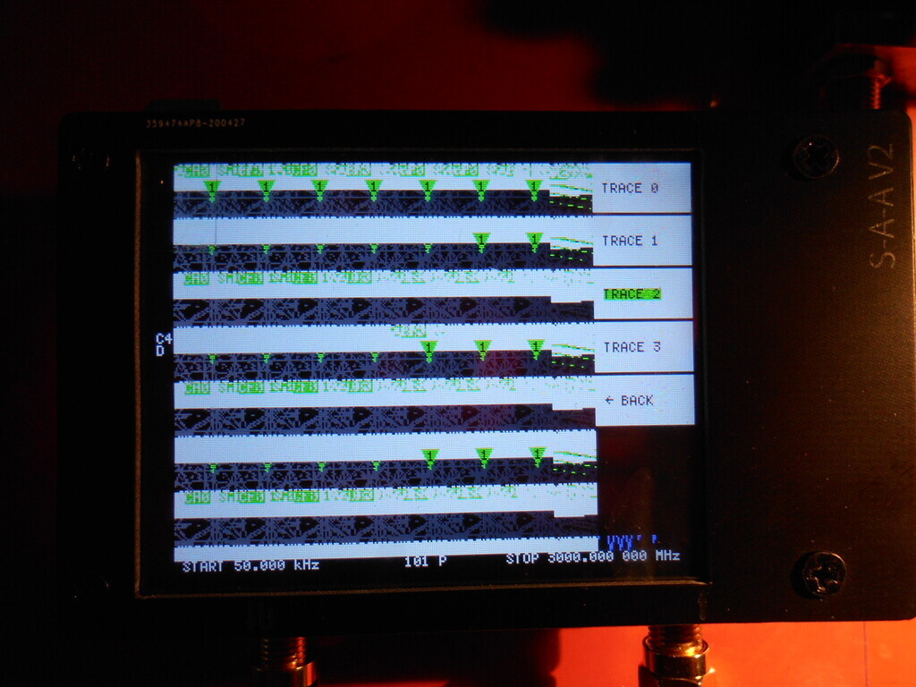

Turning off all traces except Trace 2 results in garbage on screen
Sam Reaves 2020/07/21 11:54
If I turn off all traces but Trace 2 (green Smith) the screen is garbage. If I turn on any trace in addition to trace 2 the display is fine. I am running version
git-20200308-39438ba Build Mar 28 2020 that came installed with the instrument.
pic attached

Carlos Guillermo Vah 2020/07/21 16:07
Hello Sam,
The same happened to me. I solved by upgrade the firmware.

Sam Reaves 2020/07/22 08:24
Thanks. Updating F/W fixed the issue.
