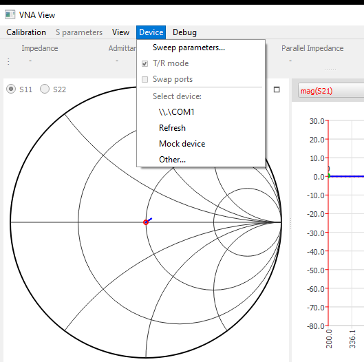

Here is the first activity that I can activate:

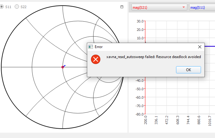

On clicking on COM1, this is the error message I get:
In NANO-SAVER 3.8, all I get is "NOT CONNECTED"
Any ideas? I've run out of ideas. I have two USB cables, but are good.
HELP!

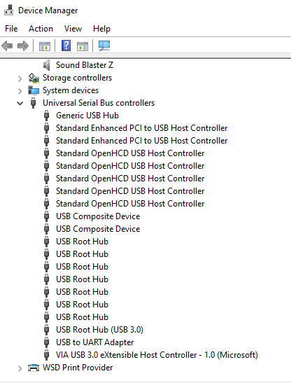

David Eckhardt 2020/12/08 23:35
Here is what Device Manager sees for USB controllers:
How should the proper controller show in the list?

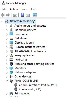

David Eckhardt 2020/12/08 23:47
How can I confirm the USB controller is properly installed?
I have an AMD 6-core processor running at 3.6 GHz. Is all of this
compatible with AMD processors? I have no problems with the pre-V2 NANOs.

Siegfried Jackstien 2020/12/09 01:01
Did you plug in and switch on tge device before fire up qt??
Did you try to click on refresh?
Did you check in device manager if driver installed and on what comport number
the device is found?
Dg9bfc sigi

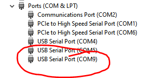

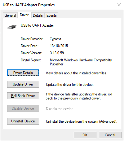

Neil Smith G4DBN 2020/12/09 00:05
Mine appears in USB Controllers as "USB to UART adaptor" and opens up a
new COM port 9. This unit is a V2Plus4.
Neil G4DBN

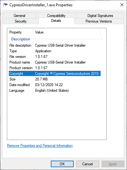

This is the driver installer I used
On 08/12/2020 23:47, David Eckhardt wrote:
David Eckhardt 2020/12/09 00:21
Yes, the device was on before launching either Saver or QT.
Yes, I clicked refresh. Nothing happened. I've also tried manually
entering com1 through com10 with no results.
number the device is found?
How should the driver show itself in device manager? When I click on the
driver downloaded info, it goes through the install as expected and I see
it under Program Files (86). There is an install there for both 32 and 64
bit. When I click on that, all I get is a very, extremely short screen
flash with no additional information. I doubt it is properly installing.
All I see is COM1 whether the NANO is on or off. I do not detect the
presence of the NANO at all.

Tom Paratore 2020/12/09 00:29
Click on com1 at the bottom it will auto connect

Tom Paratore 2020/12/09 00:39
Are you going directly into a USB port or a hub?
Is it a usb 3.0 or 2.0 port?
Have you tried disconnection of all other usb devices and restarting to eliminate port conflicts?
> the driver downloaded info, it goes through the install as expected
> and I see it under Program Files (86).  There is an install there for
> both 32 and 64 bit.  When I click on that, all I get is a very,
> extremely short screen flash with no additional information.  I doubt

You should see it show up in device manager as a *serial port* (not
under the USB devices - although it will also show up there).
If you plug it in, and the device manager screens don't change (and you
don't hear the "chimes") then it's not recognizing it. That points to
USB device driver issues (assuming that the box itself is working, and
the cables are good, and the USB connector on the board didn't get damaged).
I assume you rebooted after installing the USB driver (that's part of
the driver install process usually).
There's a note on the Windows answers site:
https://answers.microsoft.com/en-us/windows/forum/windows_10-hardware/issues-with-usb-to-serial-on-windows-10/72b7d5e8-865b-4fc4-bc48-e6a13eea2f7e
Go to the Device Manager and type “Device Manager” in the lower left
corner of the screen.
Locate the USB to Serial Converter Settings. After plugging a USB device
into your machine, expand the “Universal Serial Bus controllers” list in
Device Manager. Click on the “USB Serial Converter” and open the USB
Serial Converter properties.
Enable the VCP Driver loading by opening the “Advanced” tab within the
USB Serial Converter properties. Make sure the “Load VCP” option is
enabled and then click OK to load the VCP.
Re-connect the device. Unplug the USB device and re-connect it to your
computer. At this time, Windows 10 should recognize the device and load
the Virtual Com Port Driver.
This appears to be similar
https://ncd.io/unable-mount-virtual-com-port-windows-10/

Siegfried Jackstien 2020/12/09 14:53
if the device is found in windows (say as com9 or com 32) then the usb
lines are sure not swapped
otherwise windows would not show it as a valid comport number
and .. if found in windows (say above example com32) ... it will show in
saver, nanovna_app ... or vna_qt also as com 32
maybe some fancy security setings in his windows (or an antivir soft or
similar) was causing the driver not to be installed correct??
here it worked right out of the box ... on a core2duo with win7 and on
an atom tablet with win10 ... with all 3 soft ... and with 3 different
analyzers (i have a v2, a v2plus and a plus4)
73 dg9bfc sigi
