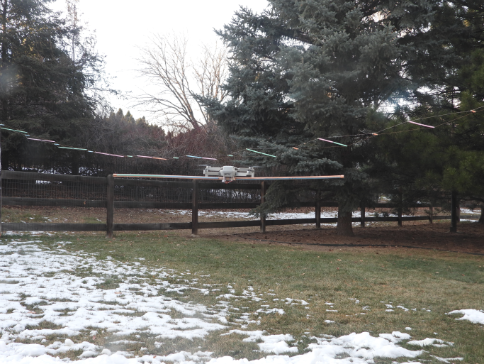

Glenn n6gn 2026/03/06 06:25
Your approach sounds reasonable though for higher directivity antenna systems significantly involving an earth reflected path the far-field distance gets too great for 'home use', at least at my house. (:>)    My reason for antenna measurement was to provide credibility for NEC2 modeling rather than an exhaustive in situ measurement - as valuable as that would be.   I was able to achieve only slightly more than 100' separation between the traveling wave antenna I was testing,  given my available residential real estate limitations.  As the pending article (in DUBUS) describes, this fell considerably short of 2D^2/lambda for the combined antenna&earth system even at VHF.
Except for physically 'small' structures having low directivity at HF or significant gain in the  VHF to microwave region, getting good data in the far field over significant elevation becomes tough. In the US I'm not permitted to fly my quadcopter higher than 400 feet AGL except with special dispensation.    Thus a straight 2-port VNA measurement with test cables and even amateur aviation techniques become impractical.
My approach was to use only a scalar measurement, limited as it was, but aided by quadcopter supporting a VHF dipole of known ERP and pattern. Here's a pic of the quadcopter and horizontally polarized airborne 144 MHz source hovering in front of a ~5 lambda VHF TWA.  This really needed to be measured in an open area of several acres which is something I don't have access to.
In order to get sufficient time/distance resolution it's important to have wideband data.   Simply measuring at an AUT's intended (narrowband) frequency isn't useful to separate some kinds of common multi-path - recognizing that an earth-ray is part of the antenna system for practical implementations.
I guess it's no wonder that commercial antenna ranges, even those at VHF and above, become tremendously expensive.  At lower frequencies they seem to be impossible except by using known, often ionospheric, signal sources.  This is a great value of the amateur and HamSci related WSPR and PSWS investigations.  But that's another story !
Glenn n6gn

> On Mar 7, 2026, at 09:12, Glenn n6gn via groups.io
at VHF.
> <Screenshot from 2026-03-06 07-14-54.png>
> Glenn n6gn
