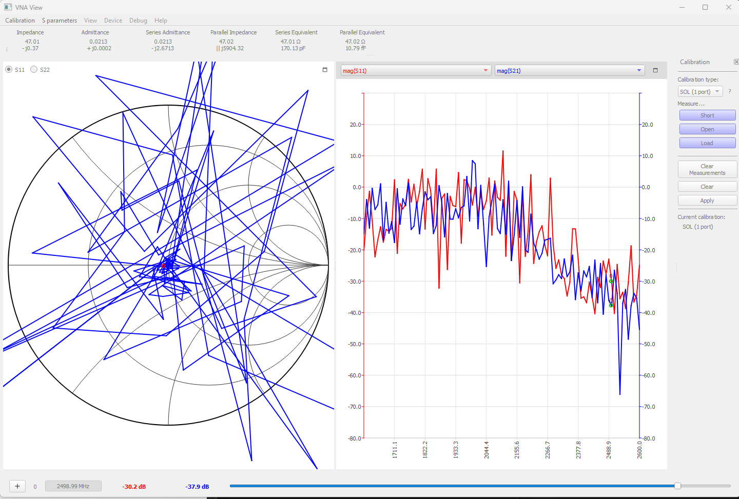

I've been trying to use my NanoVNA without success and for the last couple of days it's just been showing only noise and don't know how to troubleshoot.
Can this device be fixed?
What / How to test?
Same image with either 'nanorfe-20220814-v2plus45' or 'nanorfe-20250121-v2plus45' firmware files.
(I get the same graphs on the LCD display when using it in standalone)
Glenn n6gn 2025/10/04 05:52
Do you get the same result when calibration is turned off?  Clear Measurements, Clear.
It could be that you have a corrupt calibration so the ('corrected' results are just the difference of big numbers and look like noise.  Could also be that your unit has stopped measuring properly.
