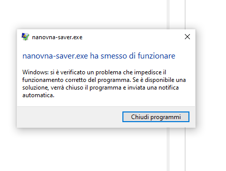

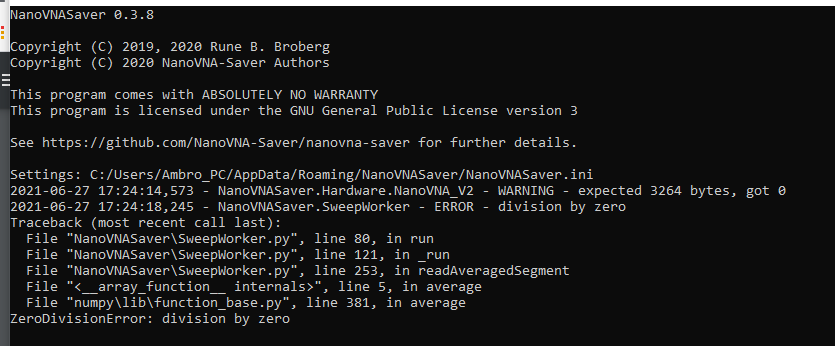

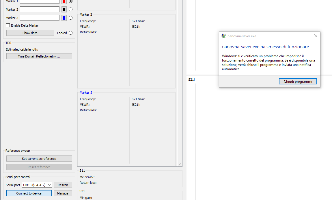

good day to all in this forum,
I am trying to use Nanosaver 0.3.8 together with NanoVNA V2-2 connected to my PC.. My PC runs windows_10_64 bits, has an Inter I_5 CPU and 8 GRAM.
I was able to connect and use the program just few times but now the program locks up as soos as the USB connect tab is pressed.
The program shows the correct USB port number and it agrees with the device manager. Is there a particule procedure  for connecting the USB ? The program shows " division by zero " somewhere.
I am attaching some screen captures to this mail.
Thanks in advance for any help.

Siegfried Jackstien 2021/06/28 05:51
set avg to none and save in slot 0
program ask for say 100 points and you set device to avg x2 the soft
only gets 50 points
avg to none solves that

you have set avg to none ok ...but... then you have to switch to
calibrate and save that in slot 0 (no need to do a full calibration just
the need to save the settings so the device knows that you want to use
avg=0)
there are a few memory slots for storing calibrations but slot 0 is used
as default when switching on so that is also used when you connect to usb
if you did not save the settings then it is not used when switching on
(or restarting like it does when connect to usb)
save the setings and it should work

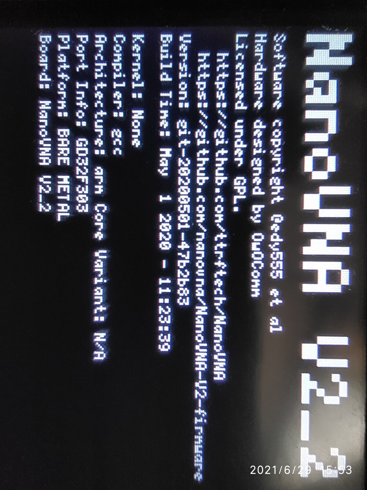

Ambro_IW2FVO 2021/06/29 16:56
this is my nanovna version.Do i have to change the firmware ?Thanks

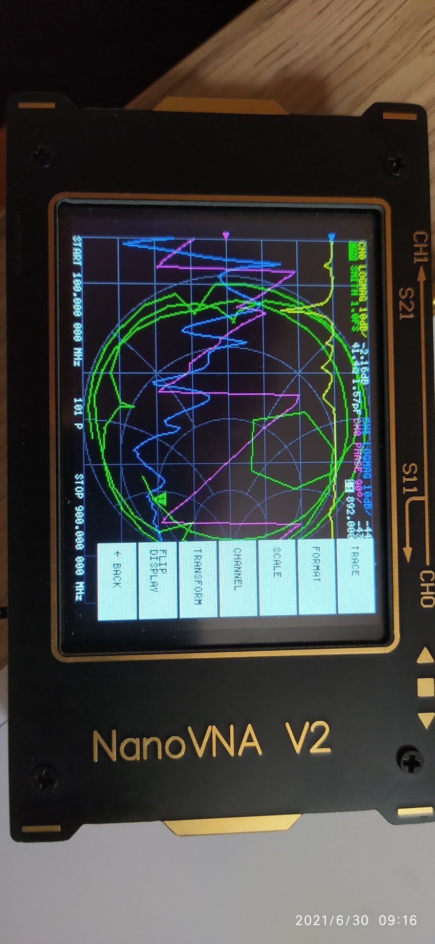

Siegfried Jackstien 2021/06/29 22:35
avg in device can be found under "display" (trace, format, scale,
channel, AVG!!!!!, transform, flipdisplay, back)
click on avg and set that to none ... then on "back, another time on
back ... and you are in the main menue
now select calibrate (fourth from top) and save (second from top) ...
and save 0 ...
.... thats it
from your picture i see that you have still very old (outdated) firmware
on your device ... so thats another thing to solve (update your firmware!)
here latest "official" from owo (se added file)
dislord also wrote SEVERAL fw for the different devices (v2 small and
big lcd, v2plus with small and big display and for v2plus4 ... with and
without fpu) so i do not exactly know what is the last version from displord
i think it was "V2 320x240 noecal 301 points smooth.bin" ... but i am
not sure (hey dislord ... lend ambro a hand!! what was your last version
for the "normal" v2?!?!?)
some pc software have problems if you have not set avg to 0 ... soft ask
for a given number of points and the device sends points divided by
average (as an example soft asks for 100 but gets 20 if your set avg to x5)
if i remember right some of these things were solved in newer firmware
(dislord ... another help from you needed here ... wink wink)
using average IN THE PC SOFT is a totally different thingy (depending of
pc software very high numbers and super slow scanning could be used)
hope that helps you a bit

Ambro_IW2FVO 2021/06/30 07:13
thanks very much Siegfried and Stan:> I can not find the AVG tab on my device:  "display" (trace, format, scale, channel, AVG!!!!!, transform, flipdisplay, back) : AVG is NOT present.  What is the reason ?> I downloaded the two bin files as per the attached capture: do you suggest me to upload one of these files to my device ? could you please indicate briefly the step by step procedure to load them into the device?  I am sorry to do not be so skilled on this matter  and I do not want to make my vna unserviceable !Yours is a very great help for me .Bye On Wednesday, June 30, 2021, 05:03:14 AM GMT+2, Stan Holmes <zs6hal@gmail.com> wrote:
Just sent him the correct version link for V2_2
https://nanorfe.com/downloads/20201013/nanovna-v2-20201013-v2_2.bin
Ambro_IW2FVO 2021/06/30 07:19
I am attaching the correct capture relevant to the missing AVG selection...bye

Vladimir Lebedev 2021/06/30 00:39
Hello Ambro!
Your FW Version from 01.05.2020 has no AVG point under DISPLAY menue, but FW from 13.10.2020 and 24.11.2020-experimental have AVG (see manual menue map). Experimental version is better.
AVG = average
Siegfried Jackstien 2021/06/30 13:52
old firmware :-(
Am 30.06.2021 um 09:19 schrieb Ambro_IW2FVO via groups.io:
