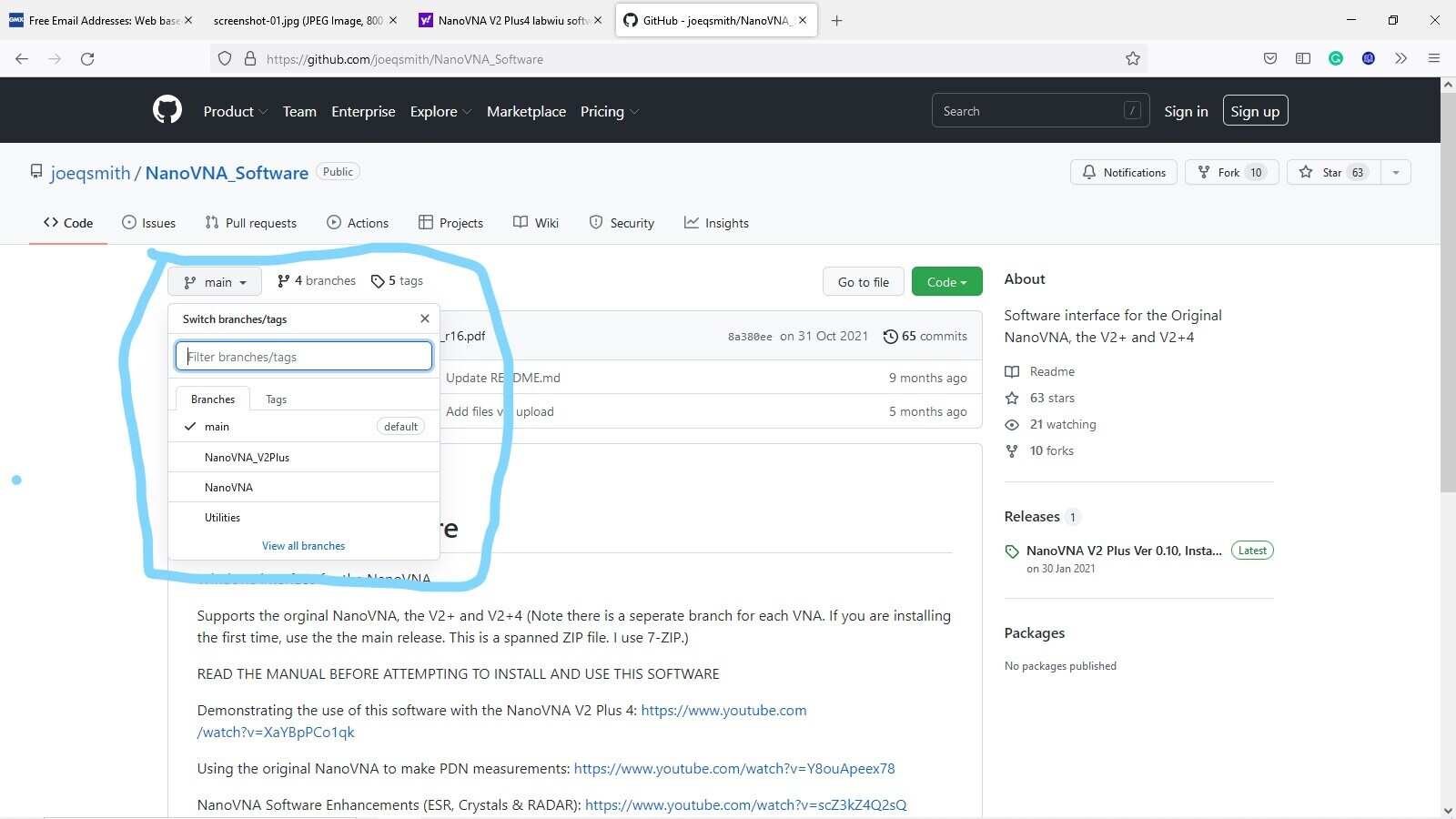

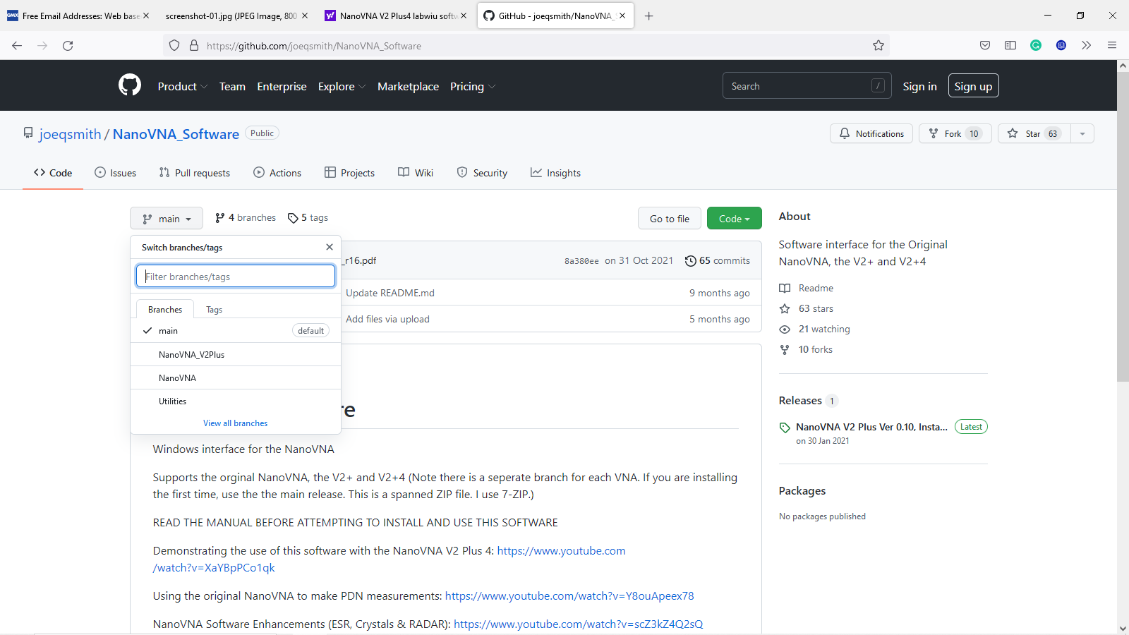

Francesco 2022/03/15 18:48
Hello. First make one folder on you desktop "NanoVNA V2"
1\. go to : https://github.com/joeqsmith/NanoVNA_Software/releases/tag/0.10
2. daunload all 21 Zip file and copy on the folder "NanoVNA V2"
3.Unzip _all file_ inside the NanoVNA V2 folder
4.You find two files neuw one "license" ond one other "
**NanoVNA_V2Plus_Installer " open and find VOLUME**
5\. VOLUME open ond you find the "setup" install the program.
This install all file necessary for the basic installation
Please read the manual to get on not tray short cut.

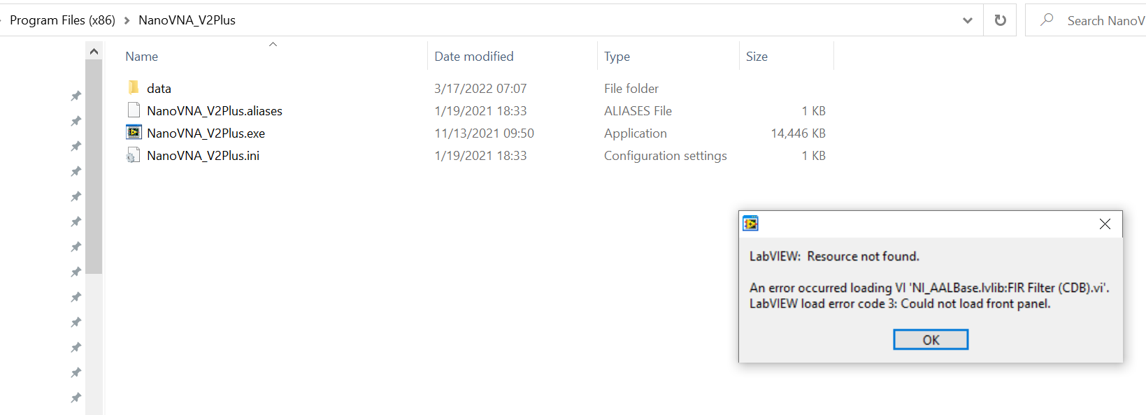

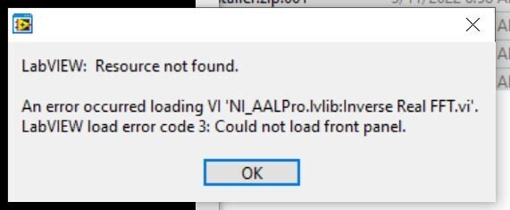

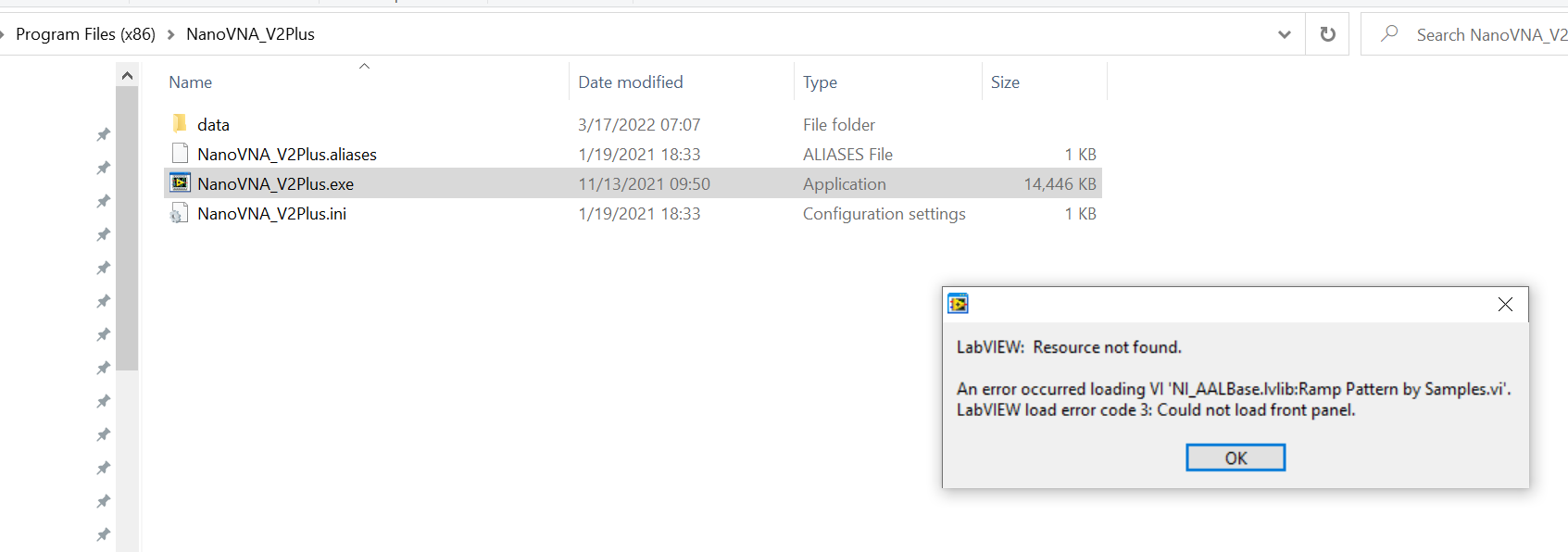

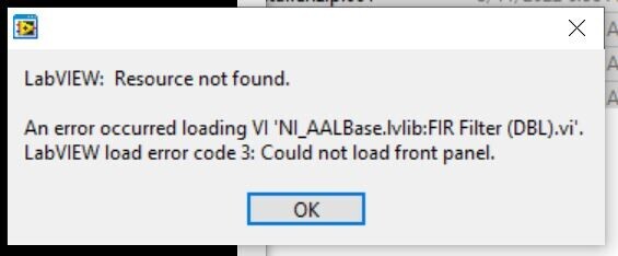

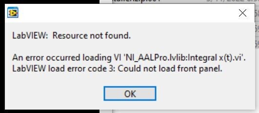

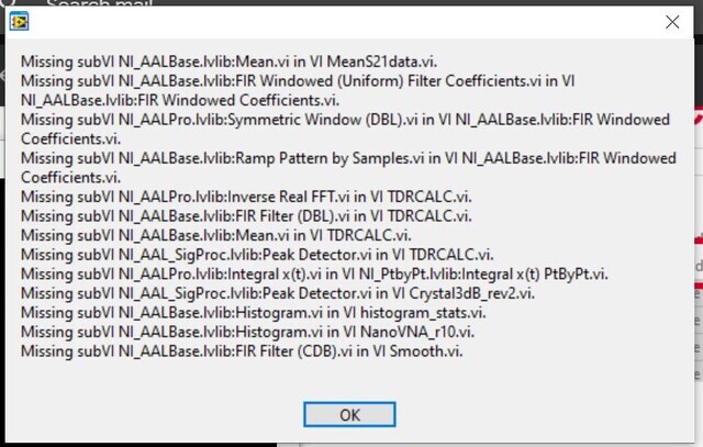

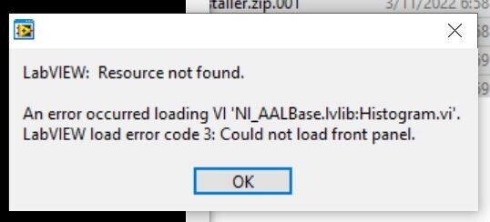

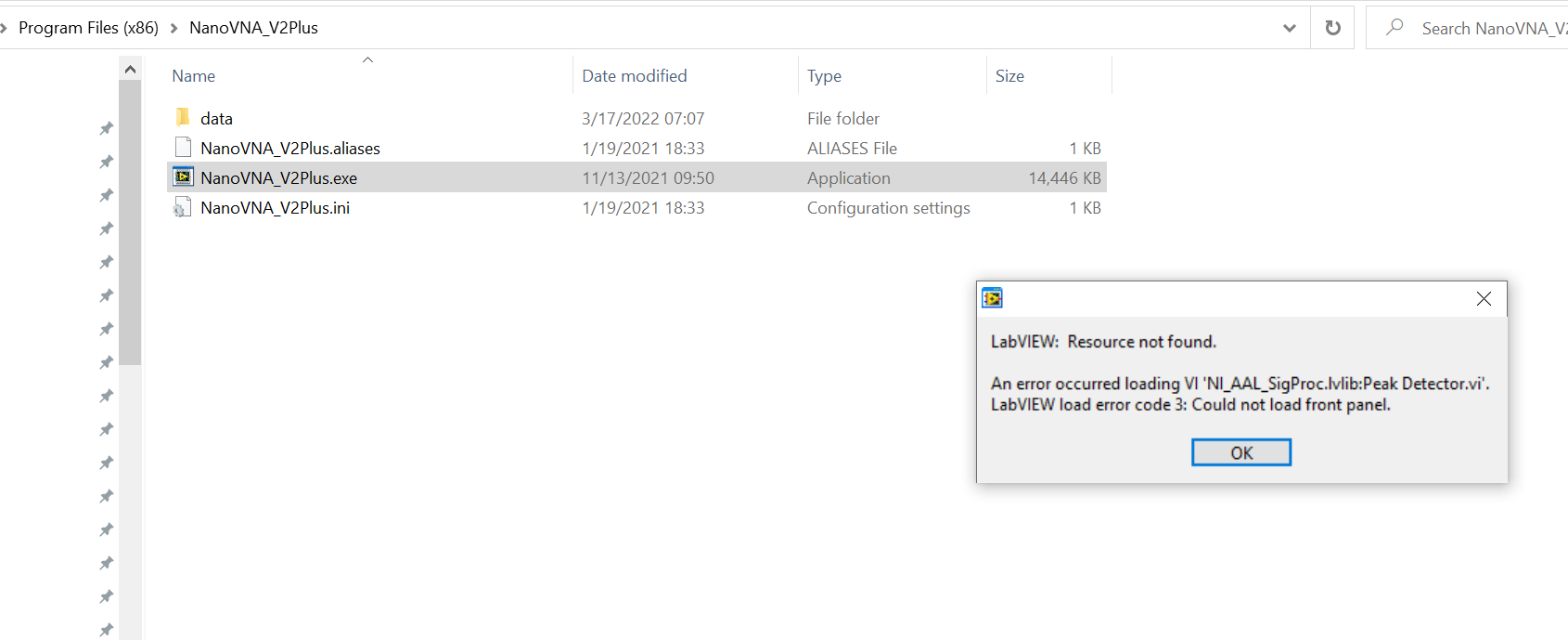

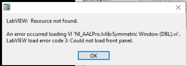

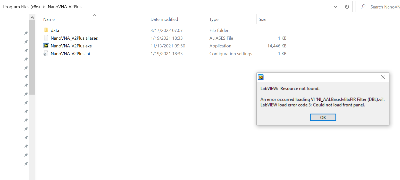

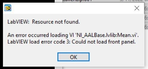

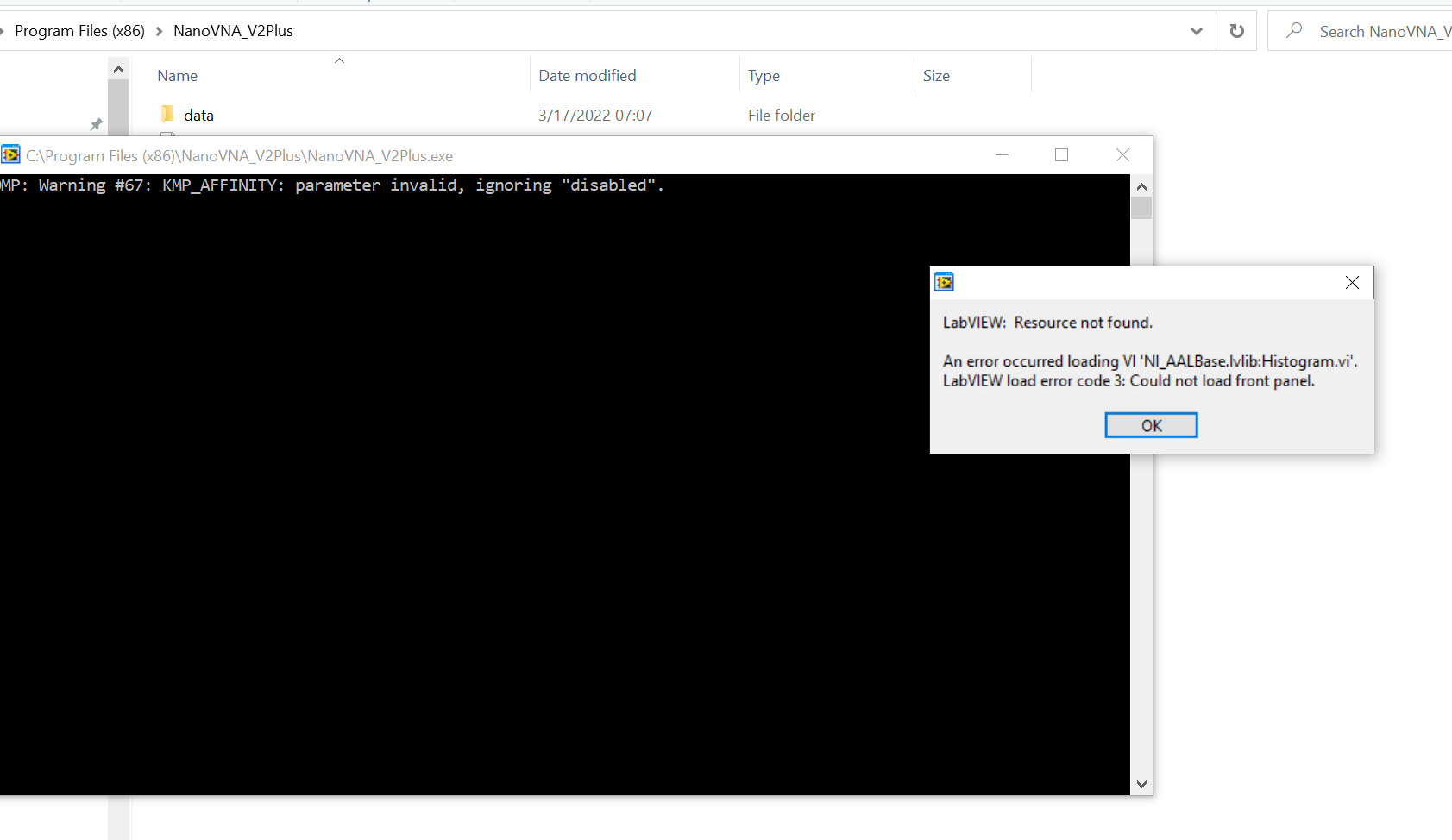

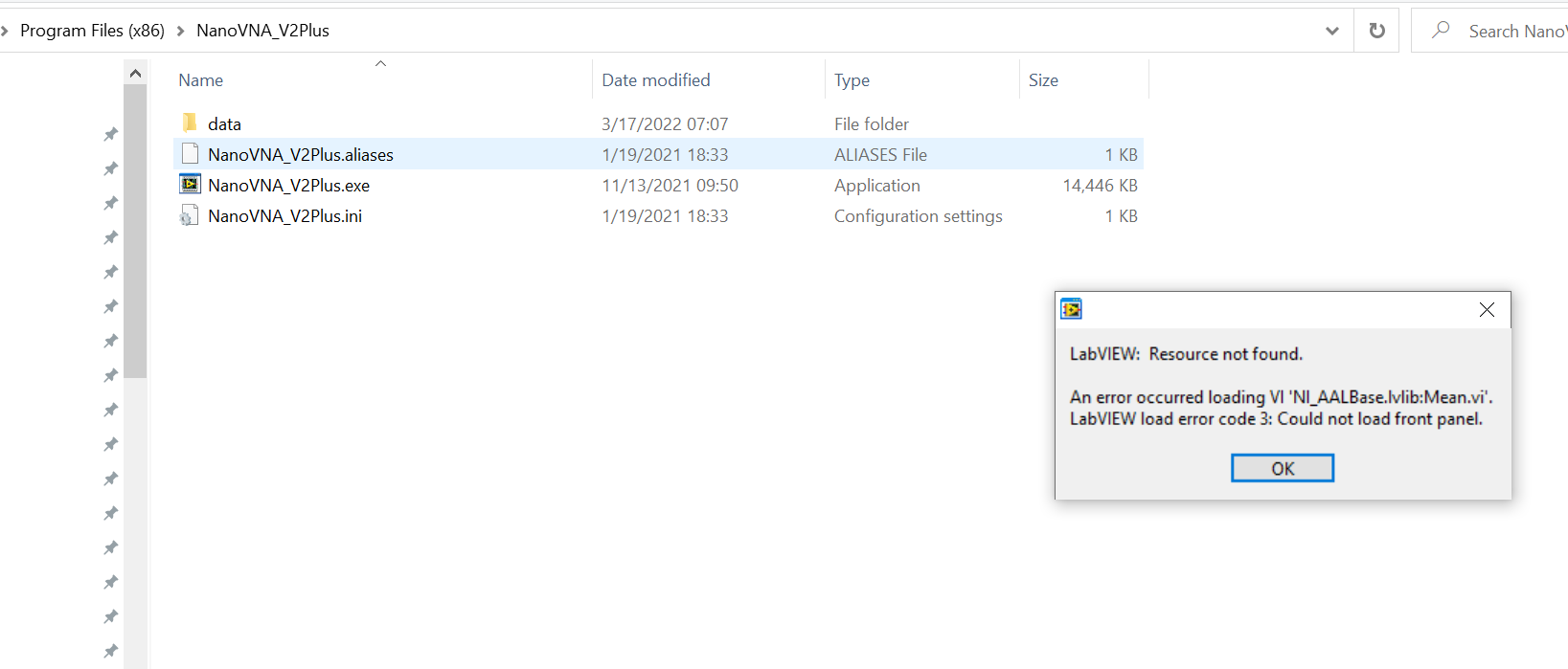

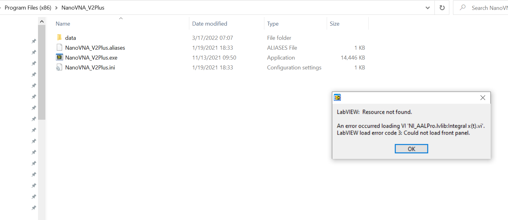

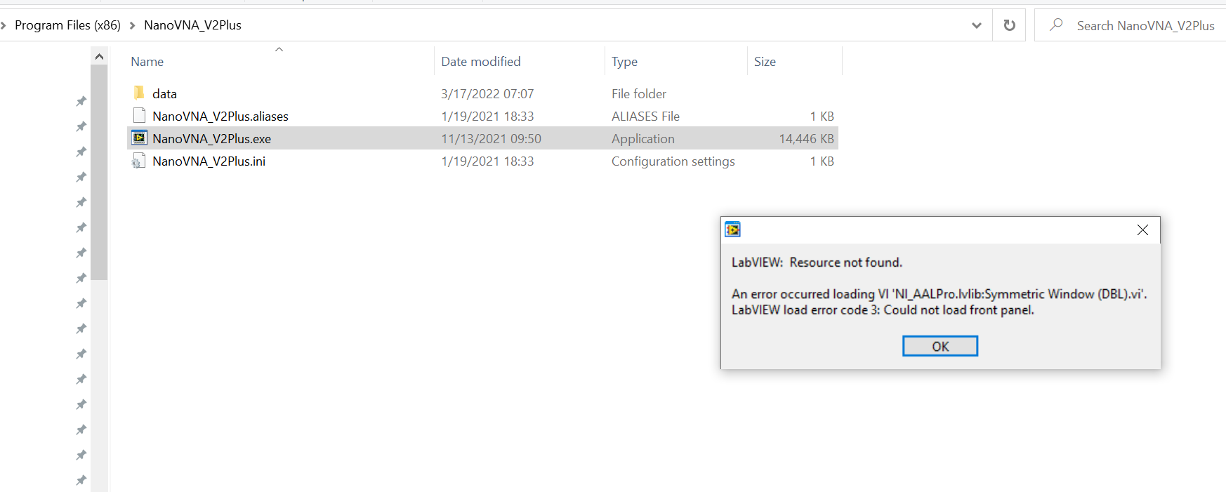

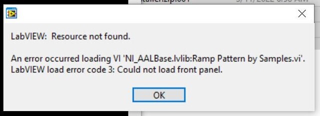

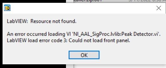

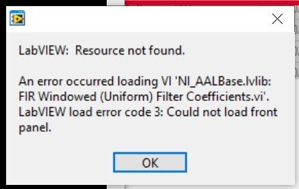

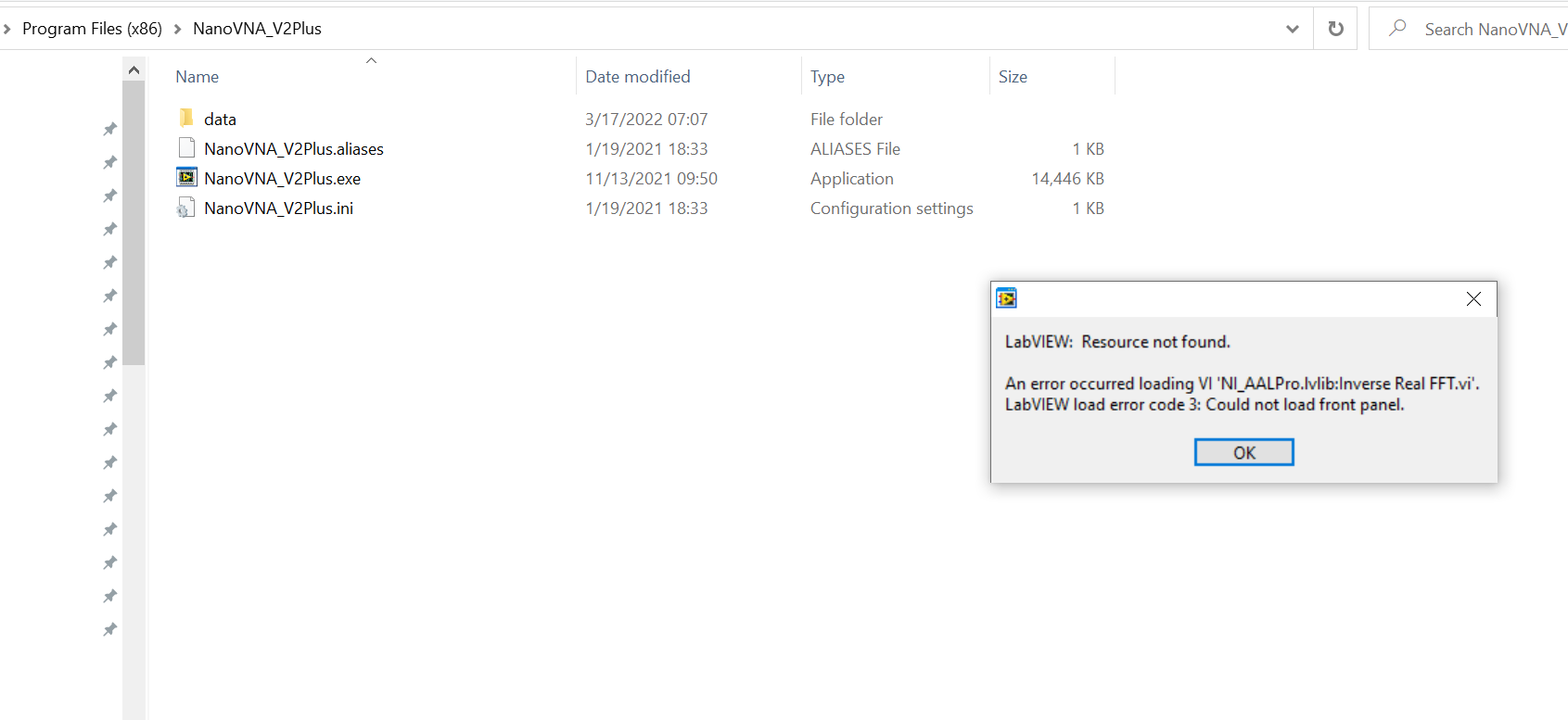

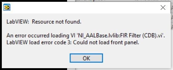

Anthony 2022/03/16 09:27
Francesco,
In following your procedure, these are the errors I receive when running the software.  Thats the reason I ask about the other softwares.
Francesco 2022/03/16 17:50
You have exstracted all 21 file on the same place?
**Sent:** Wednesday, March 16, 2022 at 4:27 PM
**From:** "Anthony" <n2ki.ham@gmail.com>
**To:** NanoVNAV2@groups.io
**Subject:** Re: [nanovnav2] NanoVNA Software by Joe Smith
Francesco,
![](cid:attach_2_16DCE94C28122FED_24928@groups.io)![](cid:attach_10_16DCE94C28FA10A9_24928@groups.io)![](cid:attach_9_16DCE94C28F6376B_24928@groups.io)![](cid:attach_8_16DCE94C28717A2E_24928@groups.io)![](cid:attach_7_16DCE94C2865F874_24928@groups.io)![](cid:attach_6_16DCE94C285FC7CA_24928@groups.io)![](cid:attach_5_16DCE94C28480FD4_24928@groups.io)![](cid:attach_4_16DCE94C28170818_24928@groups.io)![](cid:attach_3_16DCE94C28148438_24928@groups.io)![](cid:attach_1_16DCE94C2810139C_24928@groups.io)![](cid:attach_0_16DCE94C280932E5_24928@groups.io)
Francesco 2022/03/16 18:30
I have installed this software on different PC and laptop with Win10, Labviuw
is integrate on this files. Everybody make the same error (download labView)
Forget all think unistall LabViuew starting clean from the bigining with the 4
steps. You don't need install or use LabVIEW software.
Is ibended on this files.
**_exstract all 21 files on the same folder._**

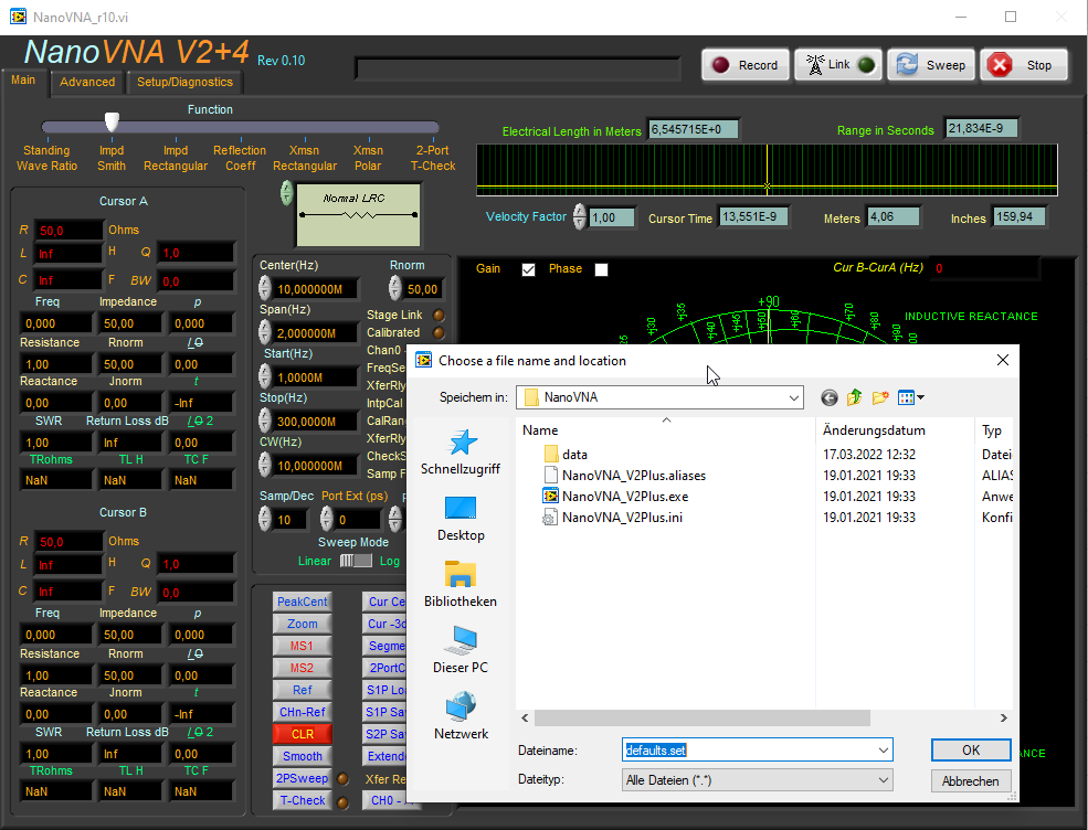

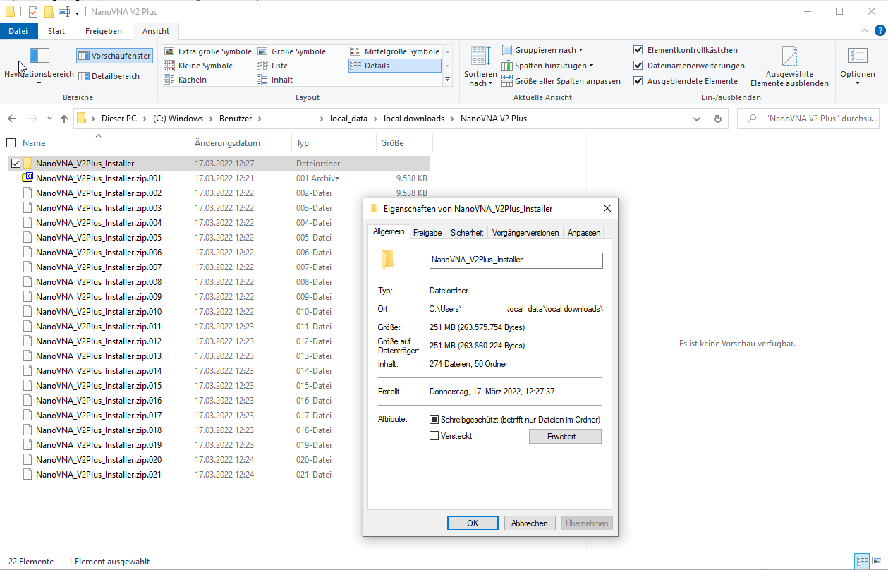

Lena, DL9LC 2022/03/17 10:32
You can have LabView allready installed.
I have LabView Community Edition and several runtime versions installed on my Laptop and pc - both Win 10 pro 64 - without any problems.
As Francesco wrote, follow exactly the installation instructions and everything is fine.
The software is it worth to read all of the documentation - it's fantastic!
vy 73 de DL9LC, Lena

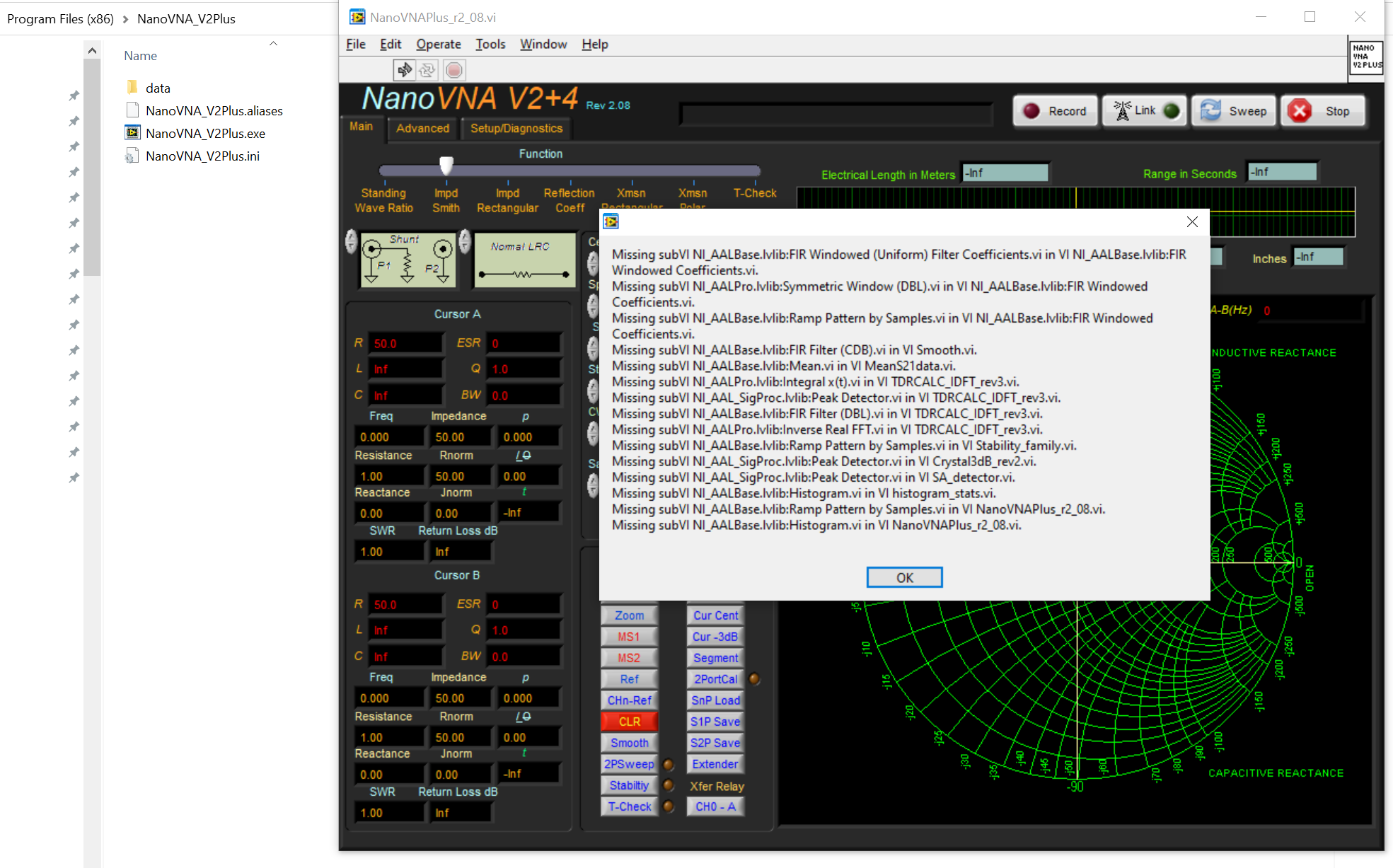

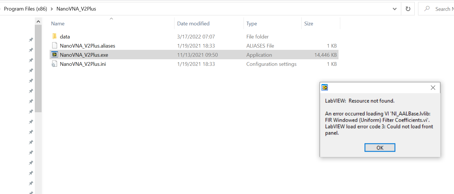

Anthony 2022/03/17 06:59
Like I said Francesco. following your instructions, I ended up with the
LabView errors I have already added to the thread. It is not as simple as
you describe. Steps must be missing. The instructions, which I read, and
copied to the thread, lacks clarity in areas about what to
download as there are multiple files which, in my opinion, not clearly
indicated which are for new install, etc, yata yata yata.
Yes, the 21 zip files are all downloaded. Yes, I used 7 Zip to extract.
Yes I executed the exe file to install. When I run the software, Labview
errors.
To your point, "everybody makes the same error", dont you think the
instructions should be addressed?
Anthony (N2KI)

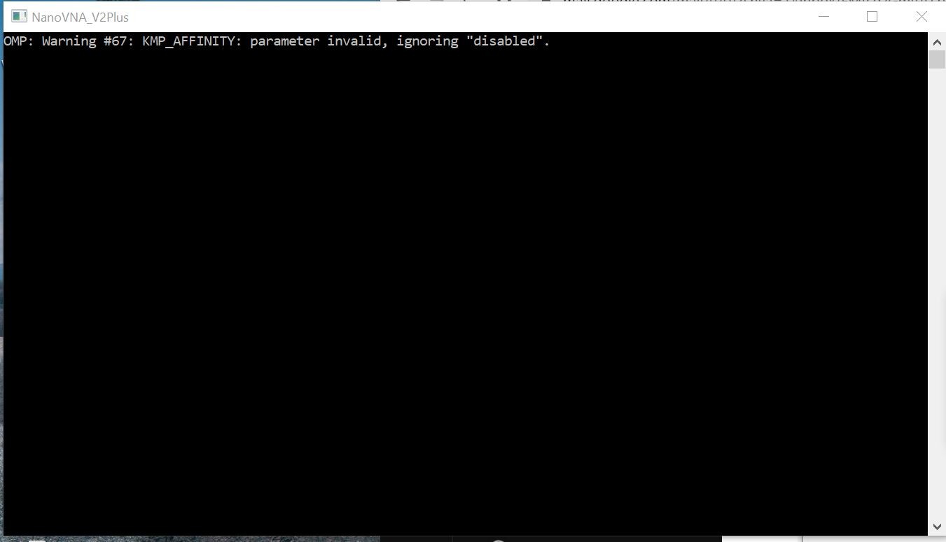

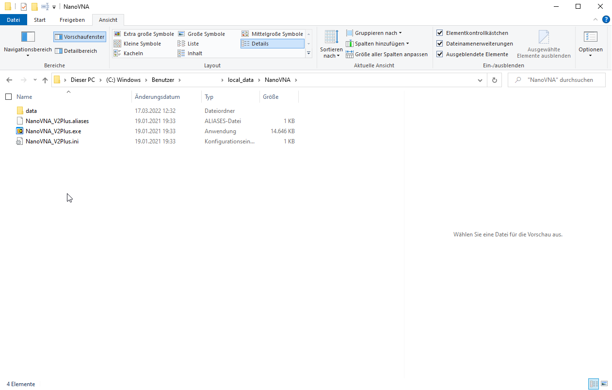

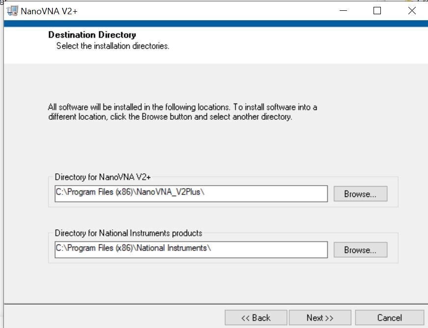

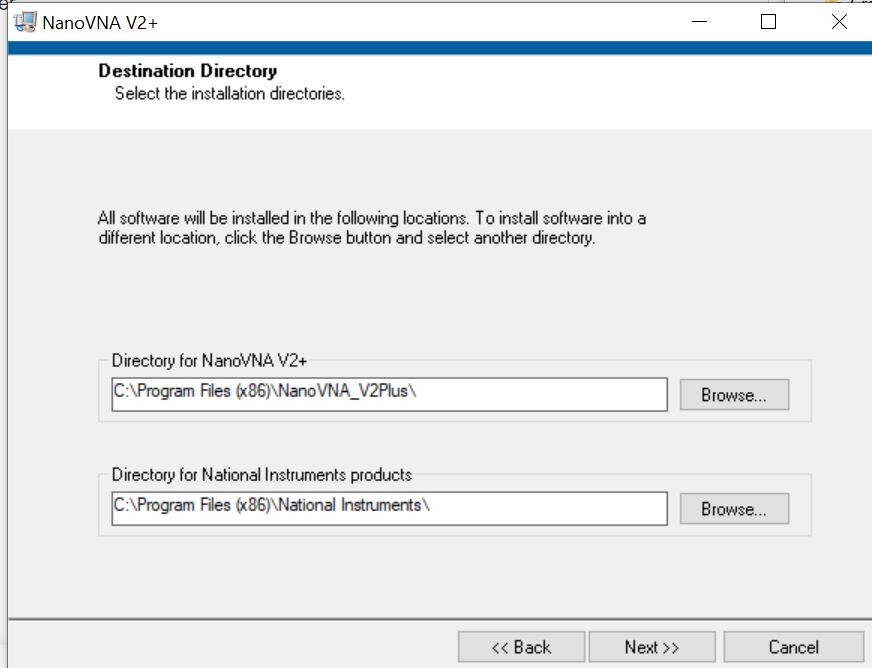

Lena, DL9LC 2022/03/17 13:06
I have made the installation here at my QRL-PC.
Attached 5 screenshoots - maybe you can see any difference.
It works in just a view minutes.

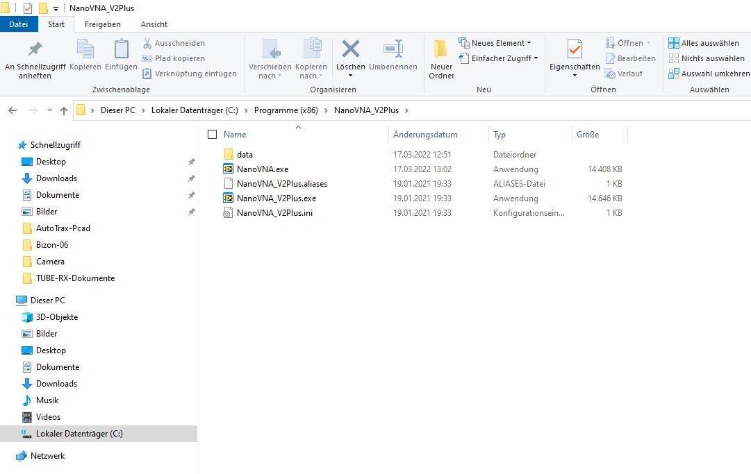

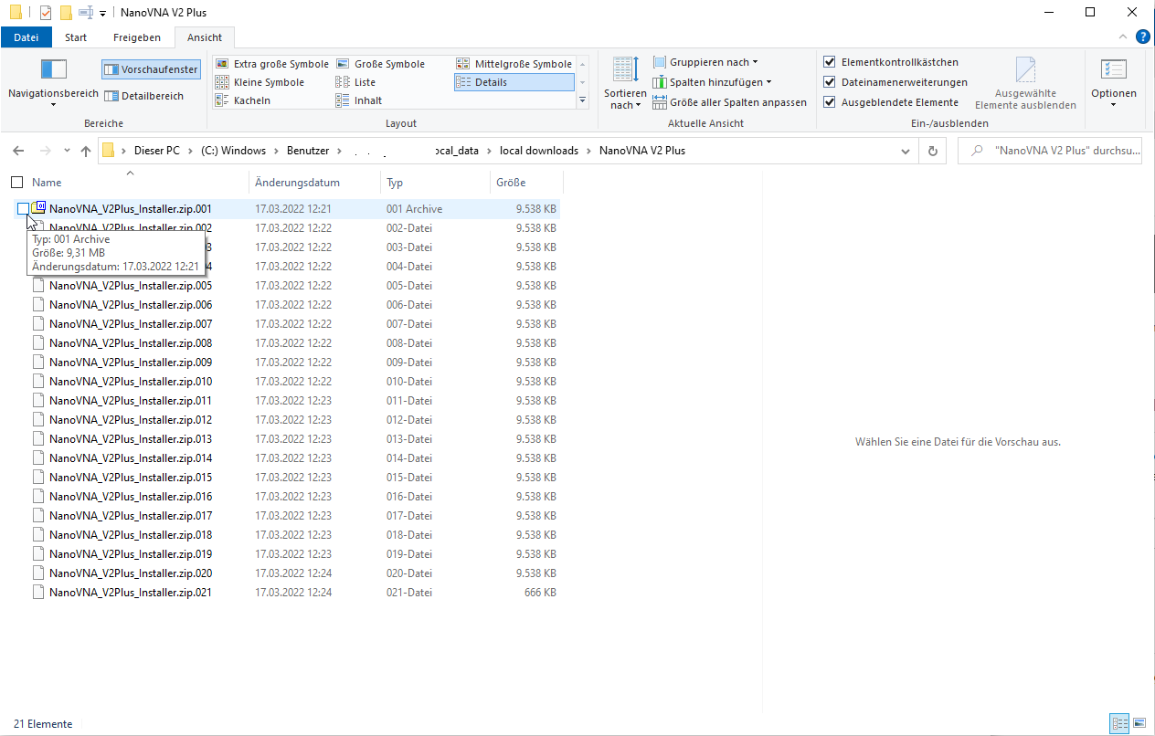

Vladimir Lebedev 2022/03/17 07:15
Hello Lena!
Please see this pictures. I Have this programm installed - one EXE File for NanoVNA and one EXE file for NanoVNA-V2Plus4. Both file work.
But I have only NanoVNA-H4

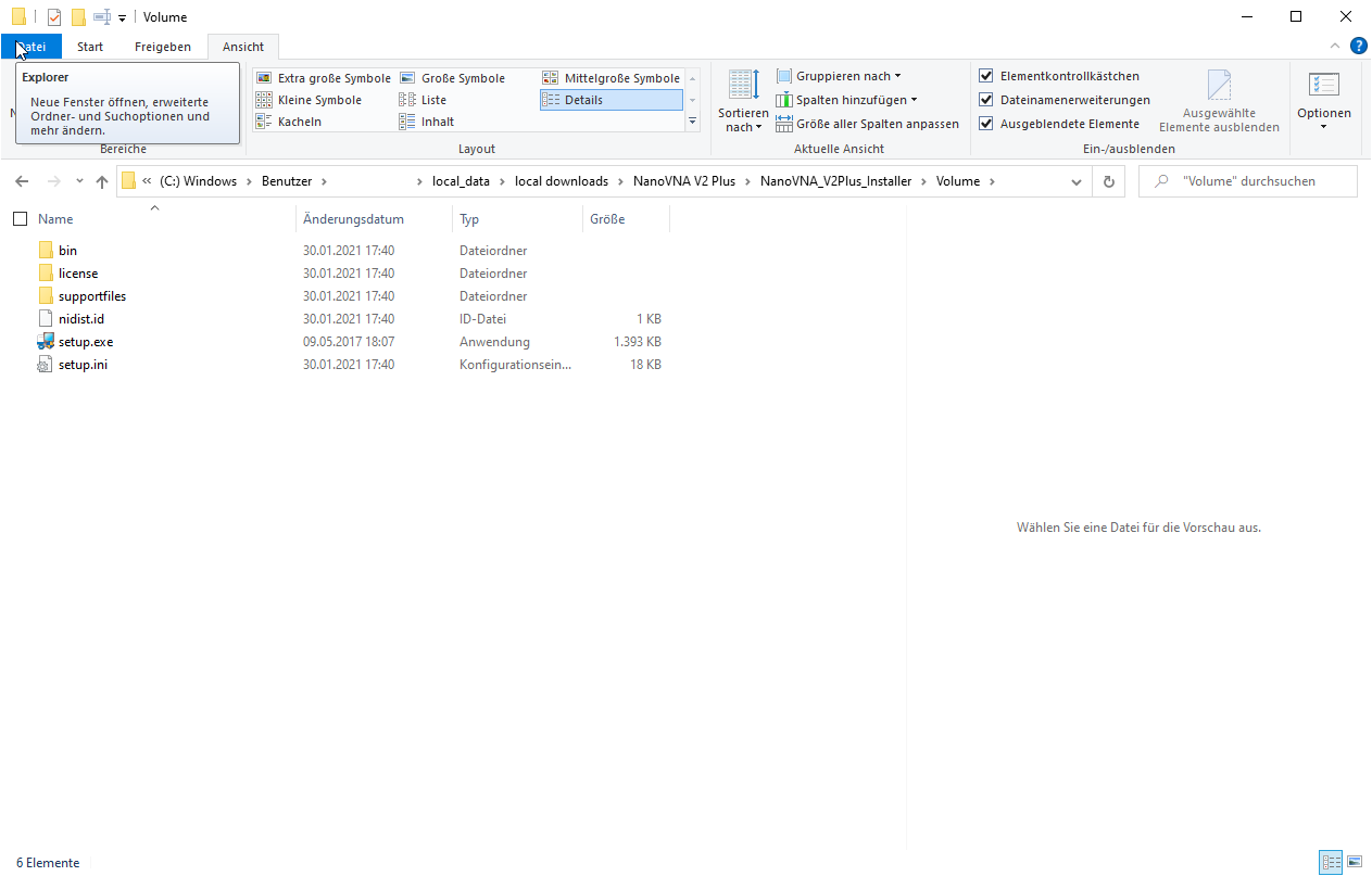

Lena, DL9LC 2022/03/17 15:51
Hey Vladimir,
thats the way to do it.
First do the base installation (from the 21 files) and after that you can download and copy to your installation directory the version you need (i.e. V2plus4).
I don't know, if the NanoVNA-H4 is fully supported, because i use a plus4, wich performs very well.
Francesco 2022/03/17 15:54
Hello, I get problem to install the first time this software (personally I'm
computer illiterate) I download Labviuw thinking whose the best idea and i get
on totally mess.
Then I clean the pc uninstalled all think and I starting again with the step
1, 2, 3, 4 and I ended on V.0.10. (this is old version) on this 21 files there
is the labwiu necessari files for this software.
I go to GitHub https://github.com/joeqsmith/NanoVNA_Software
Go to "main" and download the file version for the NanoVNA 2/plus/ or the
version of the classical NanoVNA.
I like to help more but I'm very limited for my ignorance on computer.
Best wishes.
Francesco.

> Francesco,
![](cid:17f97802bbac204bfcc8)![](cid:17f97802bbac204bfcc6)![](cid:17f97802bbac204bfcc9)![](cid:17f97802bb9c204bfcc2)![](cid:17f97802bbac204bfcc5)![](cid:17f97802bbac204bfcca)![](cid:17f97802bb9c204bfcc3)![](cid:17f97802bbac204bfccb)![](cid:17f97802bbac204bfcc4)![](cid:17f97802bbac204bfcc7)![](cid:17f97802bb9c204bfcc1)

Anthony 2022/03/17 13:46
Vlad,
It's not an error on install. It's errors when running the program. It
seems It's looking for LabView. See the images I shared earlier in the
thread.
Anthony - N2KI

But if you have an *existing* Labview installation, the default path
might be pointing to *it* as opposed to the one that Joe's files install.
I've been bit by that more than once.  The program doesn't run, because
it doesn't find the stuff it's looking for, because it's looking
somewhere else.
Anthony 2022/03/17 14:19
Jim,
I removed all instances of the NI softwares. Rebooted, reinstalled the
NanoNVA software and I get the same errors. So either the software is not
getting installed with the zip files, or it is in a different location than
where it is programmed to look.
Anthony - N2KI

Jim Lux 2022/03/17 11:24
On 3/17/22 11:19 AM, Anthony wrote:
> Jim,
> not getting installed with the zip files, or it is in a different
> location than where it is programmed to look.
The error messages say what it's looking for, don't they?.  You could do
a file search of your disk and see if they're anywhere (or look in the
zips?)
Also, check your %PATH% variable and make sure there's not something
lurking there that's causing problems. The uninstall for some software
isn't perfect at fixing the path - they tend to err on the side of
leaving stuff on the path, because they don't know if something else is
also using it.
Jim Lux 2022/03/17 11:34

I don't have a Windows machine handy today - What might be useful if is
someone has a working installation to generate a directory listing of
the files (and where they are, if in multiple directories).  Then
Anthony can compare his directory (post-installation) and see if
everything is there.
Looking at the error messages, it's hard to tell if there should be a
file called NI_AALPro.lvlib, for instance. I think there's a series of
libraries (NI_AALBase.lvlib) which have component .vi in there
(Histogram.vi, FIR FIlter (CDB).vi, etc).

Anthony 2022/03/17 16:27
Jim
To your earlier point regarding a blank slate. That's what I started with
initially. I had not sought the NI packages until I started the software
after Francisco's method. The errors were numerous. So I went further down
into the software instruction manual and started digging for the NI
packages. Which of course, did not help or correct the errors.
So now I am back to installing as Francesco suggested, but with the same
litany of errors as it is searching for LabView.
Anthony - N2KI

Anthony 2022/03/18 07:25
Vlad, Lena,
Thats what I did here. I started with the installation of the 21 files.
Those installed in two folders
[image: Intall.JPG]
Now, what are you suggesting to do? Drag which file into which folder?
Thanks!
Anthony (N2KI)

Anthony 2022/03/18 08:04
In addition to the litany of errors I am already receiving, This is another
one.
[image: error.JPG]
Anthony (N2KI)

Lena, DL9LC 2022/03/18 17:08
>From this point on accept all defaults and press "next" untils the installation is done.
After that you will find the executable in C:\Program Files (x86)\NanoVNA_V2Plus.
You can lauch it from there for the first time - it should run.
After that you can copy the update to this folder to get the desired version.
Anthony 2022/03/18 12:42
Lena,
That's exactly what I am doing.
First error window upon execution of the exe file followed by the rest of
the error windows. They are included here again. I am not sure what the
issue is.
Anthony (N2KI)
On Fri, Mar 18, 2022 at 12:08 PM Lena, DL9LC <dl9lc@darc.de> wrote:
Bob W0EG 2022/04/25 08:01
Installing Joe Smith’s software for the NanoVNA V2Plus
Install 7-zip  (free)
Download all 21  NanoVNA_V2Plus_Installer.zip.nnn files from here:
open NanoVNA_V2Plus_Installer.zip.001 with 7-zip (all 21 installer zip files will then be extracted.
Run the installer.  You will then have version 1 installed at C:\Program Files (x86)\NanoVNA_V2Plus
Confirm that it works than get the latest version of the exe at:
https://github.com/joeqsmith/NanoVNA_Software/blob/NanoVNA_V2Plus/NanoVNA_V2Plus_2p08.zip
Replace the version 1 NanoVNA_V2Plus.exe in C:\Program Files (x86)\NanoVNA_V2Plus
with new version exe.
