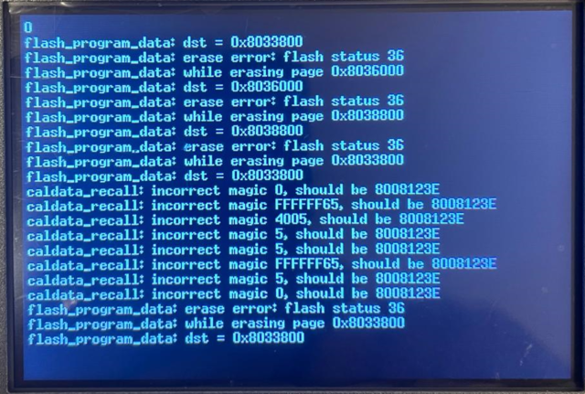

I don't know if the truobles listed in the post subject all come from
a processor failure, anyway the problems persist.
Sometime the startup is immediate, several consecutive times, then it happens
the boot hangs at beginning, with a white display ...
Any suggestions?
I've opened and observed the unit at scope, re-done the soldering of the processor,
but nothing changes.
Fabio - I5LHY
one photo: when I try so SAVE to a memory 0-4 I have this message (nont precisely the
same for all memories)
