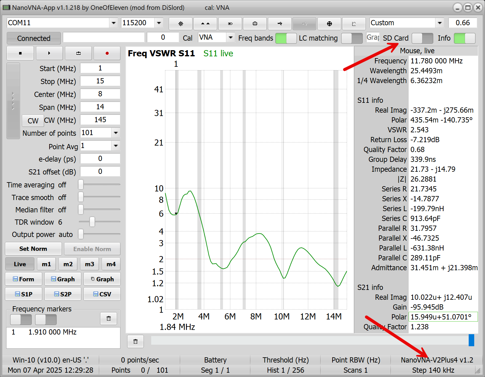

I have a NanoVNA-V2Plus4 from AURSINC on Amazon.  As far as I can tell, it is "original" not a clone.  I disassembled it just to check out markings, chips, etc.  It did have a SD card slot on the back side of the LCD display panel.  You have to unplug the panel from the main board to see it.  Sort of strange as you cannot access it with the aluminum case on.  I have no idea if the firmware actually gives you usage of the slot.  I do see that it shows up in NanoVNA-APP.  I am using DisLord's latest 1.4.01 firmware and v1.1.218 of theNanoVNA-APP software.  I attached a screen shot.
