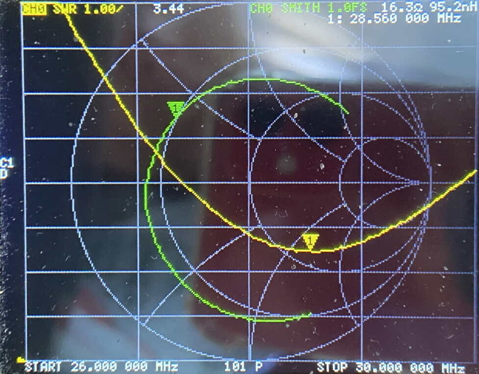

Just installed a 10-meter NMO mount antenna on top of my van. No receive or transmit through it. Looking at the NanoVNA I don't know why it is so far off:
Can this readout be a symptom that the antenna is not contacting the NMO mount? It is a Larsen base and the antenna is Laird. That means instead of a bendable tang it has a spring-loaded center pin. Trouble is, I can't verify that the pin is contacting the NMO, but it may be close enough to measure the antenna's SWR. Any expertise on this?

First of all, I have always found NMO mounts to be the worst. If it
isn't bad now, it will be. What does it show with an ohmmeter??? That
would always be my first check.

With the feedline connected to the NANO, lightly touch the antenna at the
tip. If the NANO display changes in a big way, the antenna is likely
properly connected to the NMO center. If very little change occurs when
touching the antenna tip, likely the antenna is not connecting to the NMO
center. Some of these antennas may have a tapped inductor between 'ground'
and the antenna, proper. This makes the ohm meter test unreliable.

I would disagree with not using the ohmmeter check. A tapped inductor
makes no difference because it is above the connection. All you are
trying to do it confirm a connection.

Try a regular-type Antenna Analyzer like the MFJ or a Grid dip meter.
Check coax cable continuity to the NMO base, and also check the
cable center connector to shield for short circuit. They way things are
made today anything is possible!
