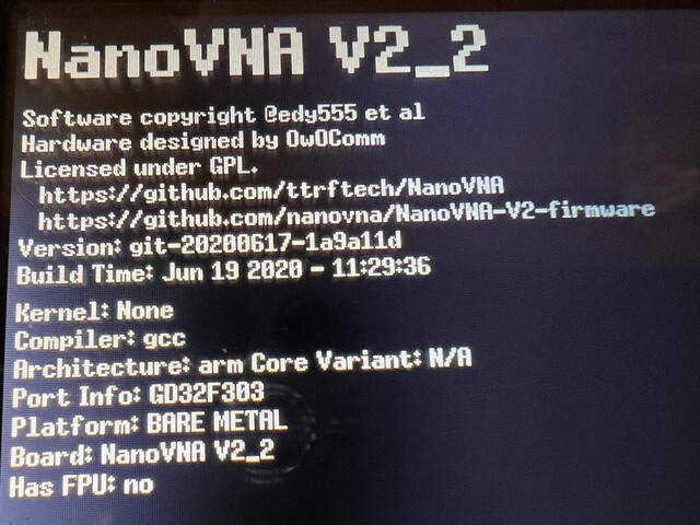

Hi all,
I am looking to the win10 driver for the VNA model GS-400 50KHz-3 GHz.
I have tried to connect to laptop bat driver is nort recognized, says Error.
Attached photo of the SW and HW information of my device.
Thanks in advance to anyone may help.
Giuliano

Hello David and Giuliano,
I just checked my Windows 10 machine which recognizes my older (circa 2020) NanoVNA-SAA-2N. The installed driver is listed under Device Manager as Cypress Semiconductor version 3.13.0.59, dated 13-Oct-2015. A link to the Cypress Driver download can be found on the nanorfe website, about halfway down the page:
https://nanorfe.com/nanovna-v2-software.html#nanovna-qt
As for installing the Cypress driver, you might have to delete any previous drivers that come up when you first plug in your NanoVNA to a USB port, and then reinstall the Cypress drivers.
As to software for updating the firmware in the device, I have had best success with NanoVNA-App. There are a few variants out there, including variants from DiSlord and Owen Duffy, but all of them work for me. As far as I can tell, neither NanoVNA-QT nor NanoVNA-Saver have an option for uploading firmware into the device, but I might be missing a feature somewhere. My go-to app for all-around functionality is NanoVNA-App. Here is a link to download DiSlord's latest version of NanoVNA-App:
https://github.com/DiSlord/NanoVNA-App/blob/main/Win32/Release/NanoVNA-App.exe
To download the file, click on the small icon of a downward arrow pointing into a box, the second icon from the right next to the pencil icon in the light gray bar about ¼ of the way down the screen.
Here is a link to Owen Duffy's site to download his latest version:
https://github.com/owenduffy/NanoVNA-App/releases
Good luck.
Ken -- WBØOCV
