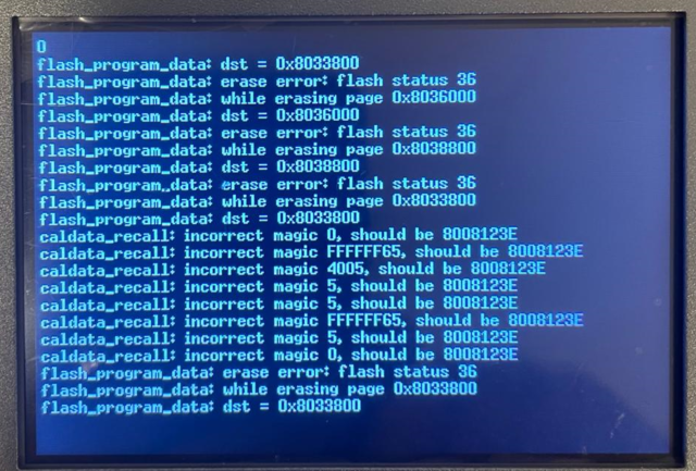

Several days ago I have this wrong behaviour of my V2 plus4:
Switching on, the screen is white and after a few minutes the progrsam starts it seems normally.
I've discovered that the is a problem saving calibration data, a problem with flash writing appears,
the numbers change if I change the memory 0-4 but the message is the more or less the same:
It is the processor broken?
Fabio - I5LHY
Fabio Morsani 2025/09/26 00:58
Weel, suppose it the processor broken.
I can replace it but it has a bootloader, isn't it?
How to load it?
