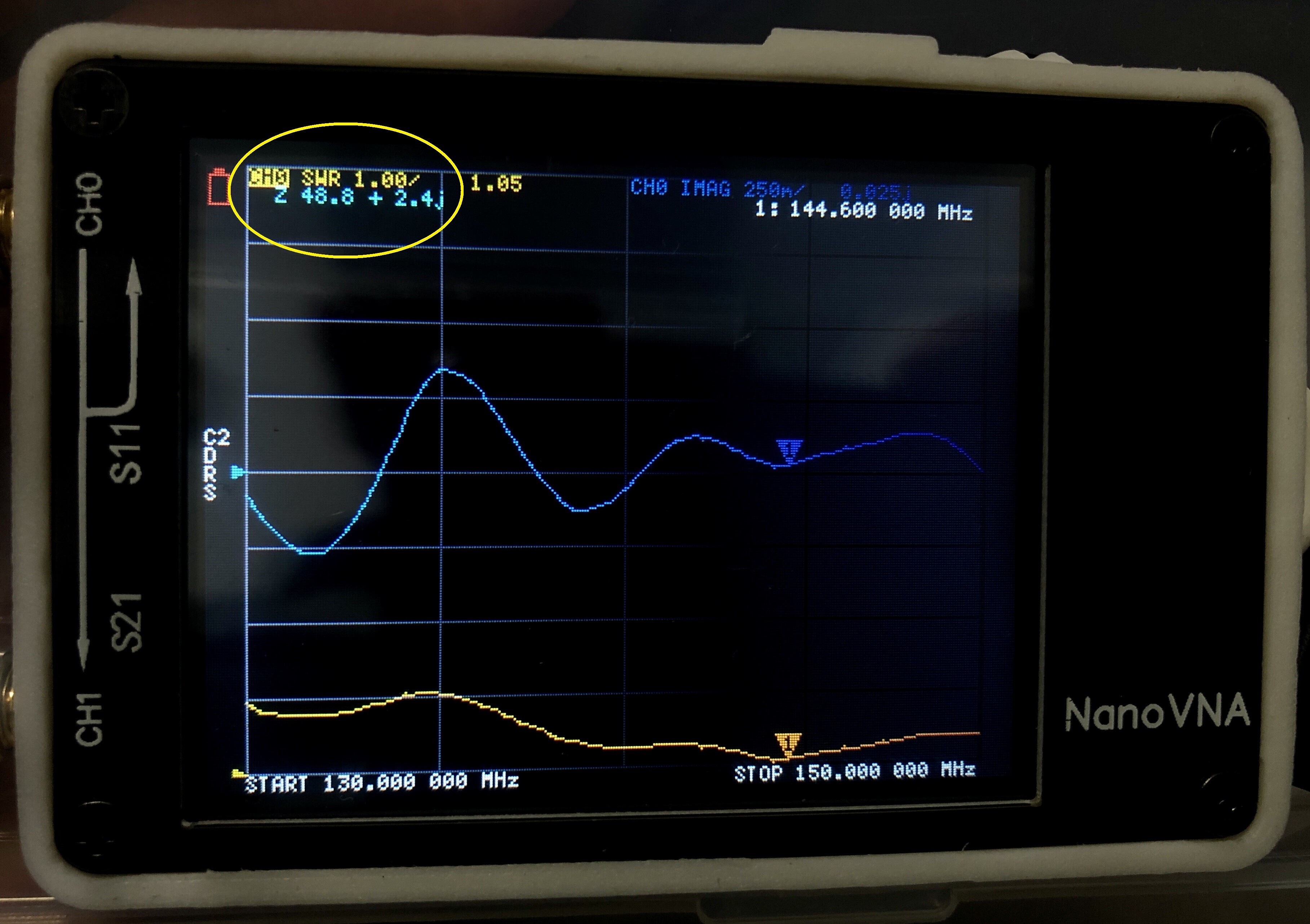

A kind request to the developers of the firmware ... in the next versions, it would be very nice if we had on the screen the representation of the complex number that represents the complex impedance of the antenna (Z = R + jX) ... this would help antenna developers a lot... Excellent job guys!
We have this in the tiny nanoVNA version 1:
Roger Need 2020/09/11 09:10
I have not seen the impedance under CH0 SWR.  What firmware for tiny nanoVNA version 1 are you using?
Roger
DiSlord 2020/09/11 09:32
You can select SMITH trace, and in MARKER->SMITH VALUE select format (include R+JjX, R+L/C, Re + Im as so on)
