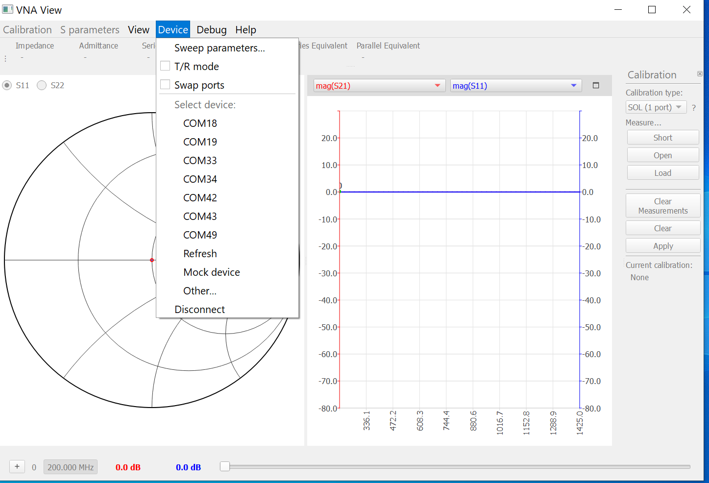

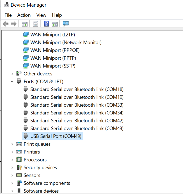

Hi, in DFU mode the device will show a white screen, but it should show up on the Devices menu in VNA View/NanoVNA-QT when connected to a computer through USB. If it doesn't show up, can you check if it's detected in Device Manager (Windows) or dmesg (Linux/Mac OS)?

I am indeed trying from the NanoVNA-QT sw and connecting through USB to the computer. I have windows and I checked the port number (COM49):

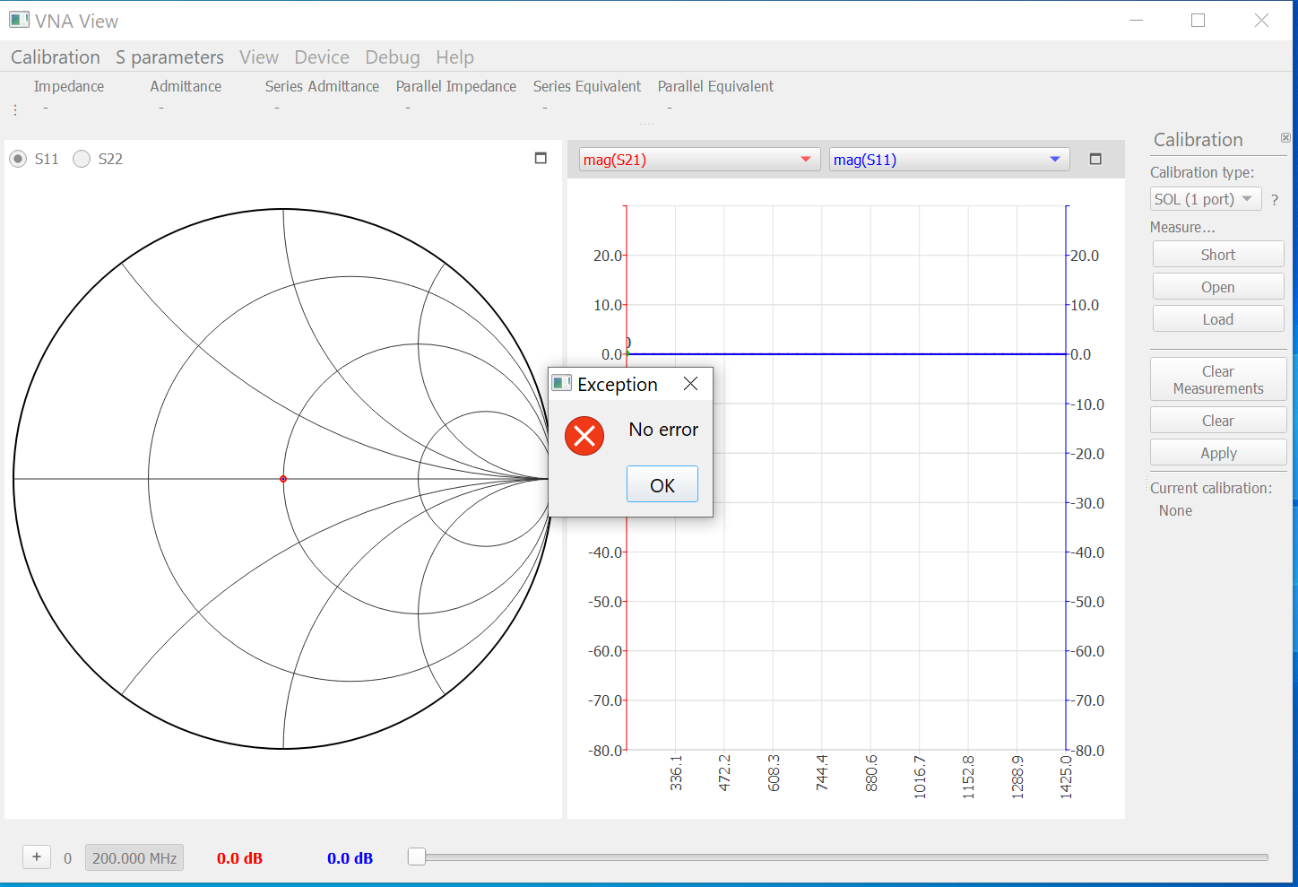

But when I select port COM49 on the sw it shows this:
[cid:image002.png@01DACD79.4E772920]
[cid:image003.png@01DACD79.4E772920]
And if I click OK nothing happens. The screen is white and I cannot select calibration.
