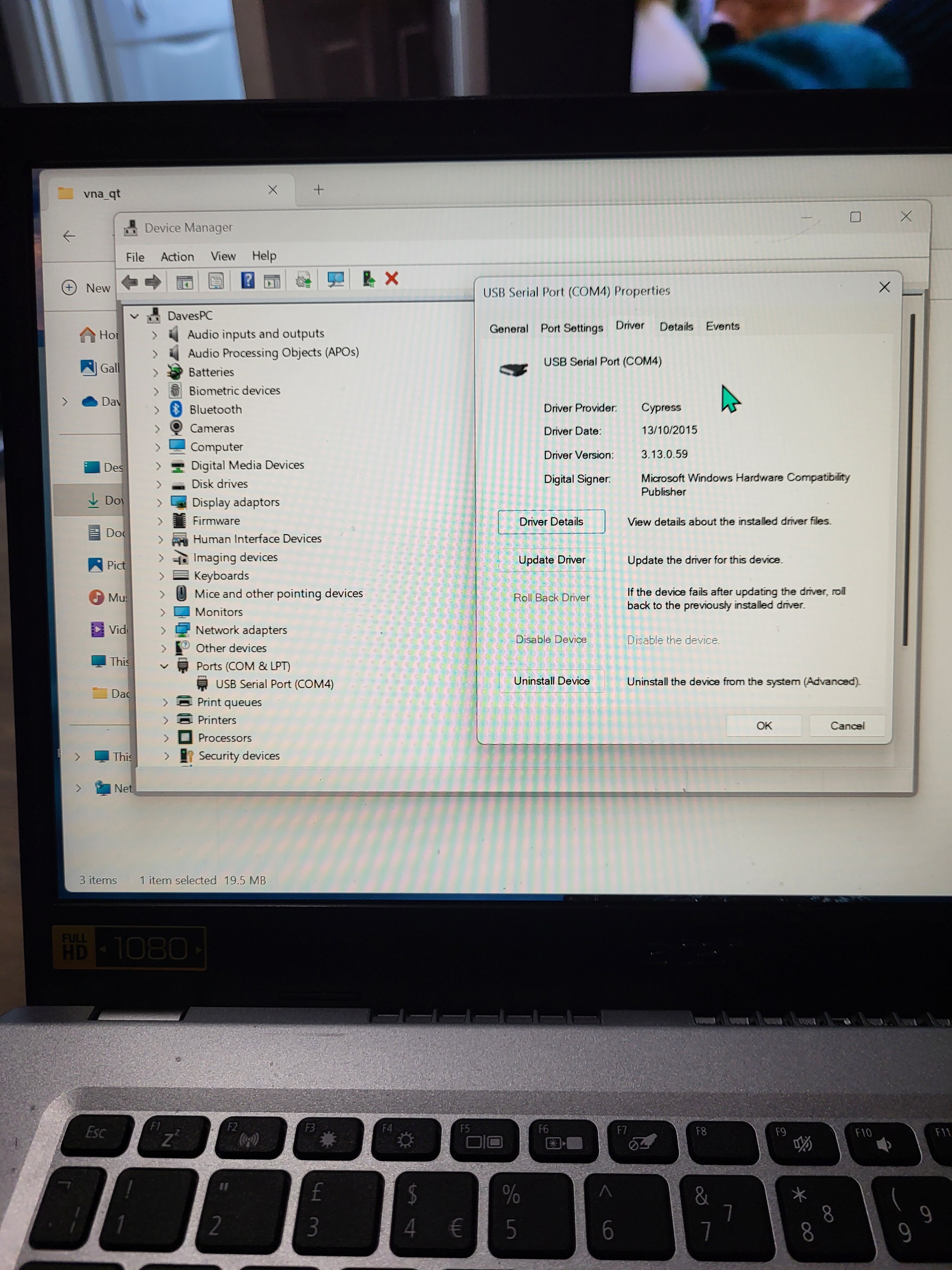

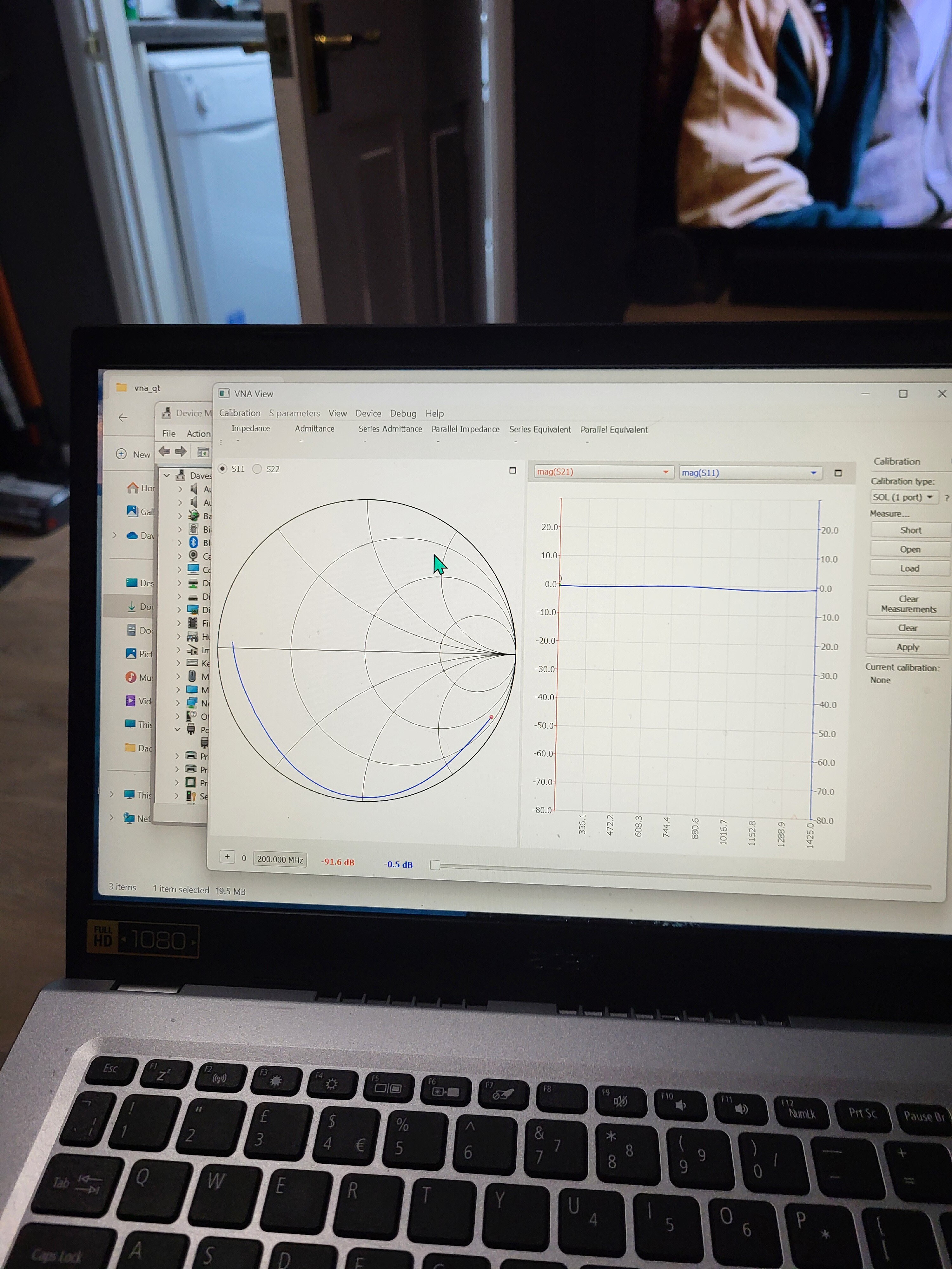

David Bradley 2025/06/03 21:56
Hi Jim sent shot of nanovna qt connected to my laptop and device manager
plus you will see it's a cypress driver ,I can also update firmware to my
NanoVNA v2 plus 4 hope this helps also works with Saver software too Dave

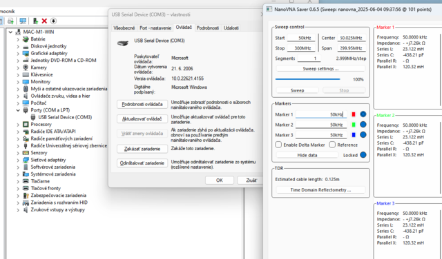

louma.jaroslav 2025/06/04 01:04
Nano saver ver. 0.6.5 is best then NanoVNA QT for NanoVNA V2Plus4 on WIN11-ARM (Apple computer - paralles ver. 20.3.2 on macbook M1 model 2020 16 MB RAM os Ventura) without any Cypress driver
On WIN 10 (Intel CPU no Apple computer) nano saver ver. 0.6.5 working with Cypress driver ...
On on WIN10-ARM (Apple computer - paralles ver. 20.3.2 on macbook M1 model 2020 16 MB RAM os Ventura) without any Cypress driver
David Bradley 2025/06/05 01:38
Well all I can say is mine works with saver software and qt software no
problems
