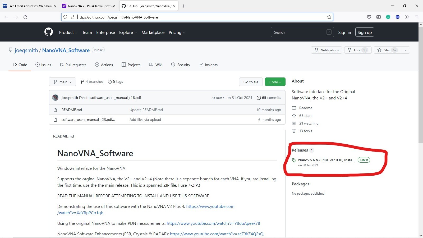

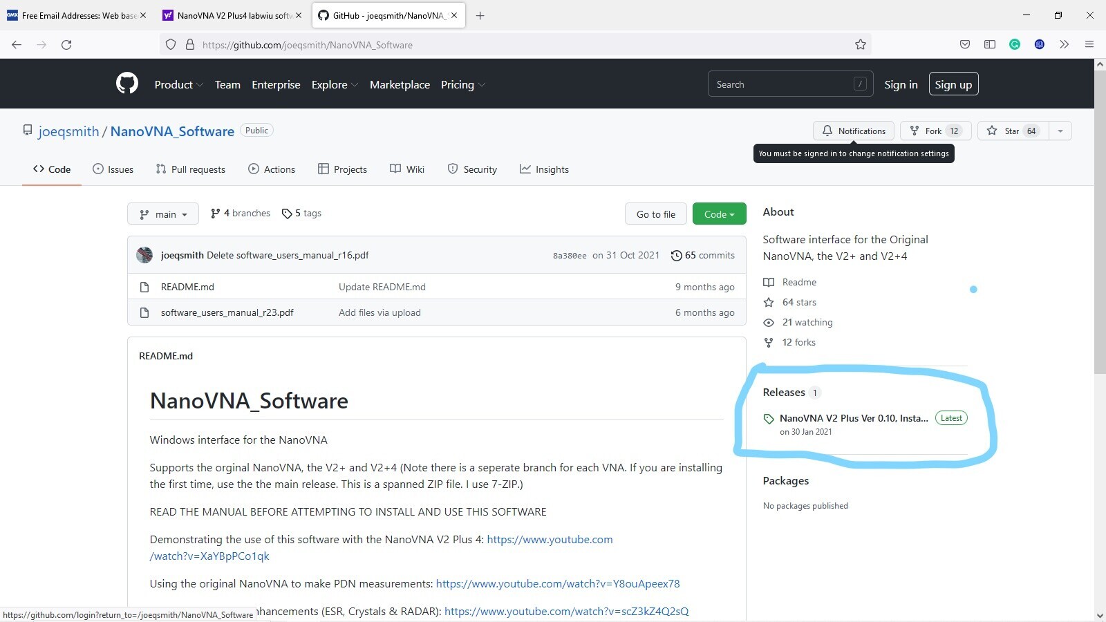

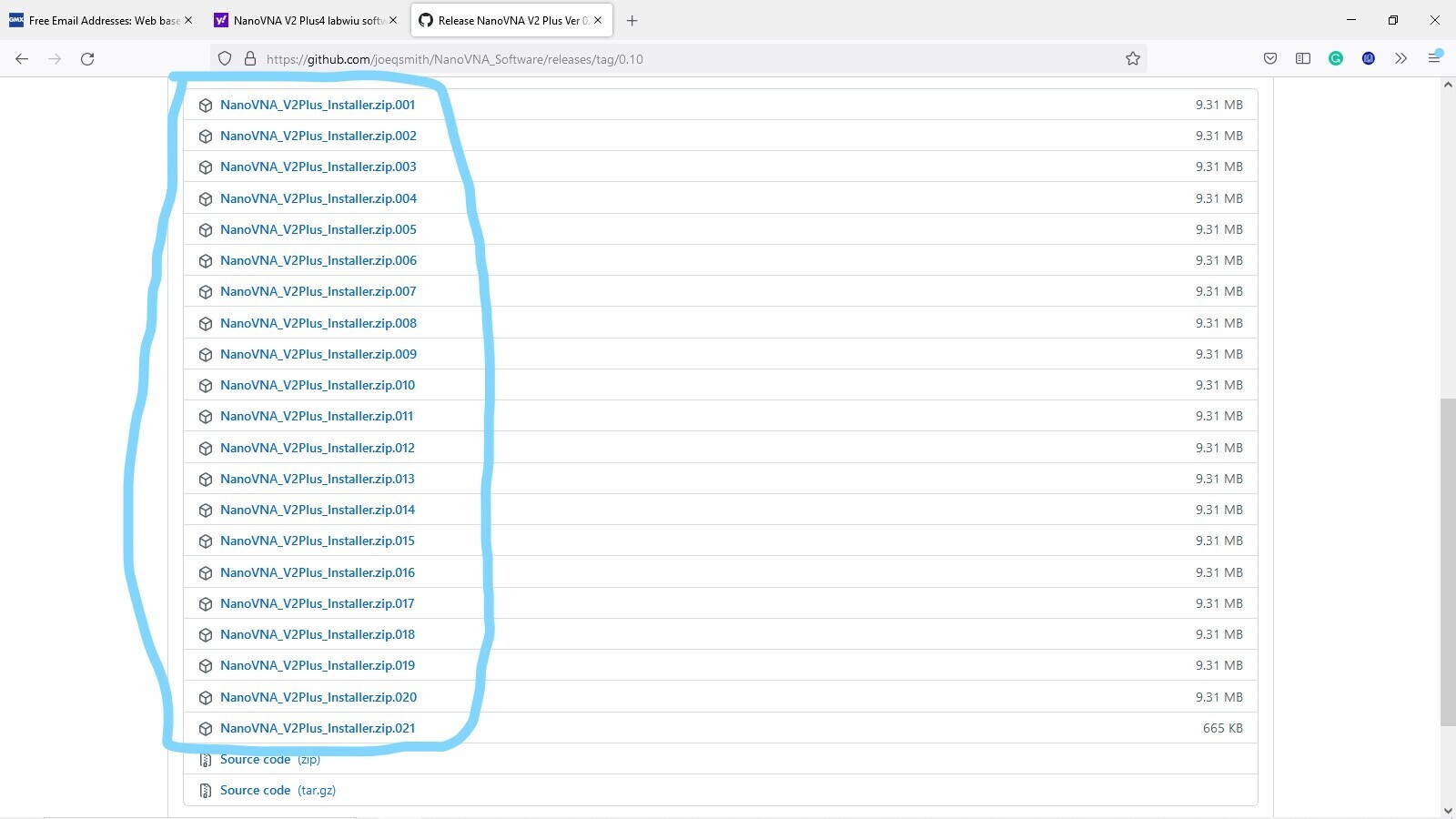

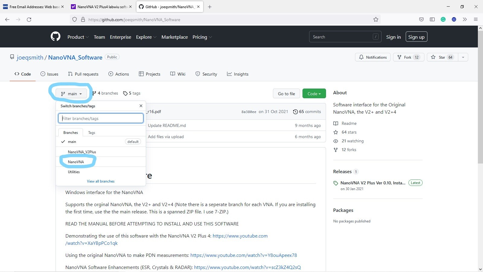

Francesco 2022/04/16 16:15
Hello the adress is this :https://github.com/joeqsmith/NanoVNA_Software
the 32 bit software still there.
See the attached picture.
First instoll the version 0.10 and afer on 3 you found the software for the
NanoVNA H

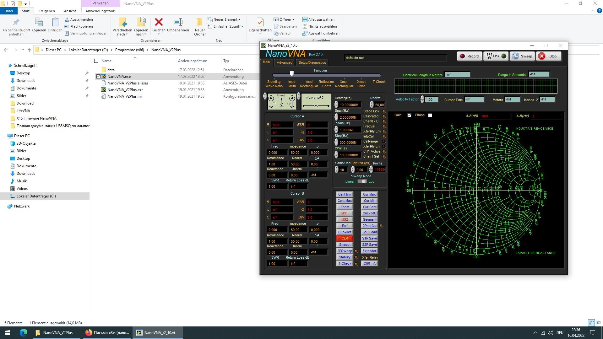

Vladimir Lebedev 2022/04/16 13:29
Brian,
https://github.com/joeqsmith/NanoVNA_Software/blob/NanoVNA/NanoVNA_original_2p10.zip - after installation of version 0.1.0 please unzip and copy this programm for nanoVNA-H to folder of main programm
https://github.com/joeqsmith/NanoVNA_Software/blob/NanoVNA_V2Plus/NanoVNA_V2Plus_2p08.zip - unzip for NanoVNA-V2Plus/Plus4 ---> to folder of main program
Vladimir Lebedev 2022/04/16 13:39

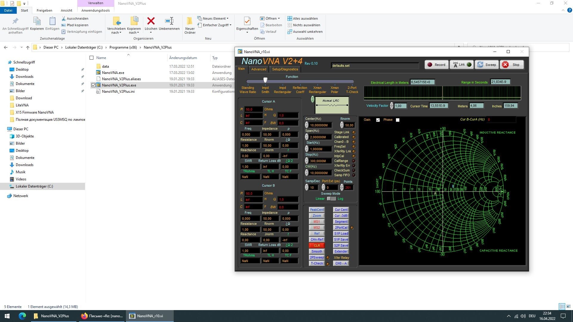

Screenshots from my computer.
