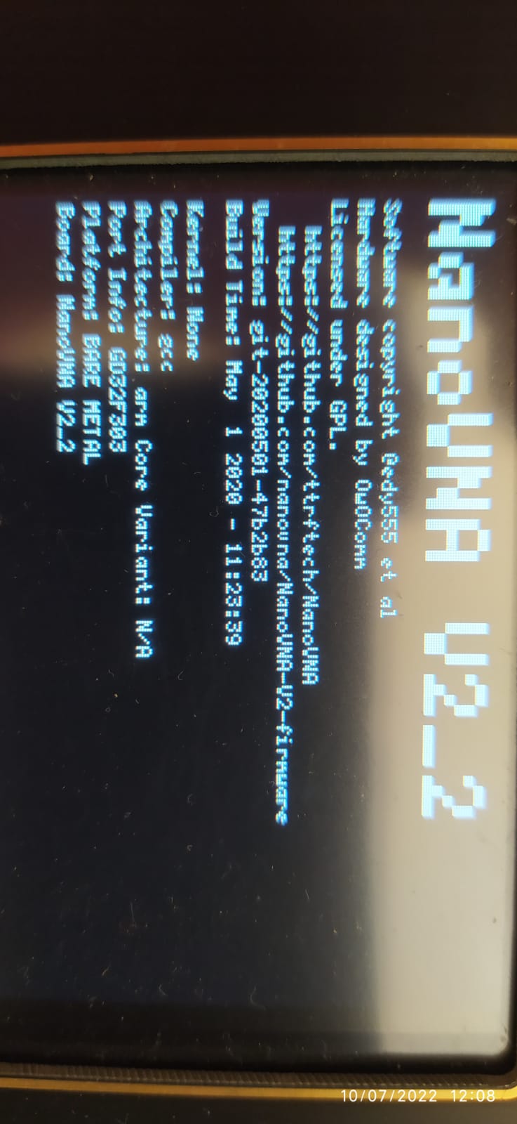

3. Your FW is very old. What a NanoVNA V2 have You - 2.8" or 4" display?
Ambro_IW2FVO 2022/07/10 20:53
thanks Vladimir for your kind reply.I did measure the display and it is about 3 inches diagonal.I am attaching the  photo here .Could you please indicate to me the procedure to update the nanovna FW ? I am not so skill!Thanks for all 73Ambrogio
