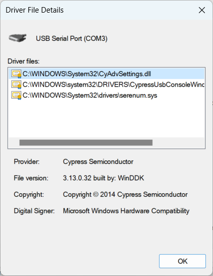

I discovered that my driver (working under Windows-11) was from Cypress.
David GM8ARV
