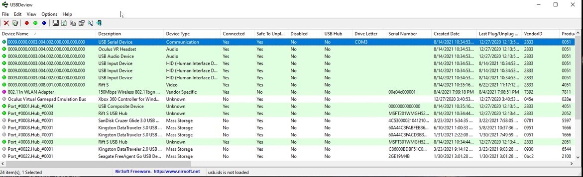

Hi, I found that Windows 10 does not release USB addresses even after the USB
device is no longer connected. I use a free software, USBDeview (found at
<http://www.nirsoft.net/> : scroll down to System Tools) to uninstall the
unused device: the next time it is plugged in it is again recognized. I
uninstall the devices that are show with the gray dot on the left. Hope this
helps
