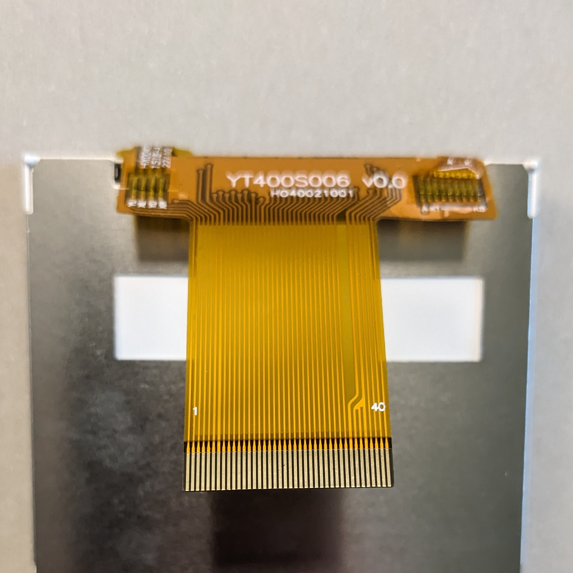

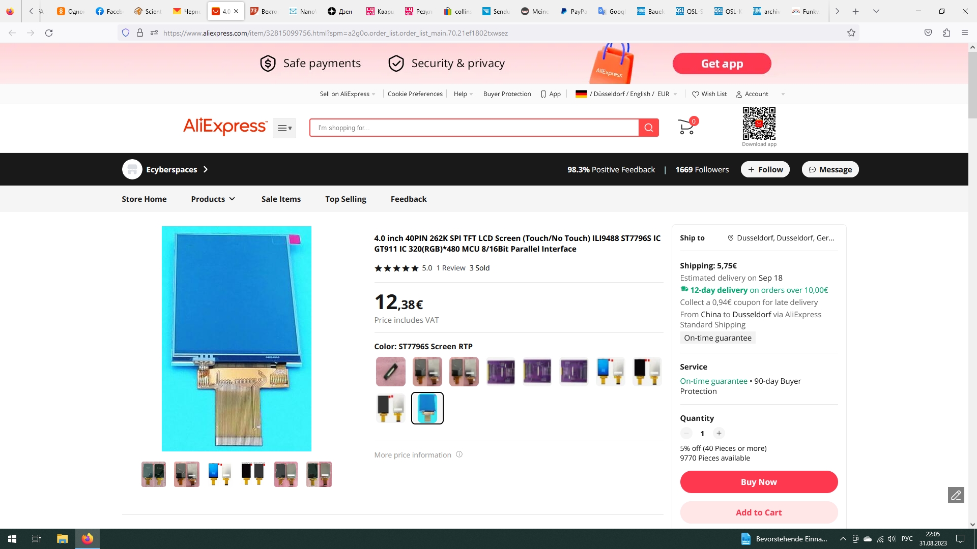

https://www.aliexpress.com/item/32815099756.html?spm=a2g0o.order_list.order_list_main.58.21ef1802prY4qZ
4.0 inch 40PIN 262K SPI TFT LCD Screen (Touch/No Touch) ILI9488 *ST7796S* IC GT911 IC 320(RGB)*480 MCU 8/16Bit Parallel Interface
Last picture - ST7796S with 40 pin and touch !!!
This display is built in NanoVNA-H4 / SAA-2N / NanoVNA V2 Pro (SAA-2 too)

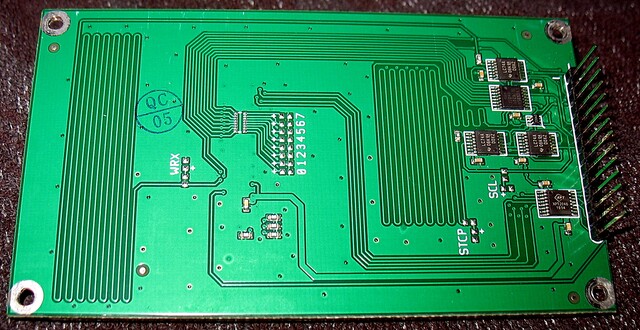

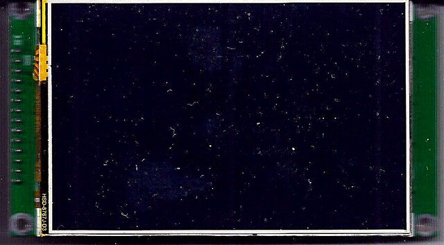

I have not got any place to buy a new display. Now I have taken some pictures for helping identifying my display. It have a marking HSD-6767J-D3, if it can help
/Åke Larsson

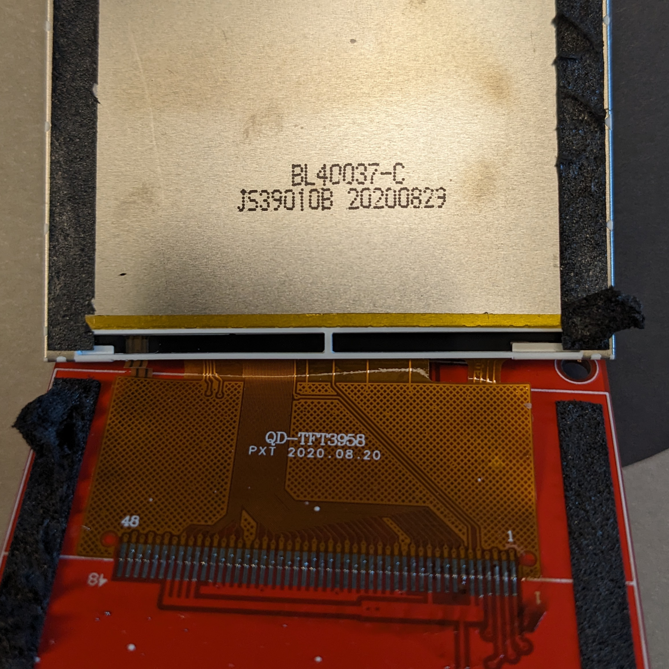

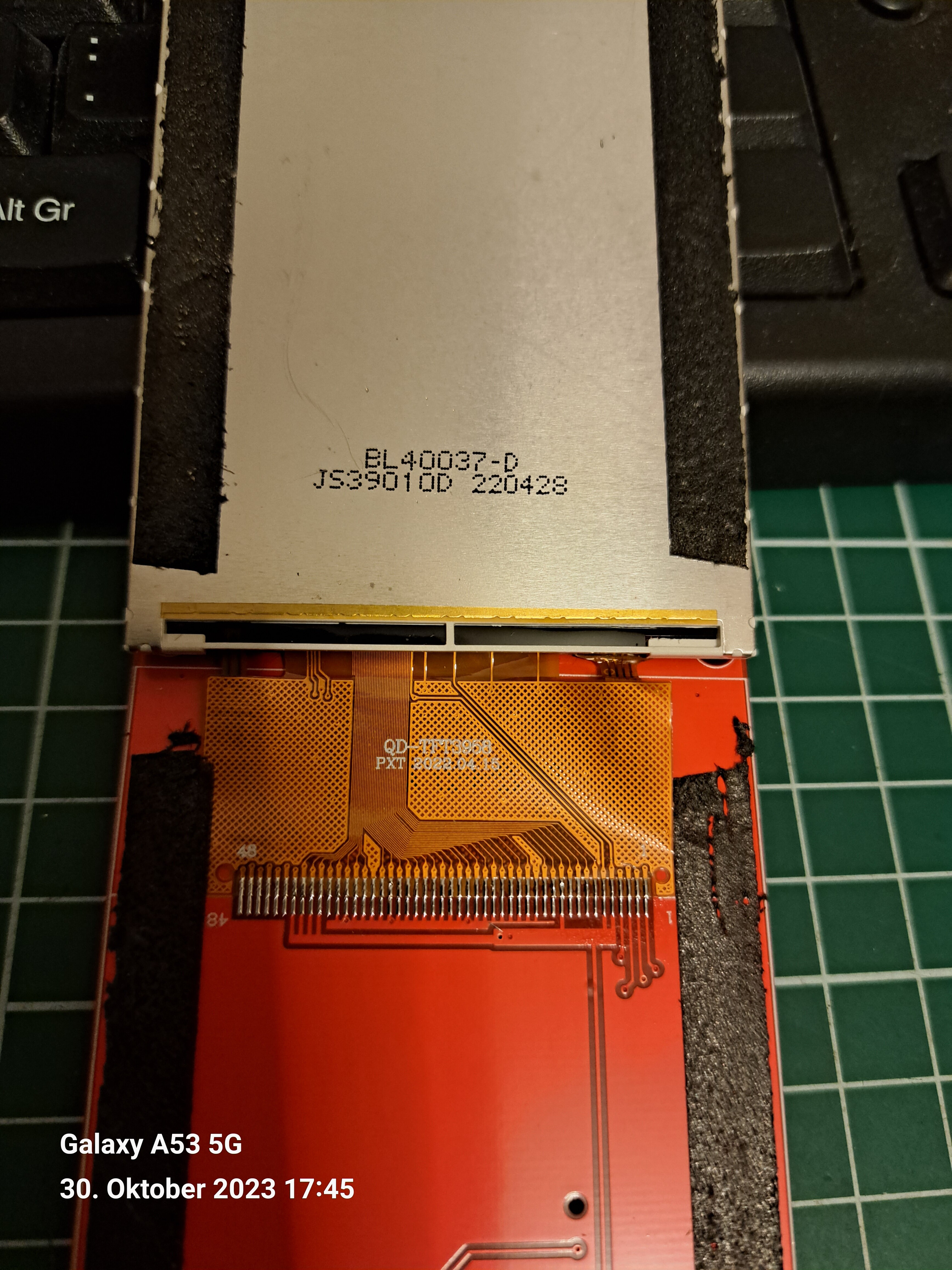

Sadly, it’s not the right one. I’m attaching two pictures: the original one (wide connector soldered to the PCB) and the AliExpress one (narrow connector).
I’m still looking for a true 1:1 replacement, could anybody help me out?

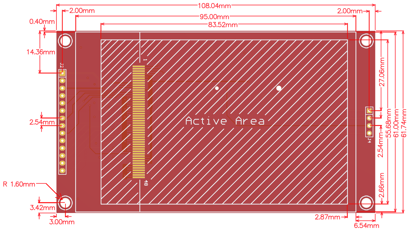

http://www.lcdwiki.com/4.0inch_SPI_Module_ST7796
Display driver ST7796S or ILI9486? Please ask by developer team http://nanorfe.com
http://www.lcdwiki.com/res/MSP4021/4.0inch_SPI_Schematic.pdf - 48 pin for soldering on a pcb
NanoVNA-H4 and SAA-2N have a 4" (3.95") display with 40 pin connector to plug in.
73! Vladimir, dl7pga
