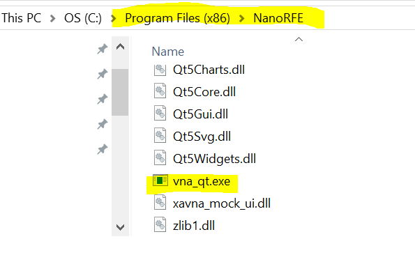

Mark Lund 2024/03/25 14:54
Hi Dave,
Thanks for the info.
I unzipped the files and placed them in
C:\Program Files (x86)\NanoRFE
Seems to work.
Mark

Dave (G1OGY) 2024/03/26 17:38
Seems that Ken is with me on this one, Mark.
And BTW, there are just two DLLs in the `release` folder of V1.1.
Those Qt5xxx DLLs in your print were needed for the previous version.
Judging from the size of the new EXE it would appear that all that
functionality is now compiled-in.
My "C:\nanoVNA-QT" folder has just the two DLLs and the EXE from V1.1
`release`.
