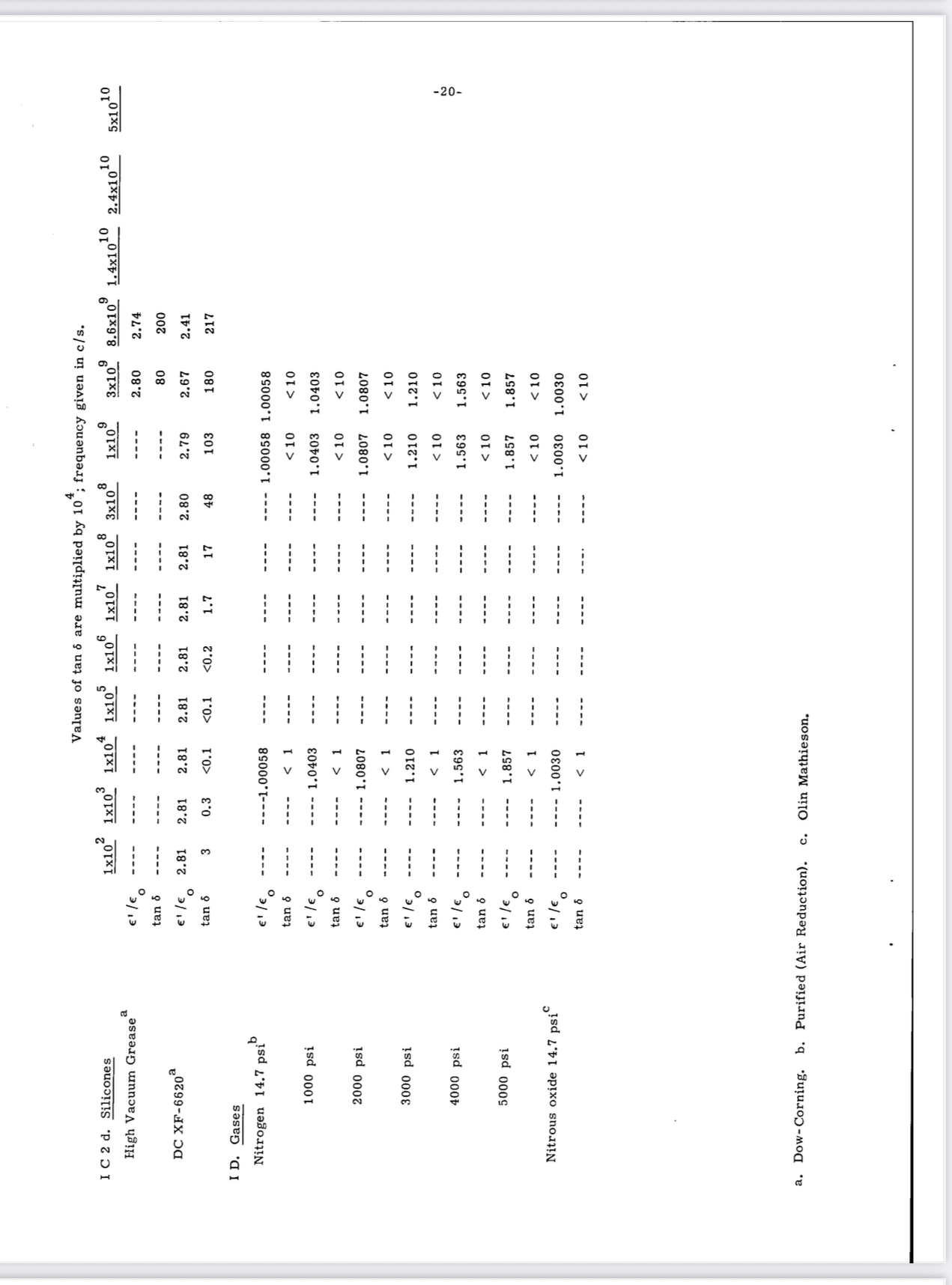

gary miller 2025/06/22 15:06
Please see attached reference and data for dry nitrogen.
![image0.jpeg](cid:mf_885EF53D-2AAC-44C0-A174-DDB12329F2E4/L0/001)![image1.jpeg](cid:mf_8DECC2A8-95E0-47B6-B01B-F55C99FF7AD2/L0/001)
