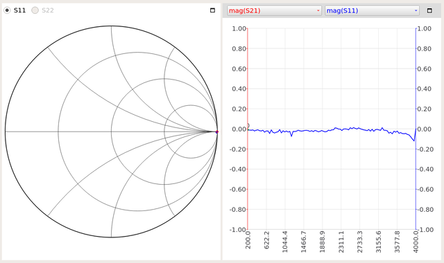

Hi, here's the V2 Plus4 measuring an open circuit after a 10 minute warm up. Calibration was performed when the device is cold.

Thanks much … this is useful for my intended purposes for this device.
