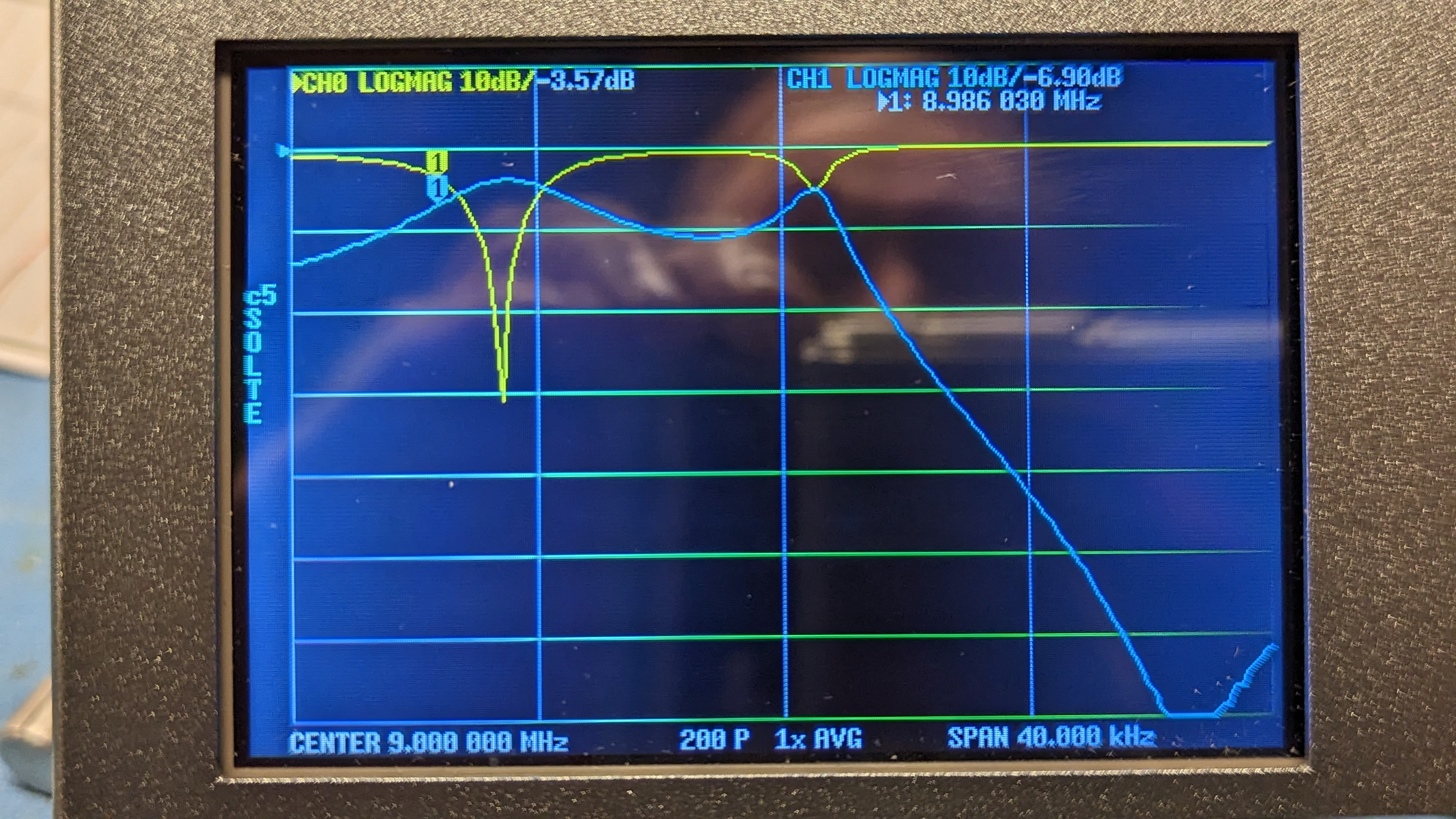

Mark, that is exactly a question I had and your answer helps.  A quick follow on to throw out to you - exactly what resolution (frequency-wise) were you able to obtain?  E.G. could I scan a 9 MHz SSB filter and get a good data set.

Hi Bob,
The quick answer is yes. The bandwidth currently has a minimum setting on the screen for 800 Hz. I am told they are working on a future FW update to take that lower. But even at 800 Hz, I was able to nicely sweep my 6 kHz crystal filters. The only picture I could find was when I was developing a 15 kHz filter. It was a work in progress but at least will show you what to expect.
The other option you have is to use the free NanoVNA SW with your computer attached and then you have the option of down to 100 Hz bandwidth. I did some comparison with a commercial VNA in the lab and everyone was very surprised how good the Pro performs.
Please see photo attached and hope this helps you make an informed decision.

Sorry everyone, I read my text after it was posted. Using the NanoVNA Saver software you can achieve a 10 Hz Bandwidth with the Plus 4 Pro.
