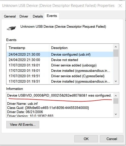

I tried to use V2 with PC, but i cant install drivers.
Device hardware id is incorrect: VID_0000&PID_0002
Driver is not installed.
How to solve this?

of course i did it. I tried to manual update driver after. Nothing. I suppose the device does not have correct device id and windows cant recognize wich driver should be used.

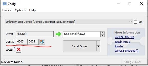

Also i tried manual install driver by Zadig. Zadig reports error that device with this id has already used. Please see the screen usb ID section. I think the problem is the device flashed icorrectly with no hardware ID.
cyberalan71 2020/07/24 13:53
screen

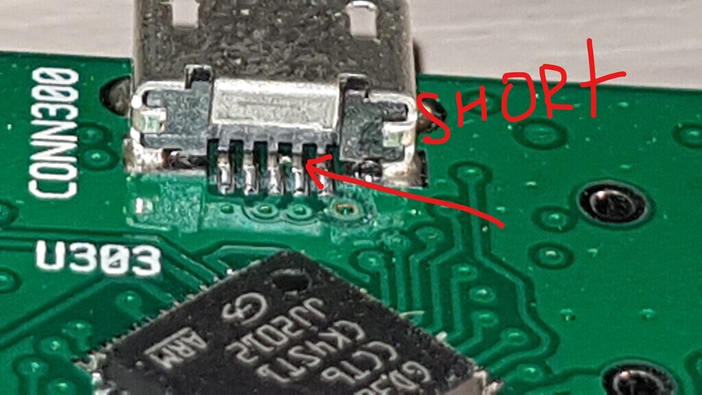

I found the problem!
There was short circuit between d+ and d-.
I resoldered usb socket and problem has gone.
