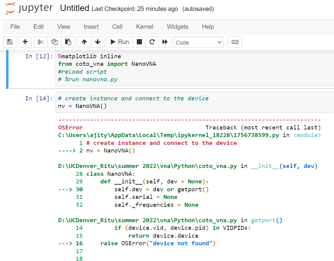

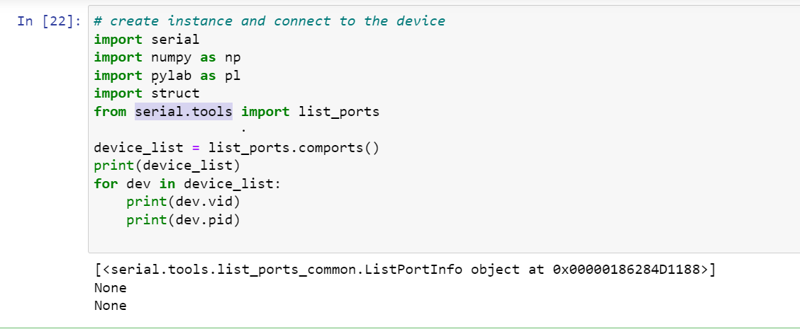

Hi Members,

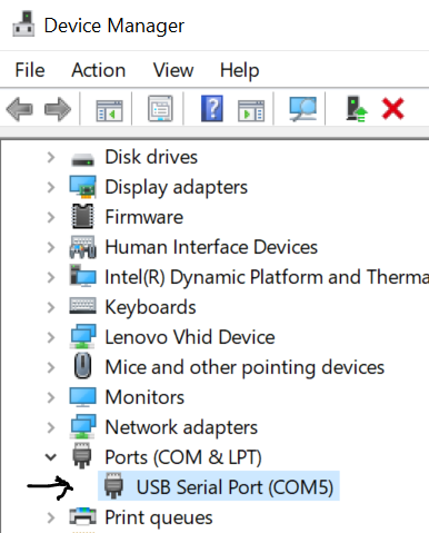

I have started working on Nano VNA V2 plus4. I want to communicate with Nano VNA using Python. I tried this python code for connection https://github.com/ttrftech/NanoVNA/commit/69a55c8b7e413b70fdbdc04436c84dd79a6b598a with my VNA but I am not able to get com port information even though I am connected to VNA under COM5 port (as shown in device manager attachment). How do I read active COM port using python script?
Can anyone help me with the connection of Nano VNA using Python Script?
