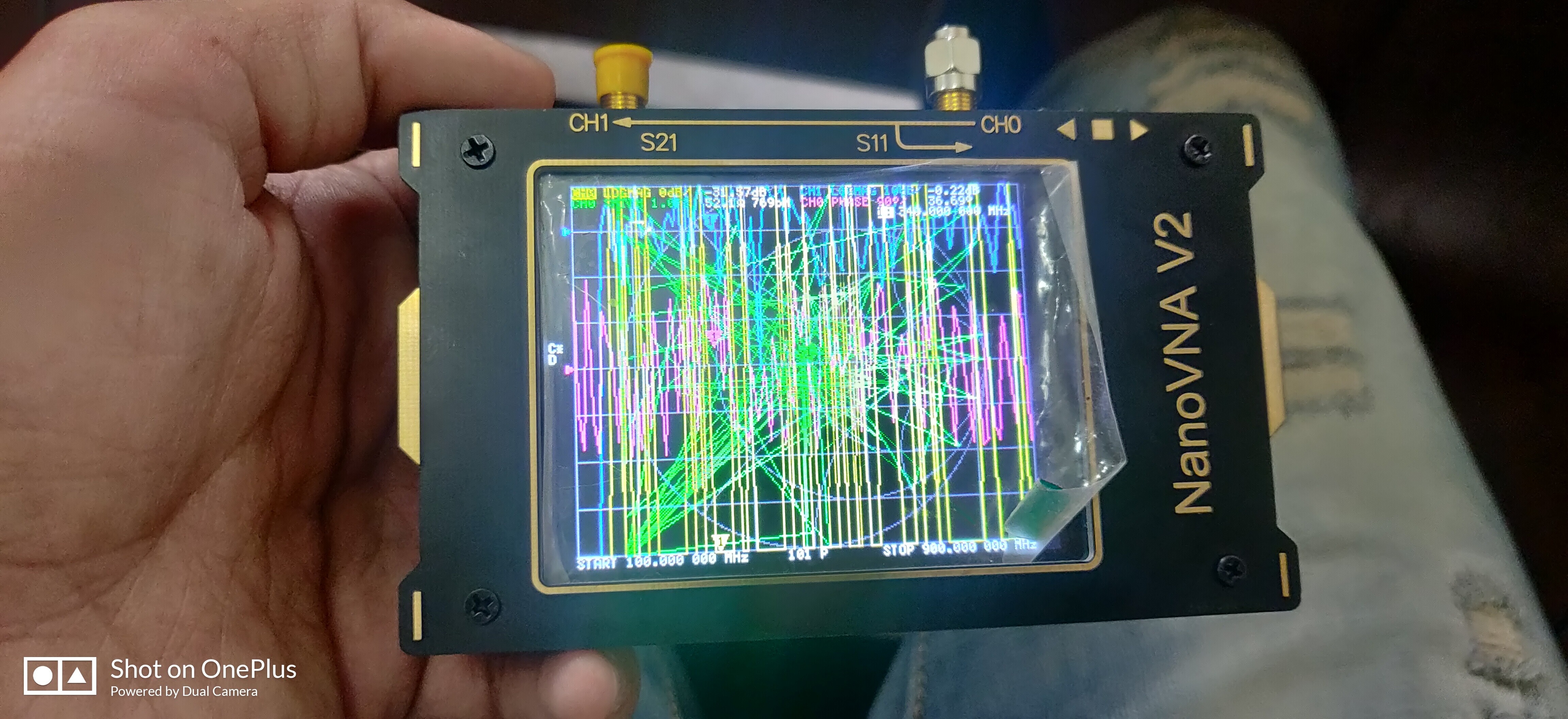

sir please help me my nanovna V2 have too much noise what happen to it. Sir
please tell he how can i fix it

You have not calibrated properly. You can tell by the left hand side of the screen it only has CD.
Carefully follow calibration instructions.

sir i have calibrated properly and my USB cable also work properly but there is no effect on nanovna v2. sir please tell me how i fix this noise
I think I see a LOGMAG scale of 0dB per division. Maybe just a scale configuration?
Faheem, Change the shorting/load sma!
