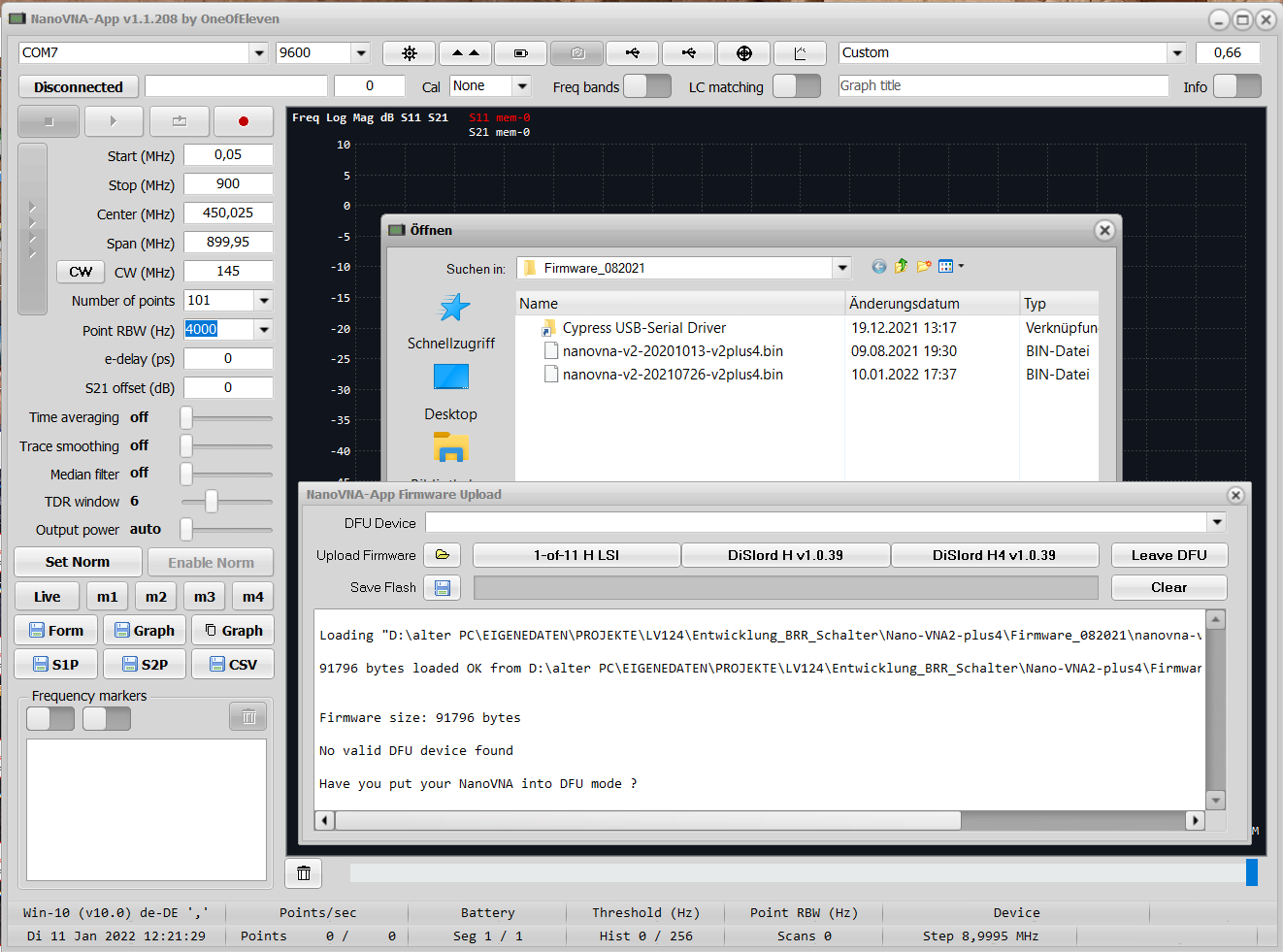

Albrecht Debelak 2022/01/10 19:56
Hello everyone,
I bought a new NanoVNA V2 pus 4.
Unfortunately I cannot update the FW because my NanaVNA-QT SW keeps
crashing.
The nanovna-saver SW V 3.10 also crashes.
The USB driver from Cypress is installed and the USB interface is
correctly recognized.
Operating system PC: Windows 10
FW NanoVNA V2 pus 4: 20210530 -> latest stable version
nanovna-v2-20210726-v2plus4.bin
NanaVNA-QT SW: 05.2020In the end I didn't want to use the ST Tolls for
downloading.
Do you have an idea how I could update the system.
Greetings and thanks
Albrecht

Kenneth Goodwin 2022/01/10 15:17
I find it odd/confusing that none of the external software interfaces (Nano vna_qt, NanoVNASaver) provide any means that I can find to check the device's firmware.  NanoVNASaver version 0.3.10 states NanoVNA Firmware Version: NanoVNA-V2 v1.0.2 I have no idea what this is telling me since nanovna-v2-02210726-v2plus4.bin loaded Version: git-20210530-412578c Build Time: Jul 26 2021 With this pick-any-file-name protocol, the only meaningful delimiter seems to be the date associated with the firmware even though 0530 produced 0726.  I also find all the different hardware versions of device confusing.  Always looking for divine intervention, maybe that is what the Saver program is trying to tell me, i.e., NanoVNA-V2 isn't NanoVNA V2Plus4.
Albrecht Debelak 2022/01/11 20:20
Hello Vladimir,
thank you for your valuable tips and the SW.
Unfortunately it doesn't work with the software "NanoVNA-App" to connect
to the NanoVNA-V2Plus4 and so I can't download a FW.
I followed your description exactly.
As you can see, the interaction (protocol, timing) between the firmware
and the device "NanoVNA-V2Plus4" (on my device is the FW
git-20210530-412578c)
and with the Windows10 operating system, which works with the Cypress
drivers and with the different application software variants NanaVNA-QT,
VAN-Saver, NanoVNA-App not compatible.
It is very frustrating for me to try so helplessly all the variants with
several PCs.
As others have already written, this is also the case with other users.
Greetings from Germany
Albrecht
