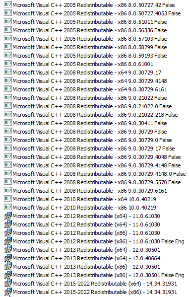

Visual C++ installed

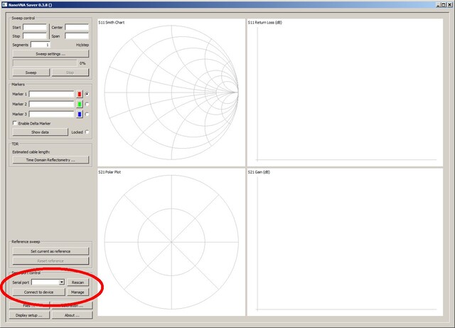

Com port not detected at all in the Saver app:

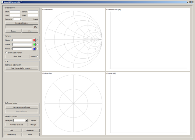

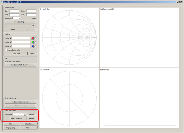

I can run the Saver app till 0.3.9 but not conect to the device (from the 0.4.0 version just run under win10)
refresh not help...

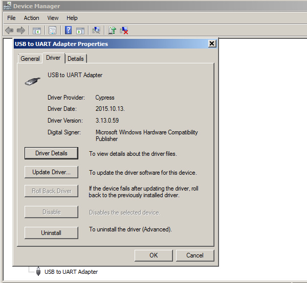

I resolved a similar problem with Win10 PCs by removing the Cypress drivers and allowing native Microsoft drivers to load instead. It might be worth a try. Good luck.

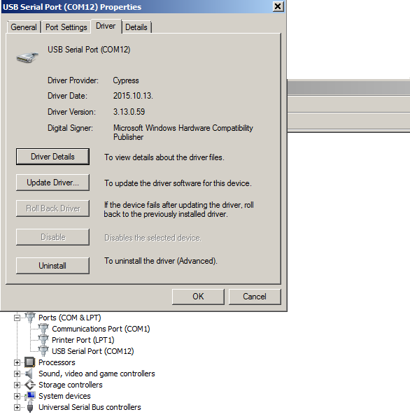

Istvaan 2022/11/27 20:54
Now the device on the Com3 port; and the probleme is the same...
Istvaan 2022/11/27 21:17
Win7 not have native driver for this device
(if I disable the online driver search and uninstall and delete all the cypress drivers not working under NanoVNA-QT too)

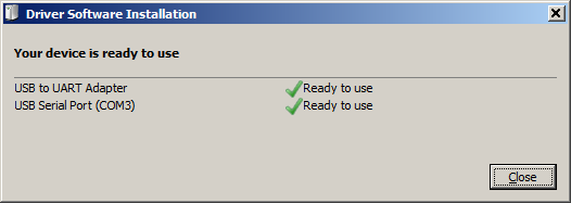

In the device manager: "CDC-ACM Demo" is the first recognised device and then installing two drivers (from online database or previously installed (CypressDriverInstaller_1.exe) - if I allow ... or I won't stop)
this picture from the probleme is not wisible anymore after edited the first post, so I upload it again:
