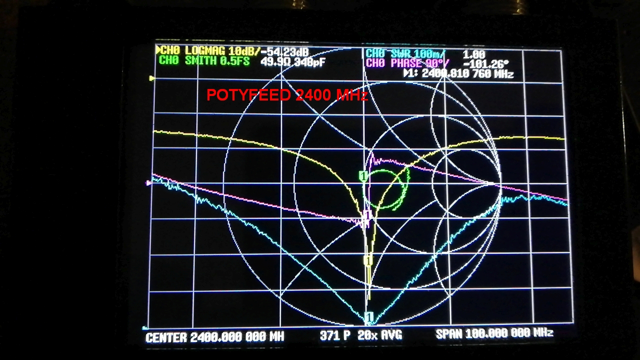

Siegfried Jackstien 2023/04/18 19:09
an example?? ( i could give the pic a different name but it is what it
is ... "poty-feed" for 13 cm .. qo100 uplink)
dg9bfc
