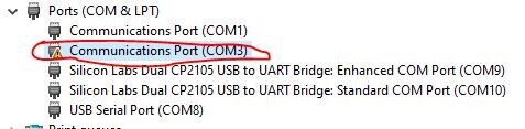

Rasika Liyanage 2020/08/04 06:10
manually added port

Rasika Liyanage 2020/08/05 04:46
On Wed, Aug 5, 2020 at 12:12 PM, MarkZ wrote:
> cypress driver
Hi Mark
You nailed it. Issue was with the cypress driver. It was classed with my Amp's USB serial port. Uninstall the reinstall the cypress driver, and assigned a new port number. Bingo it worked. Thank yo so much for the direction.
