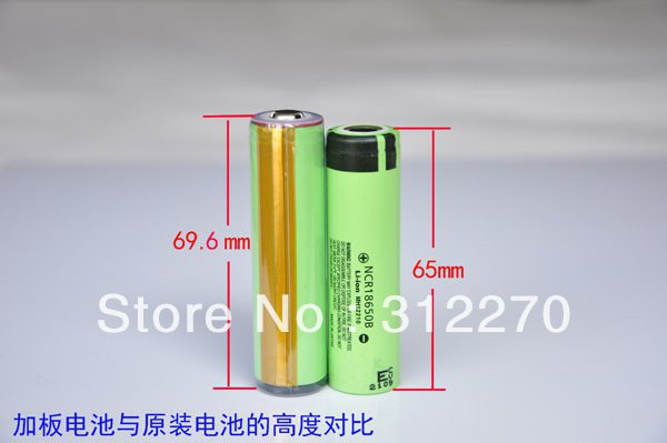

There are shipping restrictions on lithium batteries. That is why they are
not included. There are several battery vendors you can buy the battery
from that are setup to ship them. Note that battery comes in two form. One
with a protection circuit and without. The protection circuit makes the
battery a little longer so the battery holder has to be a little longer.
One of the VNA I have have uses the shorter non- protected battery. I
noticed the circuit board had holes for either battery holder and room for
the longer one.

István 2023/08/09 13:43
18650 Li ion?
exactly
vape shop selling protected (- many vape device require requires it not to explode) type that is not fit into nanoVNA:
