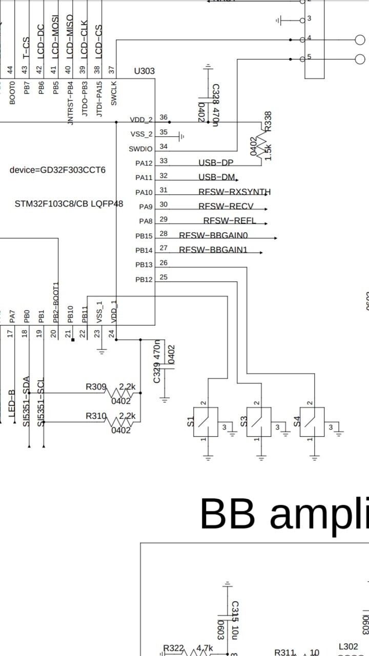

Received my NanoVNA V2Plus4 yesterday from the official source.
Unfortunately, 2 of the three buttons do nothing, that is, they have no effect in any screen.
Is this common? Is there any easy fix outside of returning it or replacing the board? Maybe touching up the solder points?

Vospol'zuytes' skhemoy ot V2, protsessory odinakovyye s V2plus4, tri knopki idut napryamuyu v protsessor.
Vse prosto!:)
Proverte testerom, srabatyvaniye knopok, na kontaktakh protsessora i zemlyanogo poligona.
Use the circuit from V2, the processors are the same as V2plus4, three buttons go directly to the processor.
It's simple! :)
Use a tester to check the operation of the buttons on the contacts of the processor and the ground area.

I contacted the seller through Tindie and they almost immediately responded with the suggestion that I could check the soldering on the board or they would send me a replacement board.
I checked the board and found that 5 of the 6 pins from the switches had not been soldered at all, and the one pin that had been soldered had very little solder on it.
So I soldered the pins to the board and they now work. The problem is solved.
