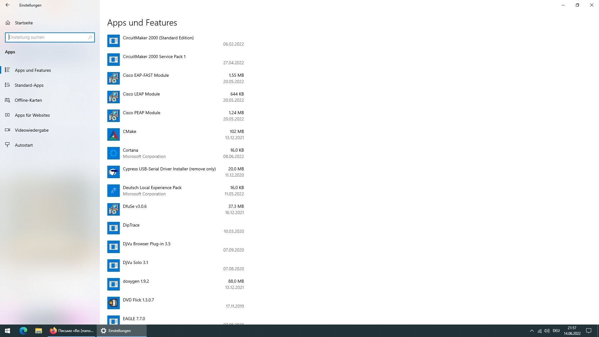

Vladimir Lebedev 2022/06/14 13:02
Hello gouzu82!
It is very easy. See this picture - Windows 10 Control Panel ---> Apps & Futures
Sypress driver uninstall only.
Best regards
Dave VE3TLY 2022/06/14 13:22
Thanks. I tried that but it didn't work here. I too have Win10 home 64-bit machines.
