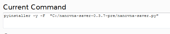

Gyula Molnar 2020/07/28 12:57
[Edited Message Follows]
Hi Mark Z,
Thanks for the help.
I tried and I was able to create one file.
The auto-py-to-exe module uses the same pyinstaller. *
73, Gyula HA3HZ

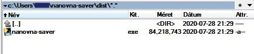

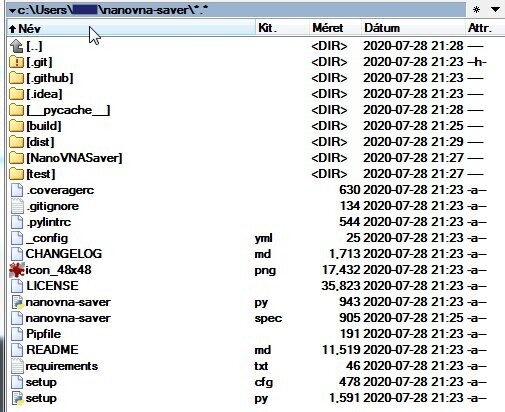

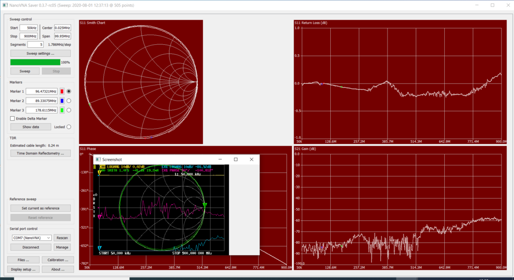

Gyula Molnar 2020/07/28 23:53
That's right ... there's only one file, but it's bigger.
The two pictures show you make from this and you made this.
ps.: I just quietly note that I don’t need this because Python runs under Windows, it can be started right away.
I’m only talking to those who only have a Windows 32-bit machine because they can’t use the latest nanovna saver.
Since I didn't have to install it just to test it, I tried it.

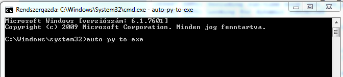

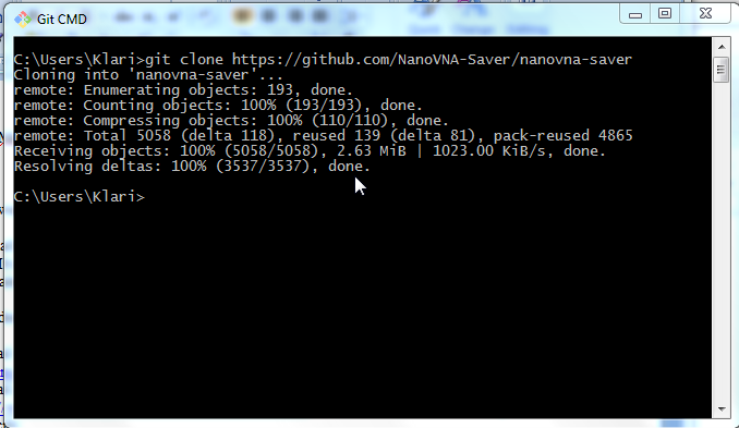

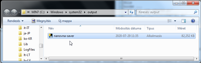

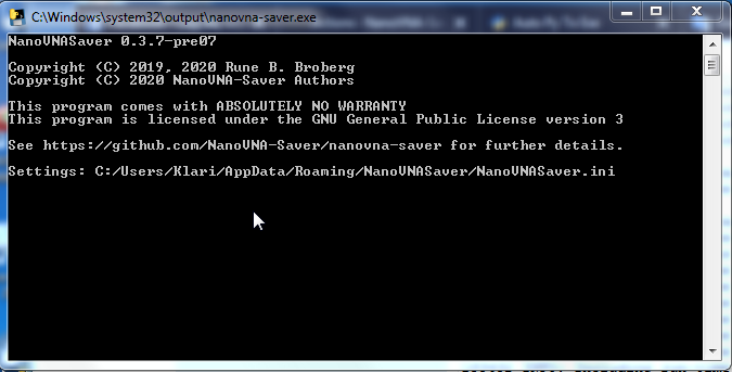

Gyula Molnar 2020/07/29 03:07
Today I tested the v0.3.7-pre07 version of the nanovna-saver on github with "auto-py-to-exe".
This module uses the pyinstaller command, so the end result must be found in the output folder.
I did this using Python 3.7.4 and Git previously installed on a Windows7-32 bit machine.
The final .exe file can be run without Python.
73, Gyula HA3HZ

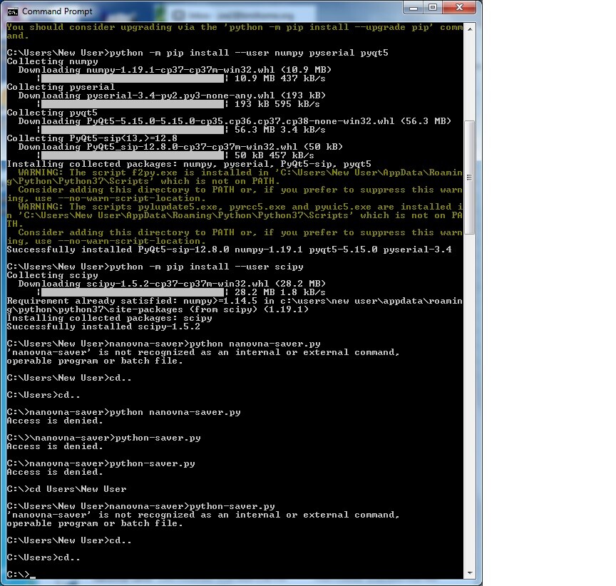

Joe Joncas 2020/07/31 15:05
Hello everyone,
I have to agree with Gary on this one. Please, please, please create a 32 bit version. I have been following all of you for about four months. I see great things being worked on and discussed, but, I only understand about 1/3 of it. For many years I was a “power user.” I used and created data bases, spreadsheets, used word processors and created newsletters. But, I did not create those programs. I like observing at this level but I’m not any good at it.
Recently, I asked for some help installing Saver on a 32 bit machine. I got several good responses especially from Gyula. (By the way, great website Gyula.) He gave me step by step instructions. Actually I made good progress on installing Python and Saver on my machines. However, I got to the end and it would not work. See the following:
The above was my second attempt. I also tried on my shack computer with the same results.
Found too many “Access is denied” messages. I’ve gotten over being frustrated. I have been through a very stiff learning curve, but I am stuck again. I would appreciate some help getting beyond this obstacle.
But, here is the point. I bought a nanoVNA to use it. I expected to get the device, download the software and put it to use. For years I have had a miniVNA that I did just that with. I have literally spent weeks trying to install the software. (I’m 73 years old and need a bigger screen) When Gary sent this email he was looking for someone to create a 32 bit version. I think he is like me and does not have the skills to work at that level. I tried and failed. Some of you responded that he should just download another program and create a 32 bit version. I barely have an idea about what that means much less doing it. For some of you it appears that creating a 32 bit version would not be that difficult. Please do. (For the nanoVNA-H and the nanoVNA-V2)
Thank you for your time,
Joe

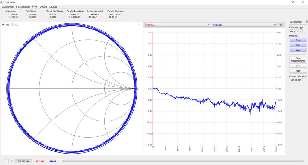

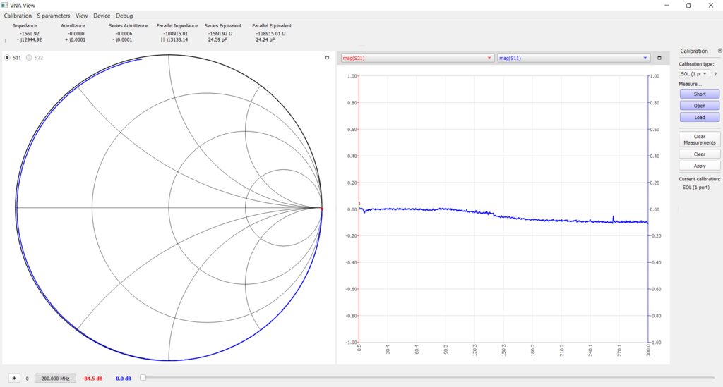

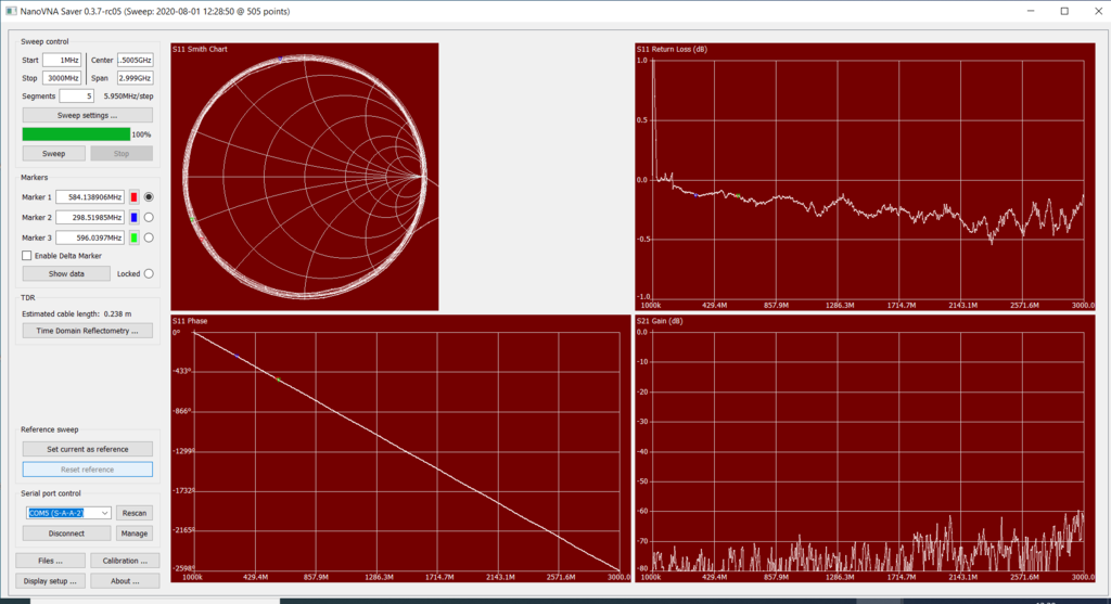

Kurt Poulsen 2020/08/01 12:52
Hi Holger
Thank you for the link. I work fine apart from the first measurements are not correctly made
See attachments
Kind regards
Kurt

Holger Müller 2020/08/01 13:13
Hi Mark,
On 01.08.20 12:56, MarkZ wrote:
> I'll commit to spending some time this week working on the 32 bit
> build/checking on Github.
I've done already
see
https://github.com/NanoVNA-Saver/nanovna-saver/actions?query=workflow%3A%22Windows+Release%22
Holger, DG5DBH

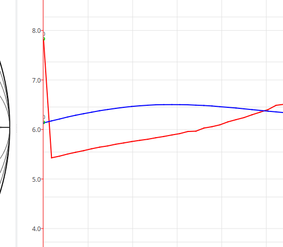

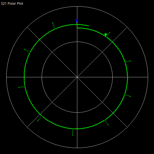

Kurt Poulsen 2020/08/01 14:12
Hi Holger
Could you please have a look of what is wrong when more than one segement used or if in "Manage" the number of points selected are above 101 points (the alternative way instead of using number of segments). The problem is that then the first measurement is way off.
Kind regards
Kurt
Holger Müller 2020/08/01 15:03
Hi Kurt,
On 01.08.20 12:52, Kurt Poulsen wrote:
> Hi Holger Thank you for the link. I work fine apart from the first
> measurements are not correctly made See attachments Kind regards
I don't get the point, what's exactly wrong with first measurments?
Do you mean the first sweep which is taken?
Can you give me some more precise information?
Holger, DG5DBH

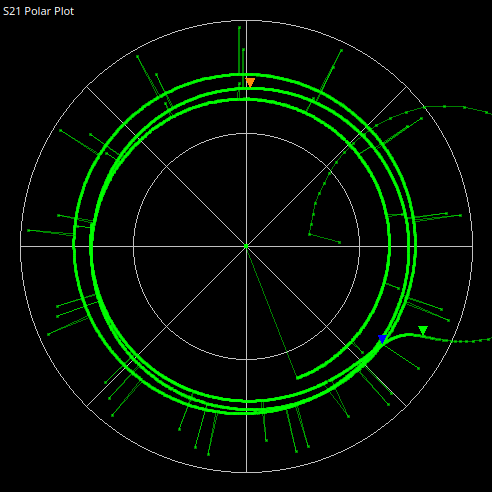

Kurt Poulsen 2020/08/01 16:20
Hi Holger
No, if you look closely on the sweep of the UT141A rigid line at the very first point at the start frequency it is placed well above the 0 dB level where it should start. Then one step from start frequency (measurement point 2) then it correctly running from this point onwards correctly on the 0dB line. That only happens when more that one segment or in the "Manage" you choose the customer points beyond 51 or 101. For measurement points at or lower than 101 the first measurement point is spot on 0dB.
Kind regards
Kurt

After installing Python and the modules then exit "cmd" mode.
Download the "Source code.zip" of the latest version from the nanovna-saver release page. link: https://github.com/NanoVNA-Saver/nanovna-saver/releases
Unpack this to drive C: / as administrator.
Then use a file manager to access the C: /nanovna-saver-0.3.6 directory (or the name you downloaded). Click nanovna-saver.py to start it. A small window will appear, after which the program itself will log in. I think maybe you may have made a mistake here that you wanted to boot from the "cmd" window.
Please reply, if it still doesn't work, I'll try to help.
73, Gyula HA3HZ

Gyula Molnar 2020/08/01 08:29
Hi Joe,
OK, it will go, you just gave the start command in the wrong place.
73, Gyula HA3HZ
Hi Joe,
Download the "source.zip" of the latest version from the nanovna-saver release page. link: https://github.com/NanoVNA-Saver/nanovna-saver/releases
73, Gyula HA3HZ

Holger Müller 2020/08/01 18:09
Hi Kurt,
Wow, that's a good hint. I've seen this first displaced first point
in each segment before, but I don't found out why.
I suspect a firmware problem... but I haven't looked with lower point
count till now. As far as I know and what I've seen from -H4 Charts
with 201 points, it happens only with the V2.
That's a good hint to look at ...
Thanks!
Holger, DG5DBH
Kurt Poulsen 2020/08/01 22:00
Hi Holger
Right that is only with the S-A-A-2 and Hugen S-A-A-2_2
I attach measurement made by the SA_QT software which does not shown any funny behavior apart for very small deviation at the very low frequencies
Kind regards
Kurt
Holger Müller 2020/08/03 10:30
Hi Kurt,
On 01.08.20 22:00, Kurt Poulsen wrote:
> Hi Holger Right that is only with the S-A-A-2 and Hugen S-A-A-2_2 I
> frequencies Kind regards Kurt
see my attached screenshot of an uncalibrated scan with VNA_QT
from 0.5M to 300M with approx. 40cm of RG58.
Also that deviation... no matter which point setting...
No problems with frequencies > 30M at all..
Holger, DG5DBH
OwO 2020/08/03 16:43
The deviation is because of the coupler design, which relies on a pair
of baluns to extract a difference signal. Baluns are not effective below
a few MHz, which the firmware corrects for but some deviations remain.
After calibration the deviations should be gone.
Holger Müller 2020/08/03 10:59
Hi Gabriel,
Yes, calibration works.
There were sometimes phase jumps in the very first sweep point on the
S21 value.
The picture is with 10 segments on NanoVNA-Saver.
It's always the first value, regardless of point count and so on,
do you have an idea, where this can result from?
Holger, DG5DBH
OwO 2020/08/03 17:06
Looks like stale data are getting in. After setting sweep parameters the
software needs to clear the on-device FIFO and discard at least one more
point. I'll take a look at the code in the new nanovna-saver.
Holger Müller 2020/08/03 11:11
Hi Gabriel,
> S21 value.
sorry, not the phase, the magnitude of first meassured S21 Point
is always to high.
Can be seen on S21mag (or better on S21vswr) graph in vna_qt, too.
Holger, DG5DBH
