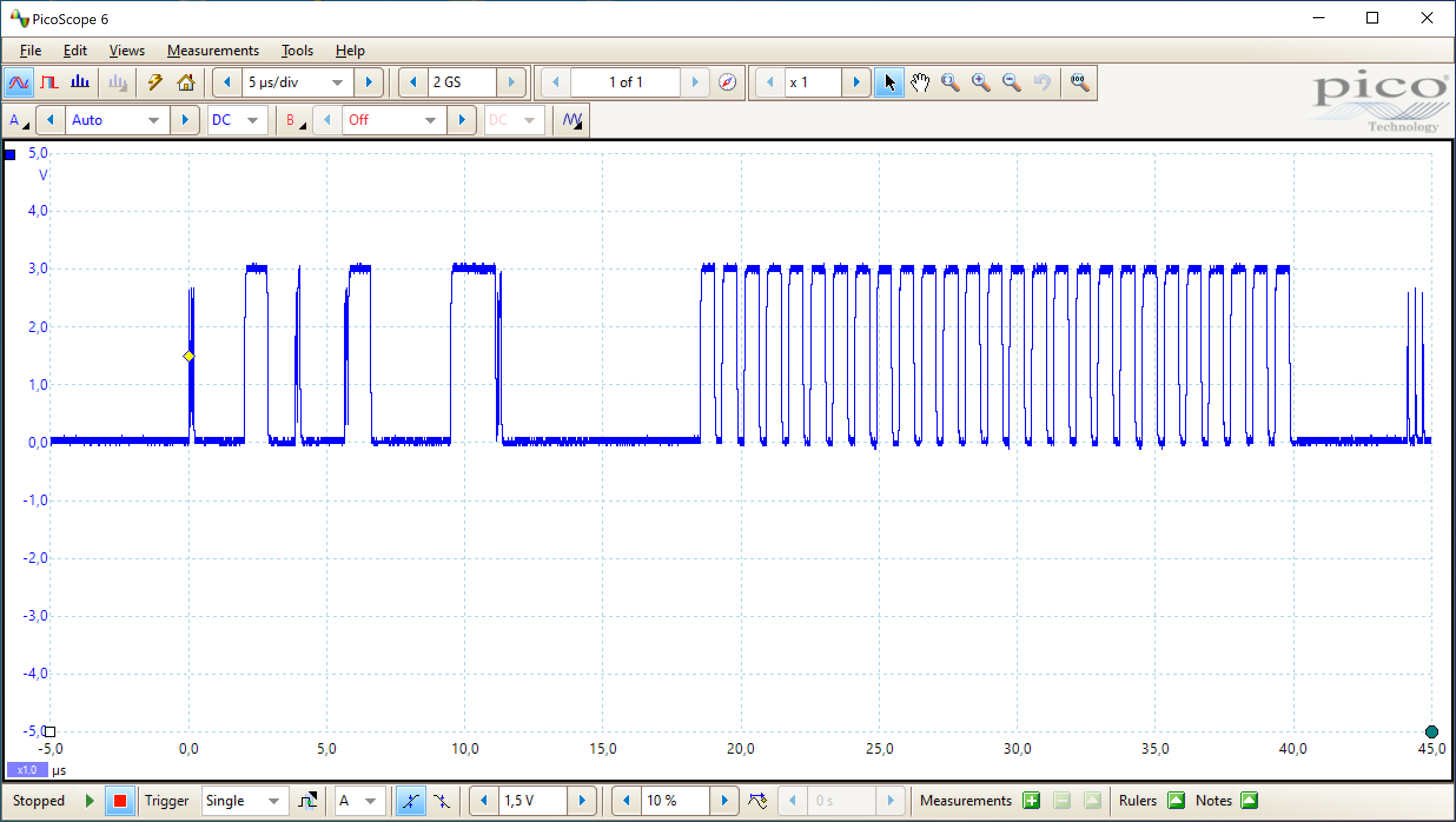

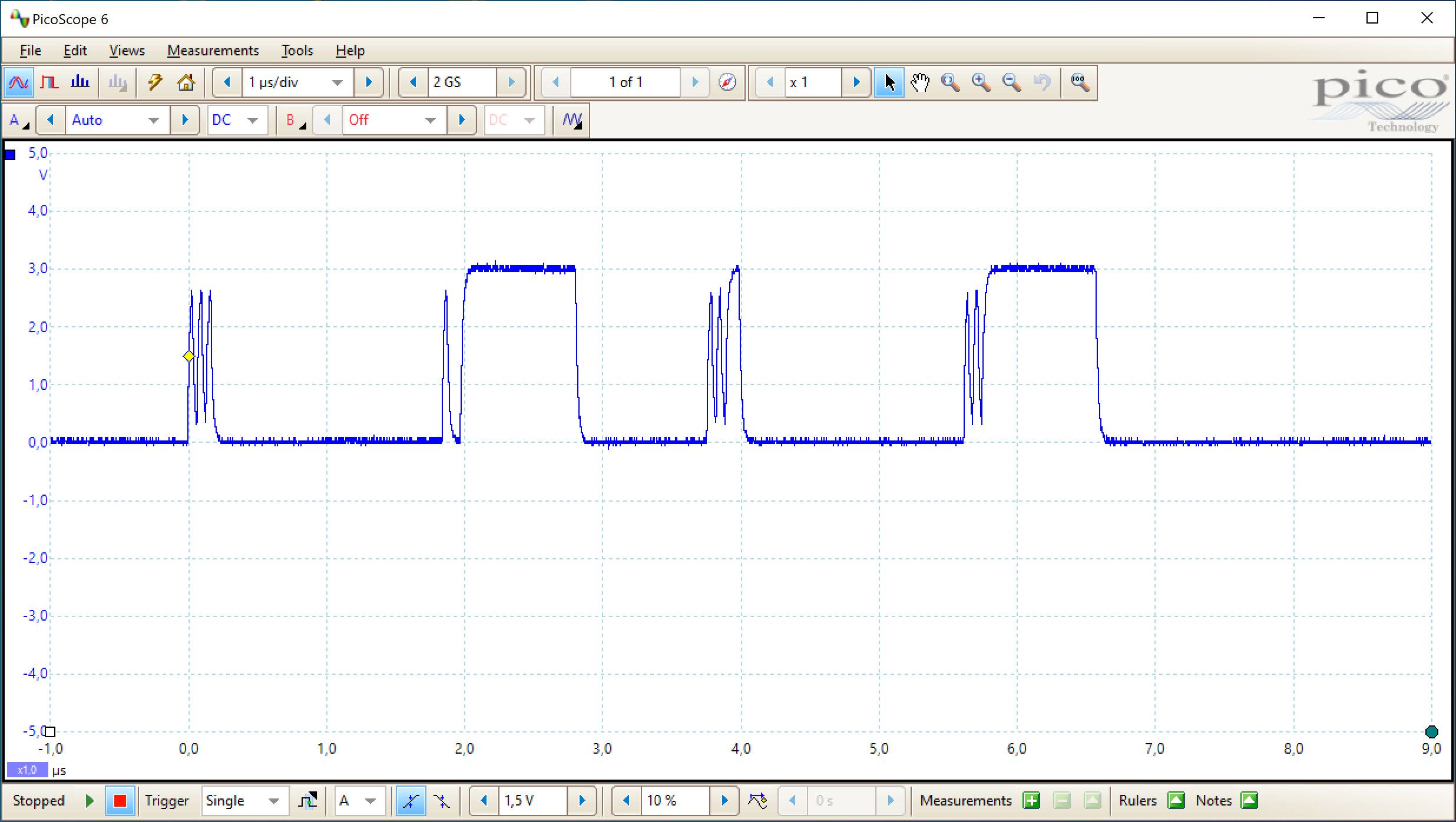

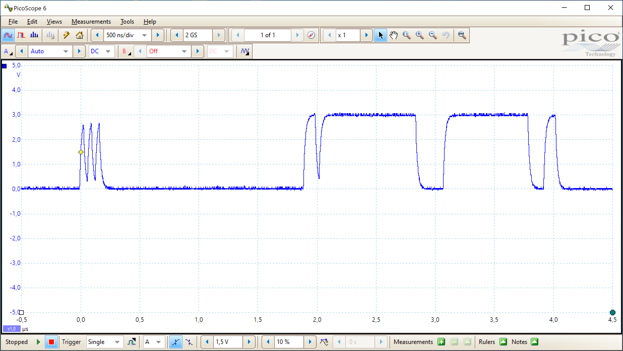

Today I tried to analyze the display interface (CONN303) to make sure, that only the display is broken:
* There's activity on the SCK pin (8), but the signal level is between ~1.5 and 3.0V, it doesn't go down to ground, is that correct ?
* There's activity on the SDI pin (9), that signal looks like the controller is sending data to the display. I've attached some screenshots
* My probes are probably to slow to measure the fast signals exactly
Can somebody help me please. I hope that only the display is broken.
