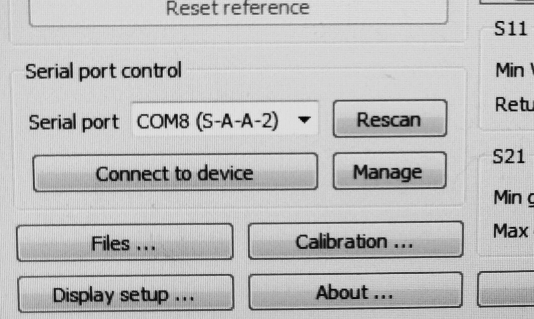

nanovna-saver does not see any Serial Ports - the selection dropdown is blank and hitting Rescan does nothing.  USB Serial Port Com5 is still showing in Device Manager
So - why does 'QT' see the Com Port and connect but 'saver' does not?
I know nanovna-saver is working because if I plug in my old NanoVNA-H, nanovna-saver sees the Serial Port (driver for that unit is STMicroelectronics and is using Com8 in my case) and connects no issues.

Thanks! Solution is confirmed for v2plus4. Win7 no SP1, nanovna-saver works fine with the 20210425, and does not see S-A-A-2 while device flashed by a stable 20201013. QT works well with both versions.
