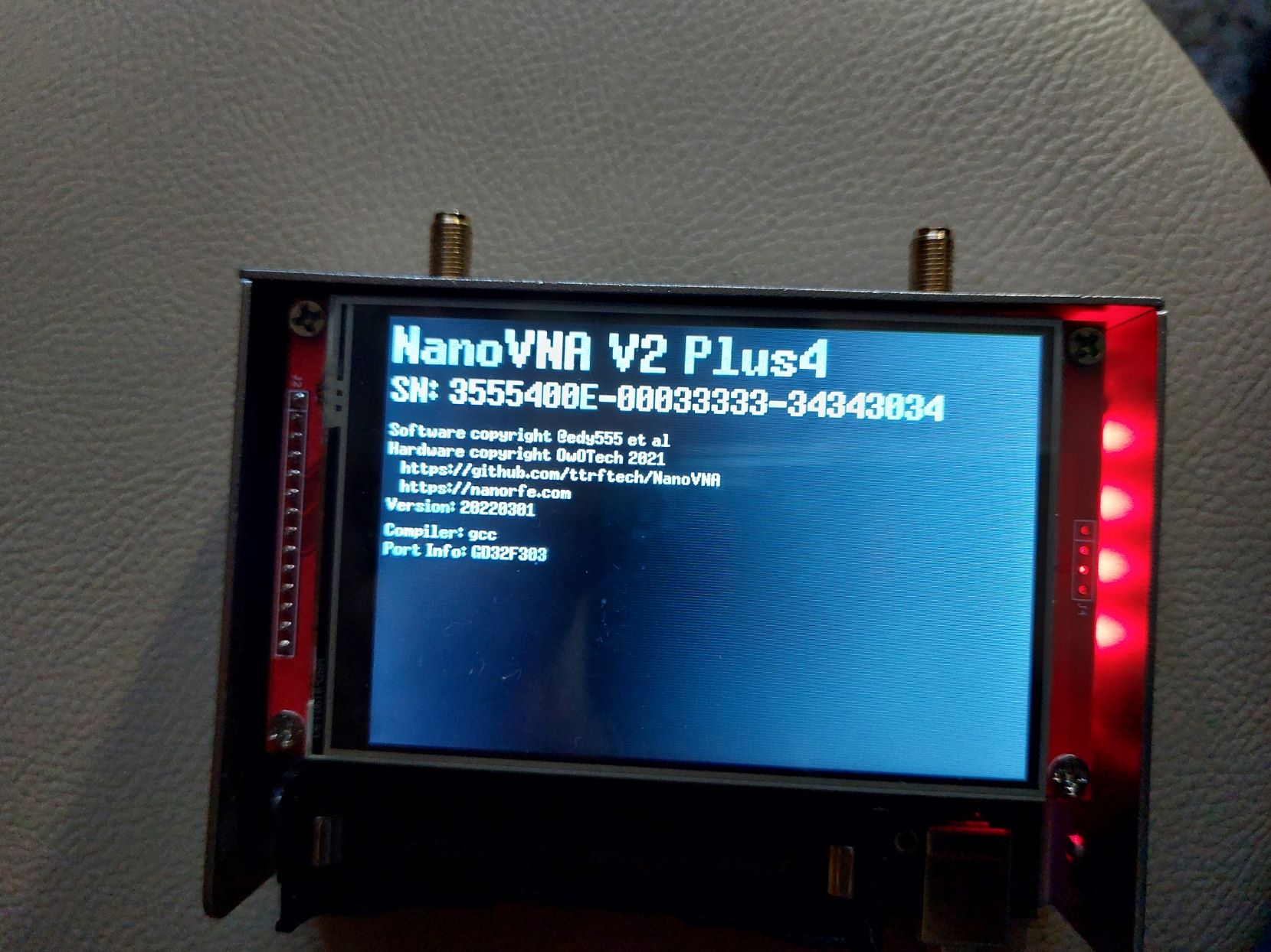

I purchased a NANOVNA V2 Plus 4 that works very well as a standalone instrument but I am unable to connect it to any PC (NanoVNA-QT, NanoVNA Saver and NanoVNA-App). From the attached files you can see my firmware version.

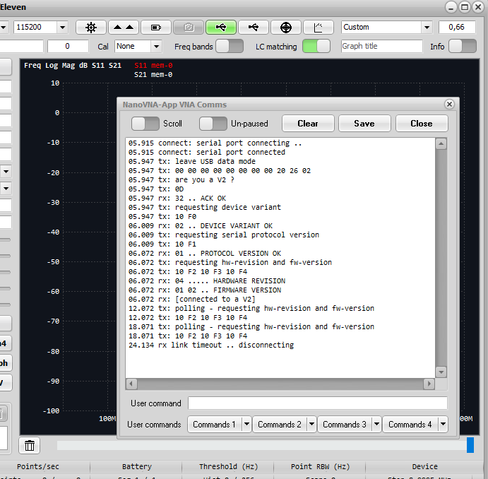

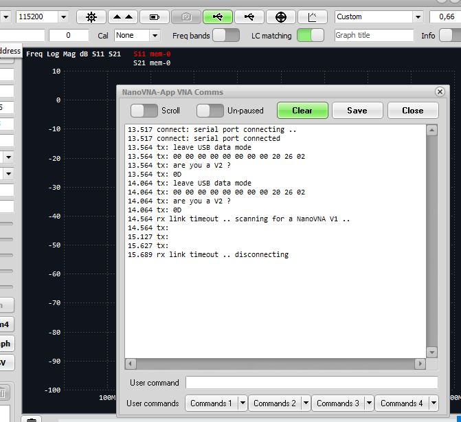

I have a Windows 10 PC and so I have downloaded and installed the Cypress drivers that are available in the official WEB site. When I connect the instrument to the USB port I can see the associated COM port (COM3) but when I run the NanoVNA-QT software it freezes. Using the NanoVNA-APP I can see the COM3 handshacking and I see that often the NanoVNA stops answering to requests coming through the Tx line (timeout on the Rx line - see attached screenshots).

My V2 Plus four screen reports exactly the same information and firmware version as your screen. I purchased it from the official store (Tindie) in China. Only the serial number differs from your screen, of course.

Thank you very much for your suggestions Siegfried. I use the NanoVNA App (the screenshots that I have attached to my original post are taken from the NanoVNA APP. Unfortunately, when I put the NanoVNA in boot mode I get the ""

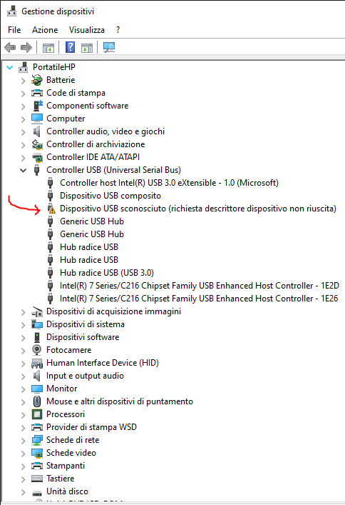

Hi Siegfried, thank you for your suggestions. Unfortunately, when I put my NanoVNA in upload mode the device is not recognized by Windows (Unknown USB device - device descriptor request failed - see attached screenshot) and so the NanoVNA App don't see the device and does not allow me to upload the latest available firmware. This behaviour is very frequent. Almost any time I connect the device to the PC I get the (unknown USB device error). Rarely the NanoVNA is recognized by the Windows system and, when this occurs I see the associated COM port (COM3) in device manager. So, when I set the device in upload mode, the COM port is changed and, as a result, the device is not recognized by Windows.

Thank you for your suggestions Dave, I uninstalled the Cypress drivers (or at least I think I did because I see that the Cypress files are still in the C:\Windows\System32\drivers folder after the uninstallation process). I have rebooted the PC and now I systematically get the "unknown USB device - device descriptor request failed error " when I connect the NanoVNA to my PC (before Cypress driver uninstallation I got this error frequently and rarely the device was recognized as a COM3 serial port). Windows is not installing alternate drivers for the "unknown" NanoVNA device.
