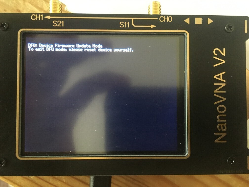

I bought an NanoVNA V2 clone from Amazon. Today I tired to connect my NanoVNA v2 to my computer running Ubuntu 20.04 LTS for firmware upgrade. But I did not find any ttyUSB* device even I have pushed the DFU button and applied.
"DFU: Device Firmware Update Mode
To exit DFU mode, please reset device yourselfs"

ol2tmx 2021/06/16 07:45
Hi guys,
by changing the contained usb cable and God-bless I am able to see the the tty-device:
