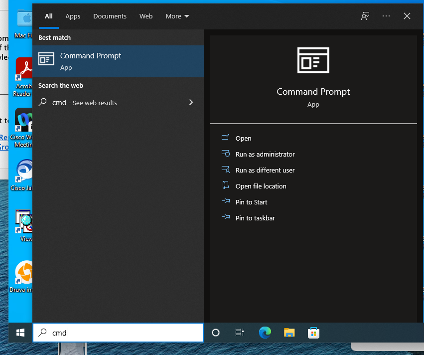

Jim Lux 2022/04/14 13:40
On 4/14/22 1:04 PM, PH7R - Ronald wrote:
> Thks Jim,
> I have downloaded v.0.4.0 from github. It is a exe file
> (NanoVNASaver.x64). If I start the exe file NanoVNA Saver opens but I
> do not see any option of the cmd line.
> Maybe it is mine lack of knowledge :-).
Windows command line.  Open the "windows" thing and enter cmd.
