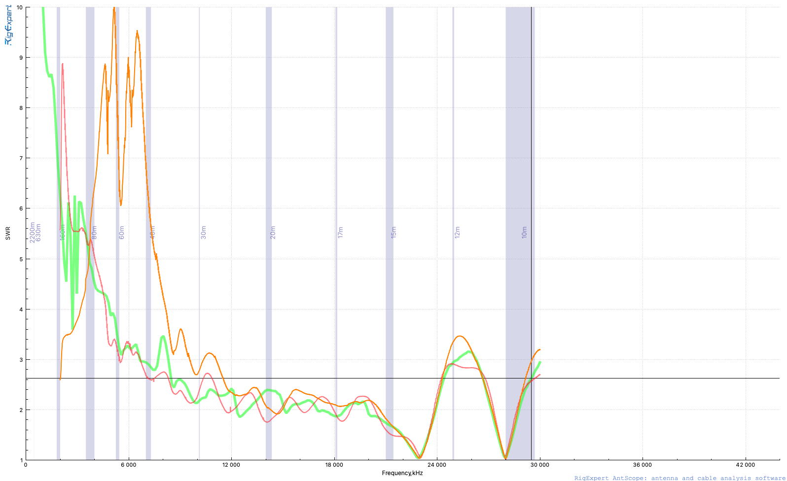

I just finished comparing my AURSINC nanovna-h against my new AURSINC NanoVNA SAA-2N V2.2 ( https://www.amazon.com/gp/product/B08G4GXTKK/ref=ppx_od_dt_b_asin_title_s00?ie=UTF8&psc=1 )
and found that the readings below 5 mhz appear to be invalid. I am testing against an antenna that is going thru
a UNUN 9:1.
Both a RiGExpert AA-230 and the nanovna-h appear to depict the SWR accurately but the SAA-2N shows an values of 10
and the others are showing 4.
Green = Rigexpert
Red =     nanovna-h
Orange = SAA-2N
It seems to start tracking a little closer once I get past 7 mhz
Any ideas. is the unit defective or having issues with the unun 9:1 where as the others arent ??

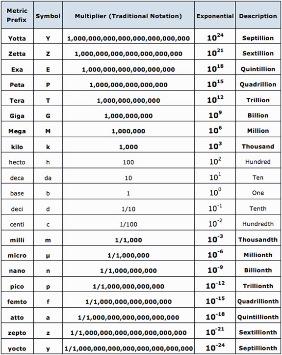

I would be very surprised if either responded to a 5 milli-hertz signal,
unless, you used the wrong prefix and meant 5 Mega-hertz.
Not understanding the prefixes, or improperly using them can lead to a
lot of confusion.

WA2TP 2023/01/18 10:37
Do you have any am or fm broadcast stations that are within 15 miles?
You could be overloading one of the units.
Perhaps the 2n doesn’t do as good of a job in the presence of strong RF

Once again:
M = Mega = 10^6
m = milli = 10^-6
Correct abbreviations are required in engineering and should be even in
amateur radio which is steeped in good engineering practices.

Ken Sejkora 2023/01/19 06:45
Absolutely correct, Dave. However, I’m not sure if someone who easily confuse a lower-case ‘m’ with an upper-case ‘M’ will understand the semi-scientific notation of 10^6 vs 10^-6. Easier to understand and less confusing by stating it as:
M = Mega = 1,000,000 = 10^6 = 1E+6
m = milli = 0.001 = 10^-3 = 1E-3
Also, your notation for milli as 10^-6 should be really 10^-3. Notation as 10^-6 would actually be micro, or 0.000001, which carries an abbreviation of lower-case ‘u’, or more correctly the lower-case Greek letter ‘Mu’. For example, 1 µ-meter = 1 micrometer = 0.000001 meter. This is also more commonly referred to as a micron.
One can ‘type’ a lower case Greek Mu (µ) by holding down the ALT-key and typing 230 on the numeric pad on the keyboard, or inserting the appropriate corresponding symbol from the Symbol font. Here are a few other useful ALT-numeric keypad notations:
Alt228 = Σ (summation)
Alt234 = Ω (ohms)
Alt236 = ∞ (infinity)
Alt241 = ± (plus/minus)
Alt242 = ≥ (greater than or equal to)
Alt243 = ≤ (less than or equal to)
Alt246 = ÷ (division sign)
Alt247 = ≈ (approximate)
Alt248 = ° (degrees)
Of course, I know you fully understand all of this Dave, but there are others out there in the discussion group that might not.
Have a great day.
Ken -- WBØOCV

Stephen Laurence 2023/01/19 03:49
Errrrrr...
Surely m is milli which is a thousandth as in millimetre, NOT one millionth (-is nano not a millionth?)
c is a hundredth as in centimetre
Please correct if I am wrong

Ken Sejkora 2023/01/19 07:54
Hi Stephen,
Certainly lower-case ‘m’ is milli, one-thousandth. One-millionth is ‘micro’. ‘Nano’ is one-billionth, or 0.000000001, or 10^-9 or 1E-9.
Standard engineering notation works in multiplier-increments of 1000. Here’s a table that lists the common, and some uncommon, abbreviations. Note that the non-standard abbreviations in the middle of the table which deviate from the 1000-rule are not listed in bold text:
Ken – WBØOCV

Dave Daniel 2023/01/19 08:03
Yes.
The correct SI prefix for 10^-6 is “micro”, symbolized by the Greek letter mu
(“μ”).
DaveD

j.zietlow 2023/01/19 07:52
Check again Dave, milli is 10^-3 😊
John K9WIC
Marc Nordquest 2023/01/19 11:01
m=milli, or one thousandth, or 10^-3
