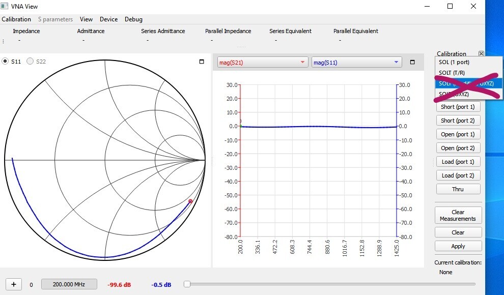

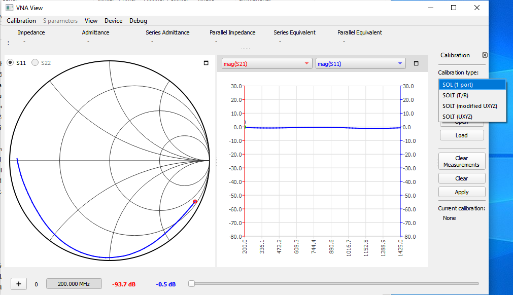

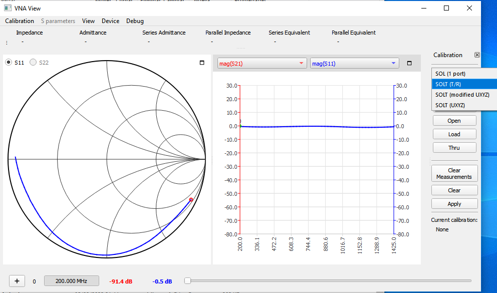

Francesco 2022/05/02 23:10
Hello on the Nano QT- only the SOL and the SOLT work for the calibration the
other don't work with the NanoVNA.
See attaches picture.

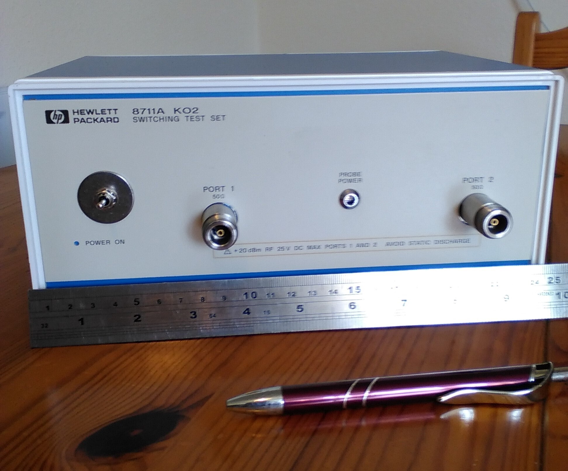

Yes I make one with 2 HP transfer relay the NanoVNA SSA v.2 is on the same
box, I use with the PC the use of 2 swich relay is better option, the HP on is
VNA use the two relay system for better isolation and less of cross talk for
the connection I use semi-rigid coax cable.
On the attacced file one test of one 1.2 Ghz filter with Joe Smith's
software.

Francesco 2022/05/04 18:02
The fig.6 is the relay system on my setup.
Best regards.
Francesco.

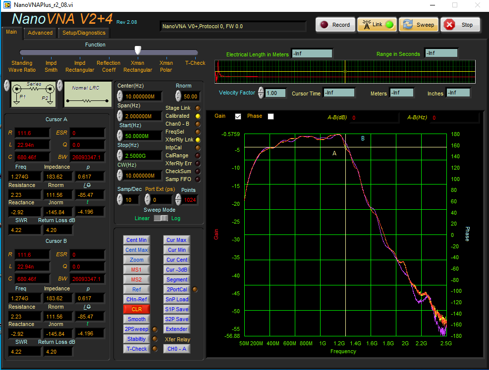

David Bradley 2022/05/05 09:42
Apologies if off subject ,but regarding NanoVNA 2 plus 4 attached picture of software where can I get the software ,also does it support windows 11,many thanks Dave 73 de 2E0DTB
Francesco 2022/05/05 11:54
Hello Dave, I suppose the new version work on Win11, **first** download LabViu
and install, restart the pc and **second daunload** the NanoVNA Solver64 .
**Please read the instruction on NanoVNA solver end watch the video before the
installation.**
Regards.

I suggest that you use caution:  Note that NanoVNASolver64 r3 is different from NanoVNAPlus_r2_08.  It is in development and not supported, no installer and no documentation.  However, it does work. It requires the 64 bit LabView runtime engine and compatible NI VISA but no need for the full LabView program (like Community edition).  The NanoVNAPlus is 32 bit LabView 2011 runtime and is recommended.   Joe Smith indicated that he has halted future development on Solver64 due to new licensing requirements from NI.  Note also there are two different branches for the 32 bit, one for the Plus 4 and one for the smaller hardware.
Francesco 2022/05/05 21:46
yes I use the 32bit and the 64bit the NanoVNA Solver 32 is on the pipiline for
the licence problem
**Sent:** Thursday, May 05, 2022 at 3:08 PM
**From:** "Bob W0EG" <morrisnc7@gmail.com>
**To:** NanoVNAV2@groups.io
**Subject:** Re: [nanovnav2] NanoVNA-QT - Crashes upon applying calibration
hardware.

Francesco I'm referring to this software in the picture below just too clarify ,thanks for your reply 👌Dave
Bob W0EG 2022/05/05 15:58
David,  The software Francesso is showing in his photo is for the NanaVNA V2 Plus4. Is that the instrument that you have?  Francesco has built it into a very nice instrument using an HP enclosure and relays to make a true two port full S parameter analyzer. I assume that Francesco is using the Joe Smith software because it supports the transfer switch relays.  Unless you intent to add a transfer switch you probably don't need that software (but the GUI is slick).  The open source software VNA_qt will likely meet your immediate needs. Joe Smith would probably discourage you from using it unless you are specific needs or are an experienced VNAuser.   If you want to try installing it, just follow the instructions I posted previously.
David Bradley 2022/05/06 09:09
Thanks for replies Fransesco and Bob and others input ,I think I'll wait ,I do ok with my antennas using Nano-Qt software , 73 Dave
