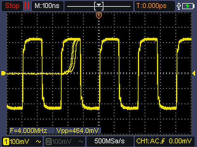

New Nano VNA V2 Plus4 Pro user. I have noticed a couple of issues with my new unit.
First, I can't change the output level. The ADF4350 TX Power menu does not work. Output is the same for all 4 levels (0-3).
Second, The image below shows the output set to 4 MHz with CW Freq. It shows noise on the output. My other Nano VNA does not have this noise.
nanov2support 2023/12/01 07:45
Hi, the ADF4350 TX power affects only frequencies above 140MHz, can you check the sweep frequency setting?
The discontinuous output signal is normal and due to the V2 architecture, as it switches the output signal rapidly to make measurements with low drift, so we advise that V2 series can not be used as a signal generator.
