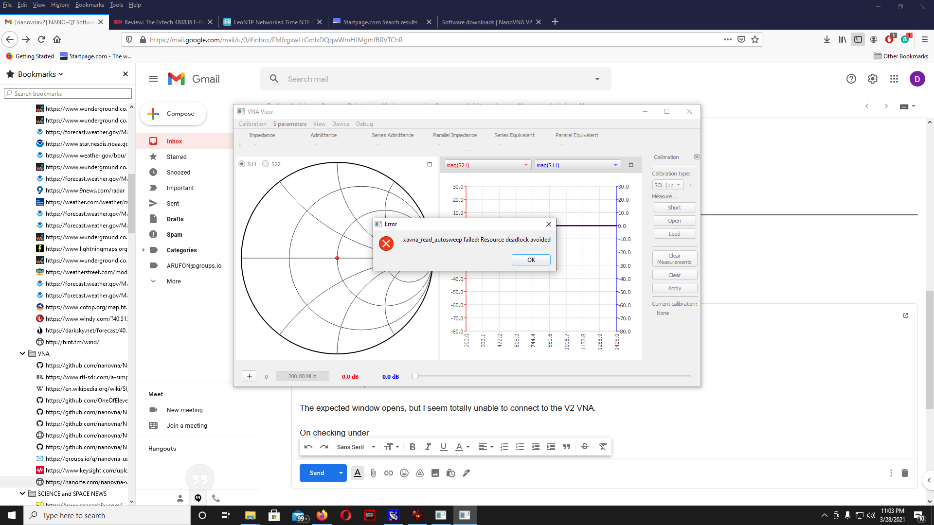

David Eckhardt 2021/03/28 23:07
I downloaded from the URL:https://nanorfe.com/nanovna-v2-software.html
First: the Crypress drives and installed in Program Files (86)
Second: vna_qt.exe (for Windows) and installed in Program Files
(86)
then launch vna-qt.exe
The expected window opens, but I seem totally unable to connect to the V2
VNA.
On checking under DEVICE: and //./COM1 or under "OTHER" within
DEVICE and input //./COM4 I receive the following error message:
which reads:
How do I connect to this V2 device.

Siegfried Jackstien 2021/03/28 23:27
set avg to none in the device and save in slot 0
then it should work
nanovna safer ... and vna qt ... do not work if avg is NOT set to none
soft asks for 100 points but gets 50 back(with avg x2) or only 20 (with
avg set to x5) ... so you need to switch average off in the device when
using with pc (inside the pc soft you then can add averaging to have
smoother curves)

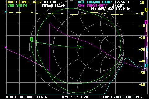

i have THREE different nanov2 ... v2 modded with 4 inch, v2plus with 4
inch (modded saa2n) and a plus4
ALL THREE work with THREE pc software (vna qt, nanovna safer and
nanovna_app)
i prefer last one (nanovna app) cause its the most comfordable soft in
my view and also does fw update like the qt software does
plus it can do screenshots from the devices screen (see picture)
also nice is that this last one ... works with or without setting avg to
none in the device (only scan speed lowers when using avg x2, x5,
whatever) ...

>> 100 points .. it gets only 20 points back and stops with a timeout error
>> nanovna app does not care about avg setting IN the device (only scanning
>> then is slower) ...
>> so for the first two soft you have to set AVG to none .. and save that in
>> calibration slot 0 (cause that is default when switch on)
>> good luck dave ... and feel free to ask if you still have problems
>> greetz sigi dg9bfc

Alan Scott 2021/03/28 23:32
Take a picture of your V2 VNA.
If you require any further information, do not hesitate to contact me.
With thanks
-Alan Scott
