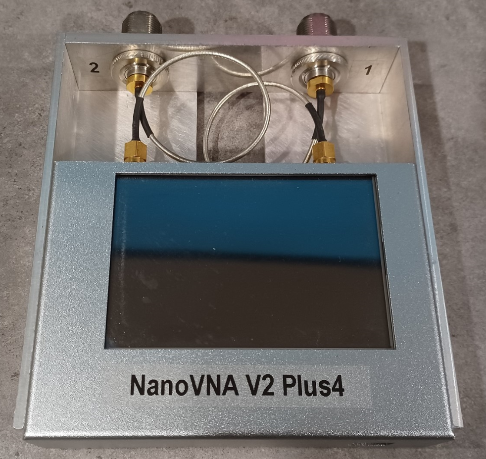

n4ua 2024/03/13 06:04
Most of my work does not mandate SMA connectors and my good cal kit is N,
so I used some scrap aluminum and bulkhead adapters to "ruggedize" my Plus4.
geo - n4ua

Rob Rowlands NZ6J 2024/03/13 09:51
Nice job Geo,
That certainly addresses the major physical issue! Do you feel the VNA cal
capability is completely backing out the effects of the adapters and jumpers -
the length is enough to show on a TDR?

n4ua 2024/03/14 06:56
Rob,
The VNA is absolutely capable of removing the added cable length and
bulkhead adapters. You can cal out at the end of a 100' cable run if you
have access to it, like a run up a tower. You might need some help swapping
the cal kit bits...;-)
geo - n4ua
