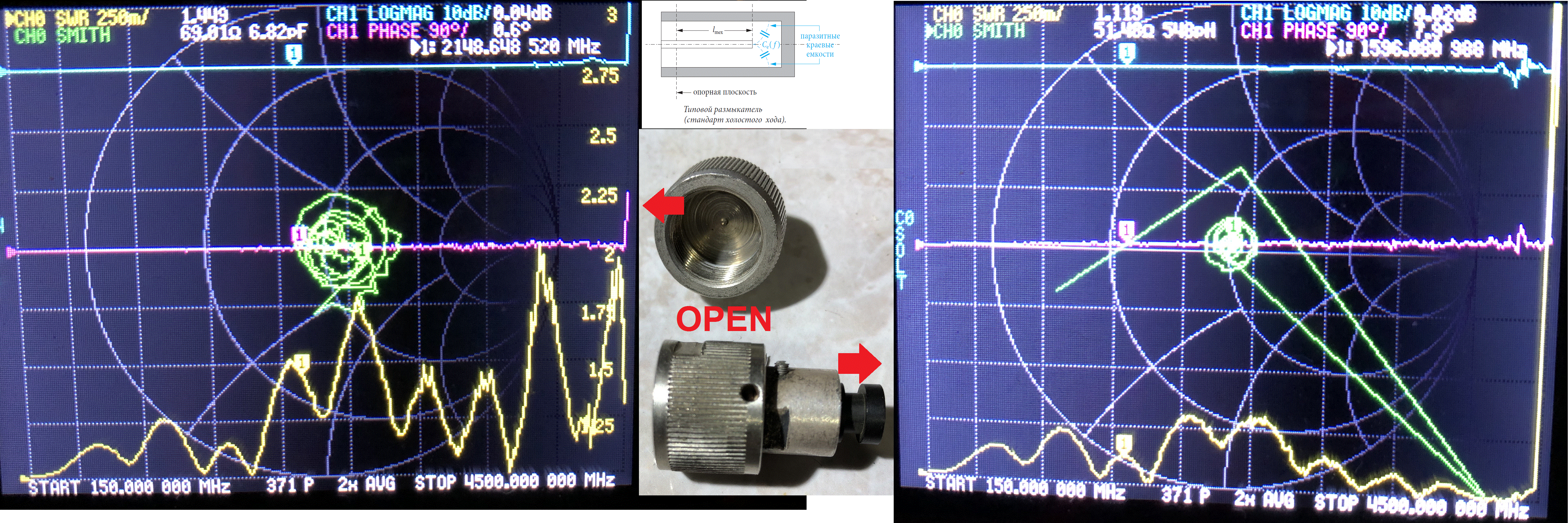

My test with a different standard OPEN.
Aleksander Shalygin 2021/04/10 09:52
David Eckhardt 2021/04/10 18:07
That grouping in the center is pretty spread. You should be able to get
almost a dot in the center, once calibrated, with the 50-ohm load on Ch 00,
the source port.
On Sat, Apr 10, 2021 at 4:52 PM Aleksander Shalygin <shalygin@ukr.net>
*Just Let Darwin Work*
Lance Mitrex 2021/04/10 14:20
Something is incorrect with the 0 ohm. (short). this is displaying as a <
not very good> 50 ohm load. On a Smith Chart, the center of the arcs is 50
ohm. Please turn off the other 3 traces, because the screen is to busy : 1
SWR 3 LOG MAG 4 PHASE. To CAL, only use one trace set to Smith. Then, it
should be less confusing.
Q: are these the CAL elements that came with the nanoVNA? Or are these
Home-Made DIY CAL elements?
On Sat, Apr 10, 2021, 12:52 Aleksander Shalygin <shalygin@ukr.net> wrote:

Stephen Laurence 2021/04/13 08:08
I was testing a sma terminator rated to 18ghz (hoping it might be a good cal standard at least up to 4ghz) on my v2N, via a N to sma adapter. The screen was behaving strangely, and also with other sma cal standards too.
It turned out that the N to sma adapter had a short within it, and not a very good one at that.
You cannot necessarily trust anything.
Steve L
