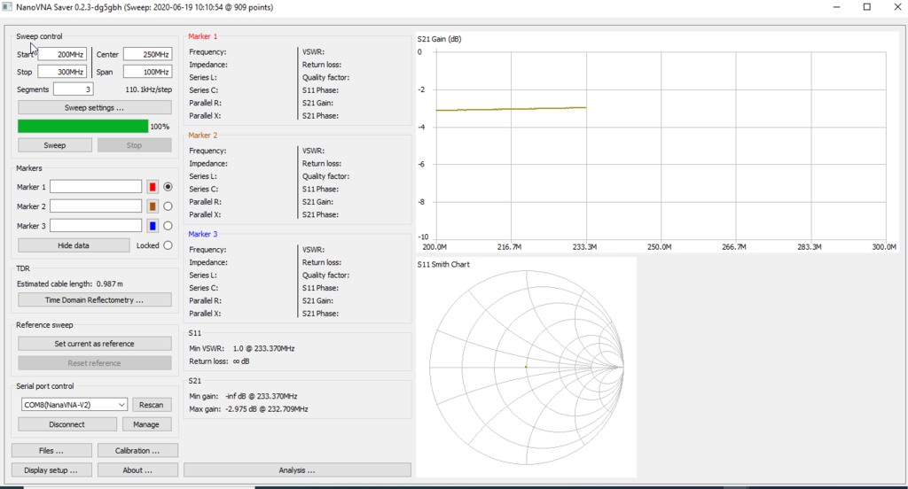

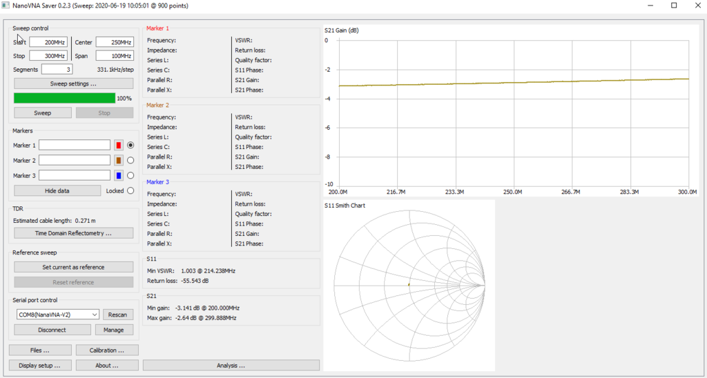

hwalker 2020/06/19 08:20
On Fri, Jun 19, 2020 at 04:20 AM, MarkZ wrote:
I've built a new nanovna-saver.exe from Holger's repository. He has done a huge amount of rework so I can't speak to all of the changes or possible new
issues, but for sure it now remembers where markers are (phew) and it connects more reliably to the comm port at startup.
Mark,
Your previous 6_12 Beta exe runs on my Win10 x64 sytem, but the new 6_19 exe is only showing a third of the completed s21 sweep (see attachments).
- Herb
MarkZ 2020/06/19 09:28
Hi Herb,
That looks like the vna-qt interference issue but that's been fixed for a while so I don't know what that could be. I can't replicate it. Can you maybe walk through the steps? The units seem to have some USB connection issues so maybe just try rerunning the program?
If you run the program from a command prompt with a -d suffix it will print debugging information into the console. Maybe try that and see what it says. If you copy that into a text file and attach to a message I'll take a look at it for you.
Mark

Holger Müller 2020/06/19 20:00
On 19.06.20 18:40, MarkZ wrote:
> Hmmm, it does look like he's added 'customizable data points' to the
> feature set to let you pick sweep length somehow. I have no idea if
> that's implemented but it's defaulting to 1024 data points, which
> imho is more than I need and runs a little slower.
It should be defaulting to 303 data points. Running nanovna-saver
in debug mode dumps dp selection to console.
The number of data points per scan are selectable if you click on
the "manage"-button beside the device selection. Next sweep
should use the new selected setting then.
If segments are selected in the sweep section, they should be scanned
successively. So as in Herb's screenshot the curves should be appear
in thirds of the range.
But I'll take a look what happens, if that is not the case.
Holger

MarkZ 2020/06/19 12:30
Ah, I didn’t see the 3 segments choice. I never use more than 1. It’s very likely that imho.
Mark
hwalker 2020/06/19 15:09
Mark,
Yes, with 1 segment chosen there is no problem. I didn't realize Holger added an option for selecting multiple points which makes multiple segments less usefu -at least on the V2. Not sure how the other NanoVNA's react.
- Herb

MarkZ 2020/06/20 05:04
Hi Herb,
Sure enough the multi-segment isn't working with that build. I've updated my _6_19.exe build to have the fix in it and submitted a pull to Holger (that he may want to do a different way).
Mark
