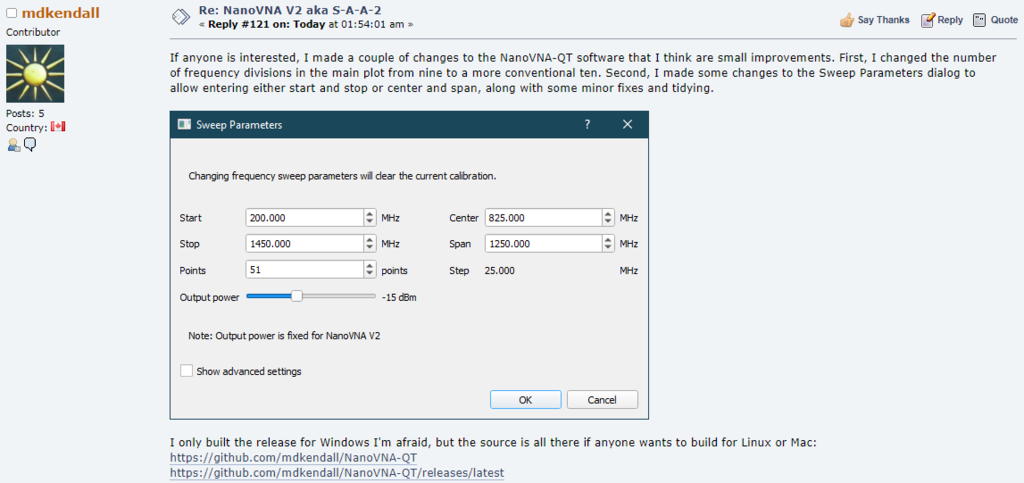

The attached was posted on www.eevblog.com .
The attachment announces an unofficial release of NanoVNA-QT from the mdkendall branch at https://github.com/mdkendall/NanoVNA-QT/releases/tag/20200723 .
Release Notes:
- Main chart frequency axis has ten divisions (was unconventional nine)
- Improvements to Sweep Parameters dialog:
- Fix error in displayed frequency step
- More convenient default number of points
- Allow setting start/stop or center/span frequencies
- Show frequencies to 1kHz resolution (remove spurious decimal places)
- Disable inapplicable output power setting
- Fix problems with building for Windows
The release is only for Windows, but the source is all there for anyone wants to build for Linux or Mac.

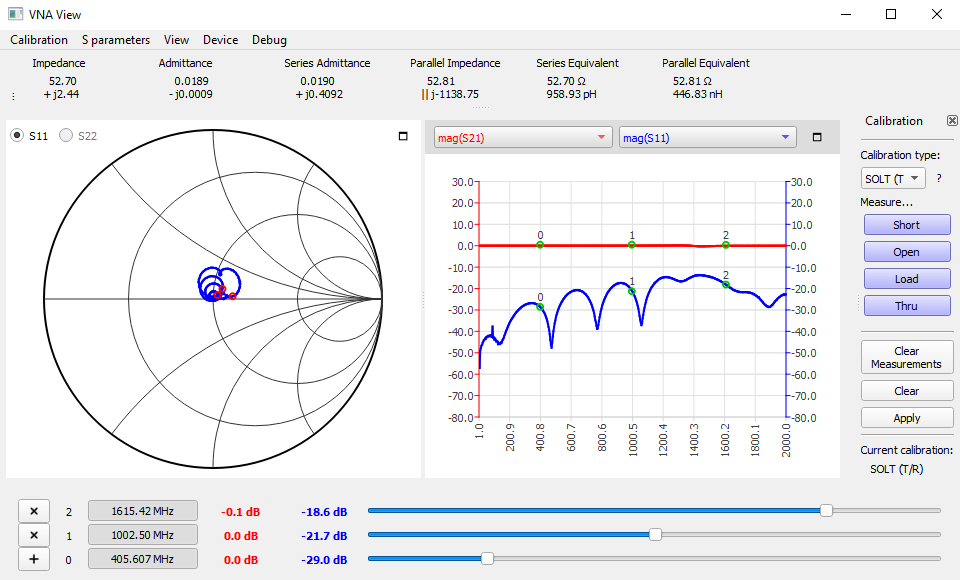

Using the "original" one I can see and move marker 0 [zero] and 1, on this
release I can't see it. Could you please confirm it? Or is it only on my
side?

I see both marker 0 and 1 with data. However it took some time to get Windows Defender to give up and let me run the application. There was many files which was regarding as "dangerous"

I just tried adding 3 markers and placing them. Like Kurt, I had no issues moving or seeing the markers.
I appreciate the option of using start and stop frequency, or center frequency and span. Since the power level is not settable on the V2, disabling that setting is helpful to new users - probably should have just eliminated that setting unless a future enhancement is planned.
Kendall's changes are all cosmetic as far as I have observed. His contribution is appreciated.
If you continue to experience marker issues you should post an issue report at Kendall's GitHub.
- Herb

I had to run the vna-QT twice then I got the 0 and 1 markers available.
Maybe a glitch on my side.
Indeed cosmetical, but welcome changes.
